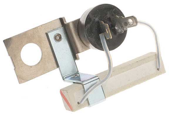

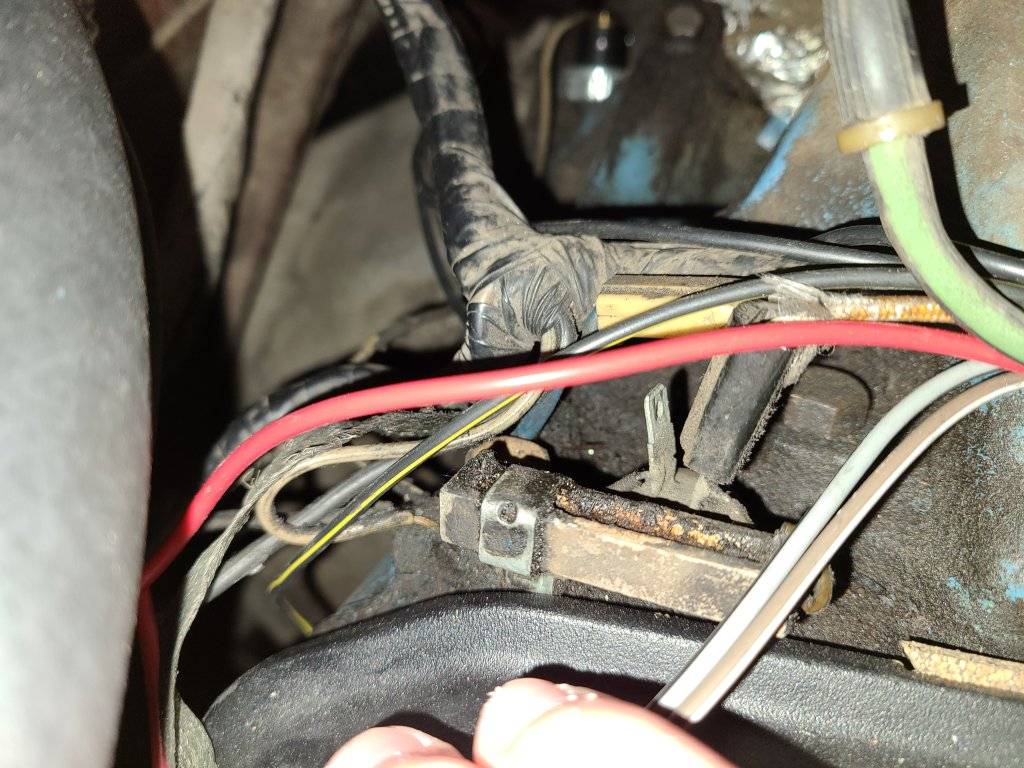

I doubt this is related, but there is a wire that runs into a white strip (kinda looks like a resister) which goes to another wire to the choke heater. I unplugged it as the White strip was smoking, and the choke still opens normally. I have uet to plug it back in, trying to learn more about what that resistor strip is
Get an ohmmeter, check the resistance of the white strip, note the size of the wire feeding it, and try to identify the white strip from a parts catalog or the FSM. Take a pic of this mysterious white strip, and post it, so WE can see it, and likely somebody will ID it for you. Once you know what its supposed to be, you can ascertain whether it's functioning properly, A smoking resistor isn't necessarily a bad thing, but you need to KNOW what that thing is for, and all the specification data available about it.

Stick with the electronic ignition, it is a very reliable simple system. The smoke from ballast resistor will happen when new, but only then unless you have greasy hands on it.

Pulled #1 plug this morning, very nice burn, and not too much carbon. It started up nicely, but had to shut it off cause that choke relay started smoking really bad agin. New one of those on the way
