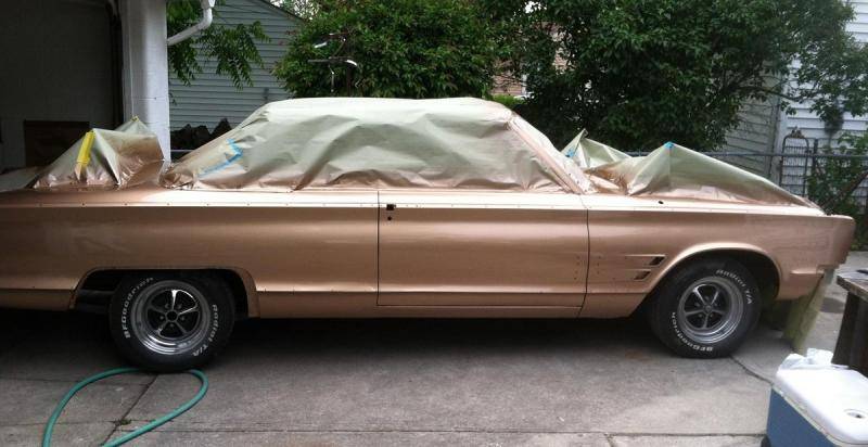

I've had one of those crazy weekends, and can't seem to get anything done. No new updates on the car. I just sent him a text to see how it is going. To be honest I was so happy with what I saw last weekend that I don't want to push him to finish, thinking he might hurry on something and make a mistake. He has been working on it every weekend since he got it, so he has not taken a weekend off. I can't ask for any more than that, but it still makes me anxious to get her back.

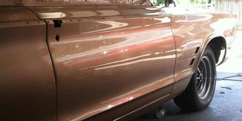

She is painted! She still needs to be buffed out and reassembled. Here are a couple of photos:os_dancing2: painted2.sm.jpgPainted.sm.jpg
Thanks everyone I'm hoping he might be able to deliver some evening next week as opposed to the weekend. I am working on my rental property next week and it is on the family farm where my shop is located. It would be nice to finish for the day on the rental and then go work a couple hours on the 300. Sorry I need to dance so more.:os_dancing2:
Beautiful! That car is going to be a stunner!
