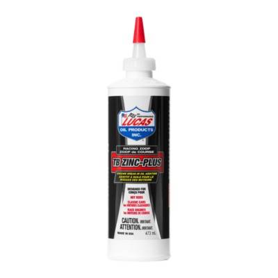

I use Lucas "TB Zinc Plus", available at Napa. Similar to your additive, a quarter of the bottle provides adequate zinc for one oil change.
