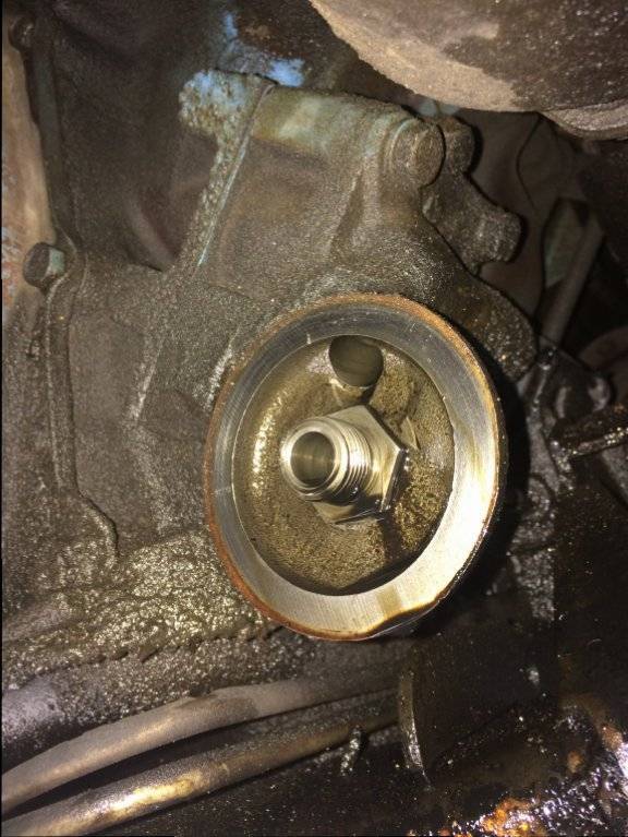

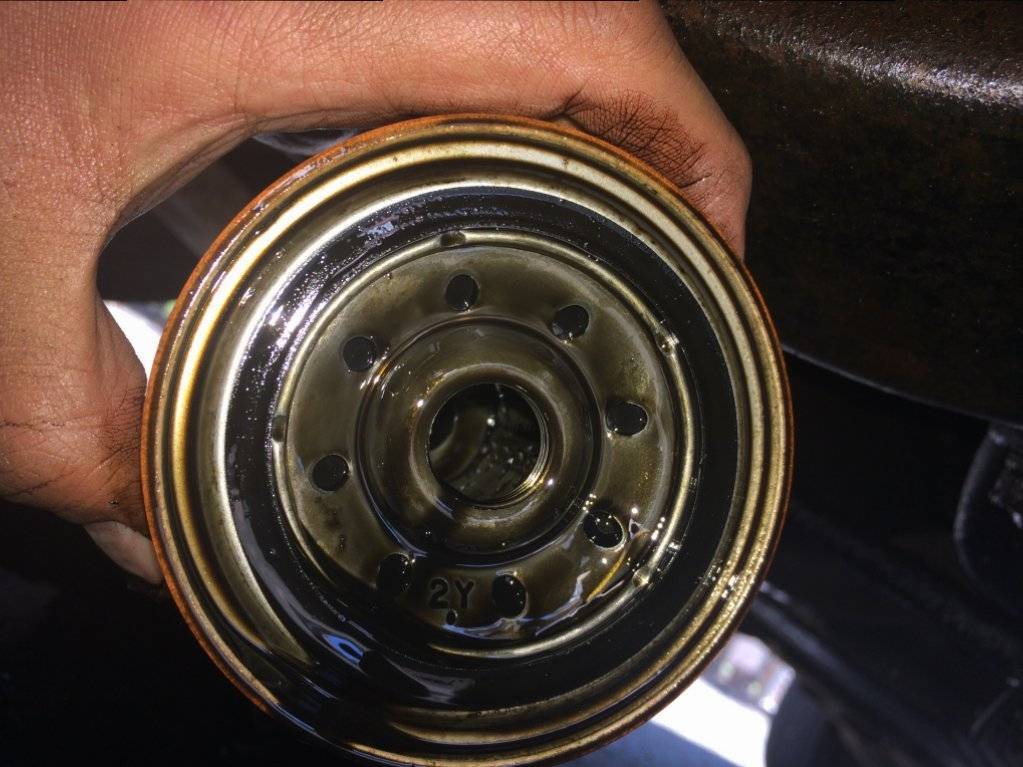

Oh wow! I just checked my oil and I'm over two quarts low! I topped it off but it's bleeding out pretty heavily from or around the oil filter. I'm hoping it's just a bad filter. Anything else it could possibly be? It looked to be pooling and dripping right off the filter.
Most likely a bad filter, check to see if it is on tight. If it is, replace the filter Fram PH8A or equivalent. You will need to add 1 quart of oil if you change the filter. If you had the car serviced at a shop, do not go back!
I'd say clean off the filter and the pump, top it off, tank the sender unit and check your pressure with a hand held unit while figuring out there the leak is coming from. If it's coming from the mating surface between the filter and the filter mount on the pump, it's likely the filter. If it's coming from anywhere else around the pump, you'll need to rebuild or replace the pump.
Judging by your intermittent oil light, I'm kinda leaning towards the pump especially if you note no seepage from the sender unit.
At any rate, it's a good time to go through your entire oiling system. It's the last thing you want to fail.
Good luck man!
