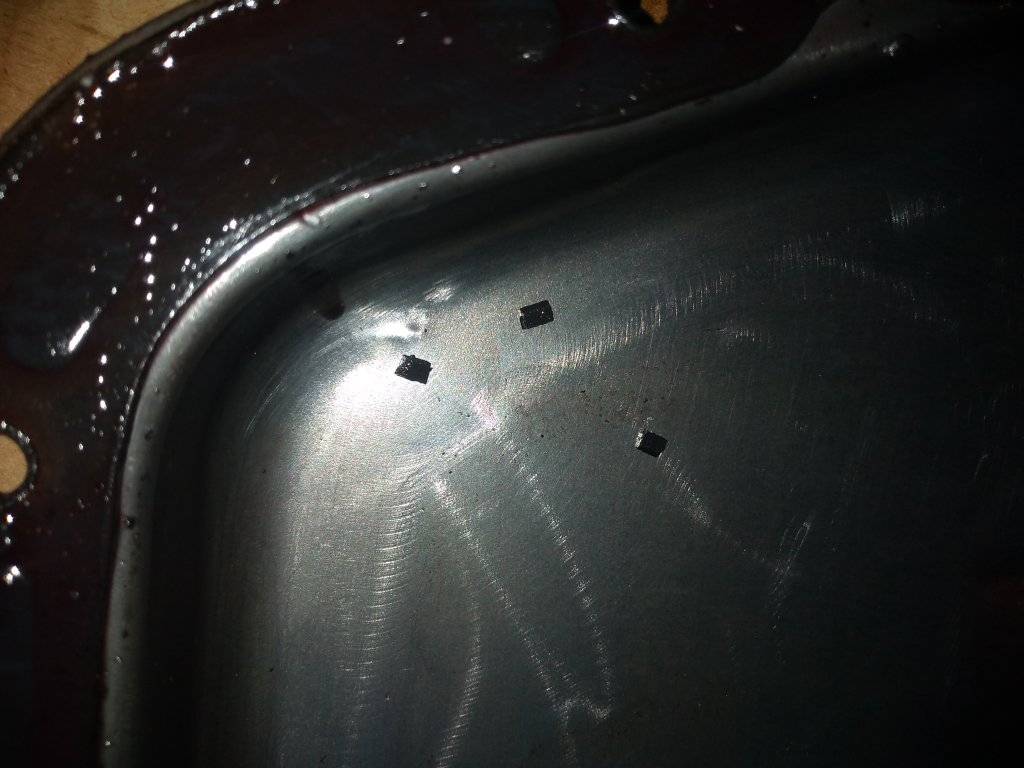

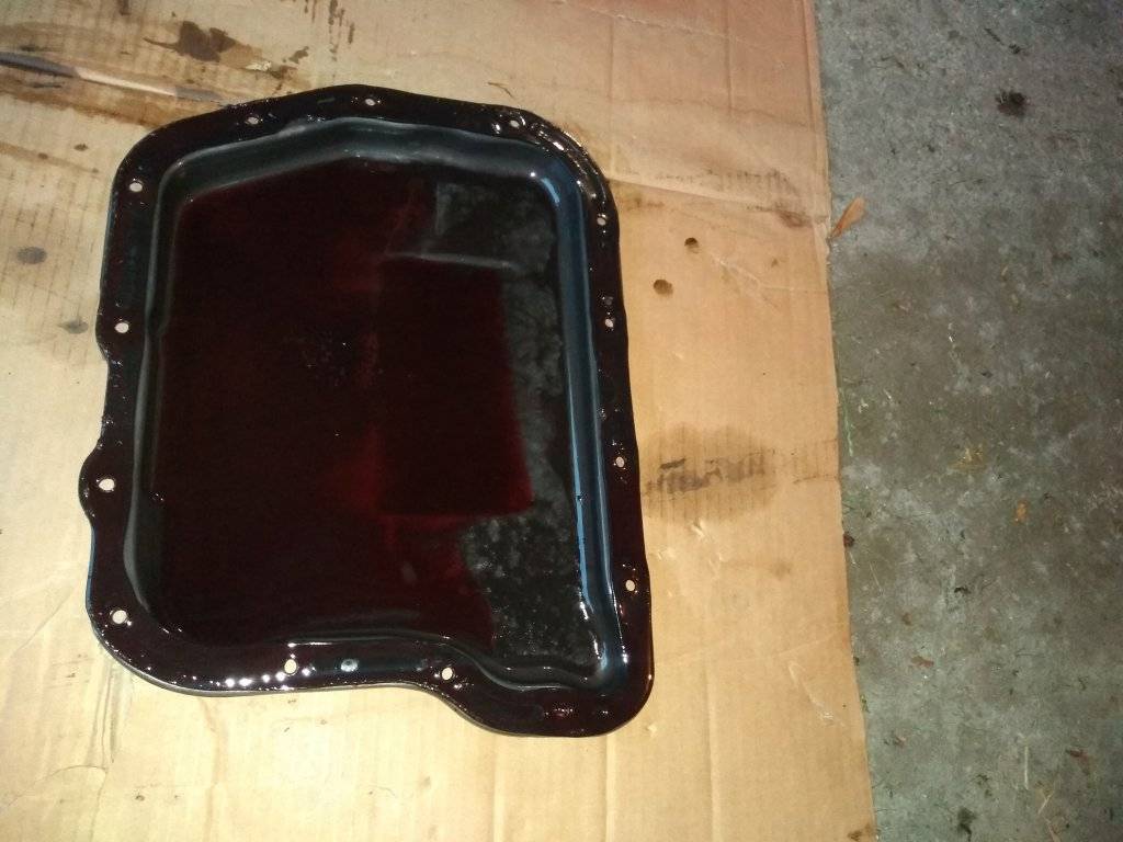

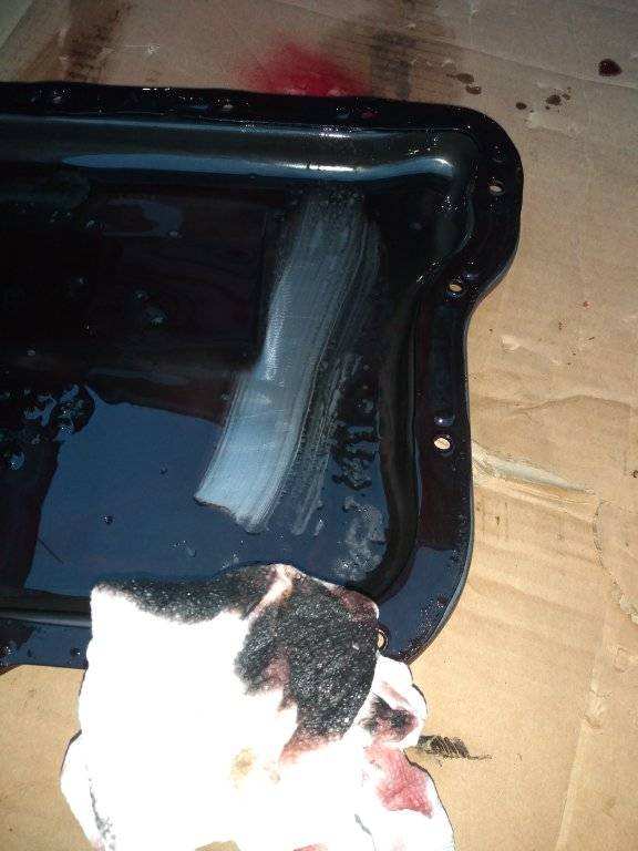

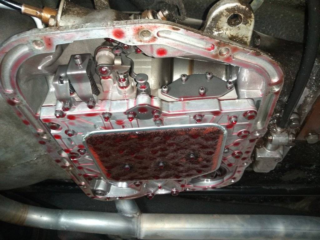

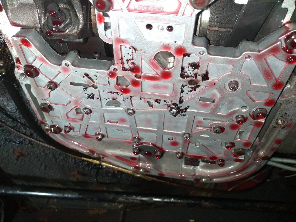

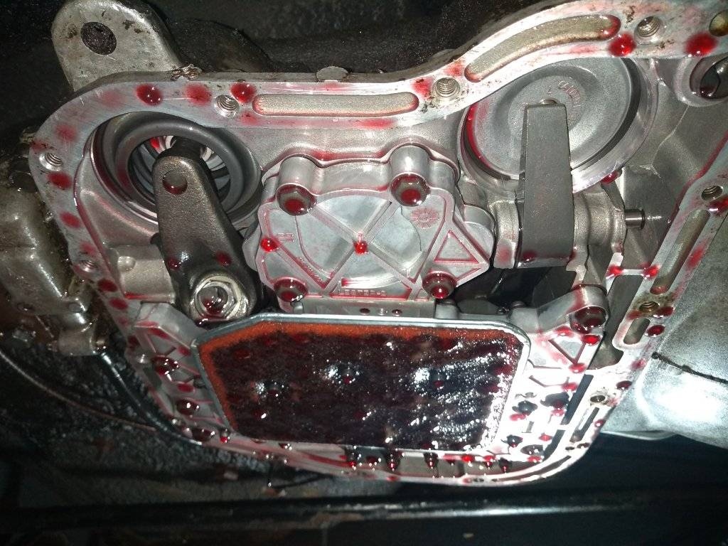

Pulled the pan tonight. The fluid looked good, but as I said before, most of it was new this year and has less than 100 miles on it. The filter & the bottom of the pan tell a different story.

Transmission is out of the car. I didn't drop anything on my head, and I don't think I broke anything!
Just want to give a shout out to MONC440, who spent all day today going through my transmission. It will be a few days before I can get everything back in the car, but if it works as good as it looks I will be very happy.
