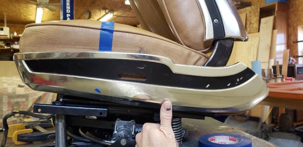

It looks like from the mounting point of the joy stick, the location is not in the painted area, unless they changed the panel for the power seat. It should be approximately where the blue tape is located on the panel.
After some searching I found a good picture of the panel. It looks like my general placement of the joy stick is correct and I should be able to pull off a conversion of my manual panel.
The good thing is the manual slot is in the black field which needs repainted anyway, so a little patch and paint and I should be in business.

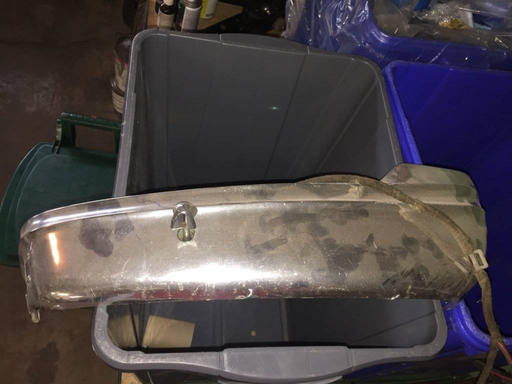

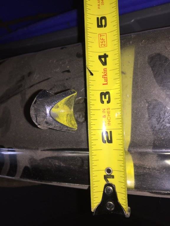

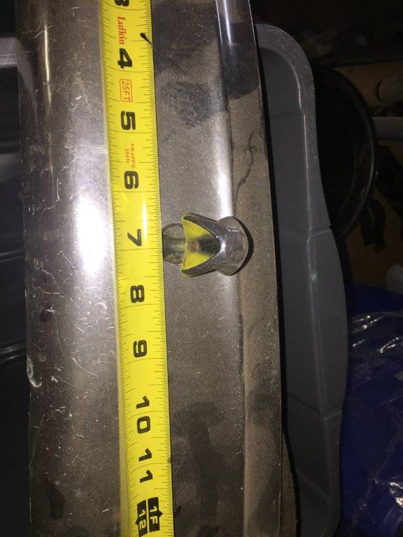

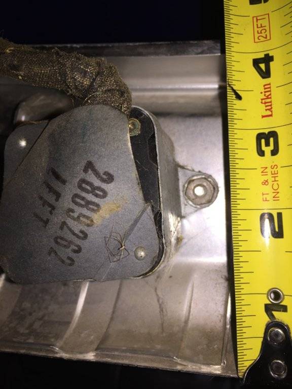

I got out the parts holding area in the garage and pulled out my power bench system

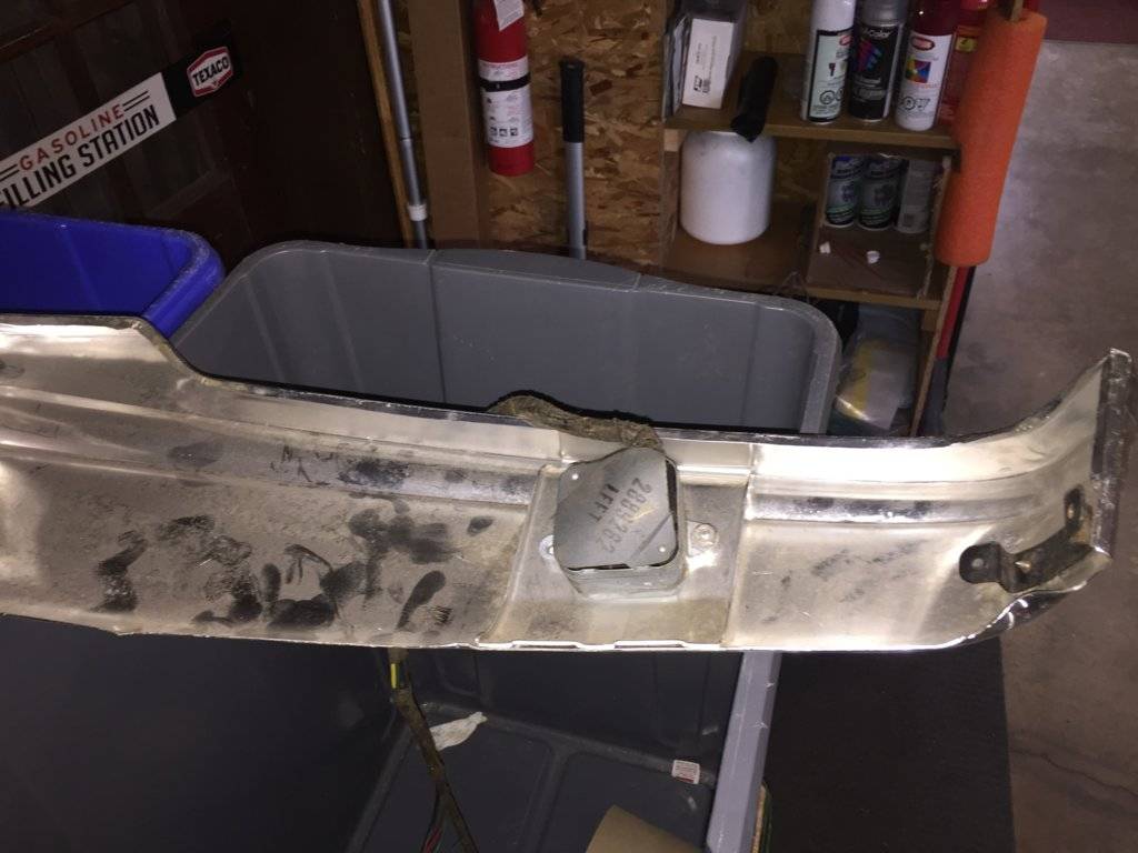

Here is my side trim and control

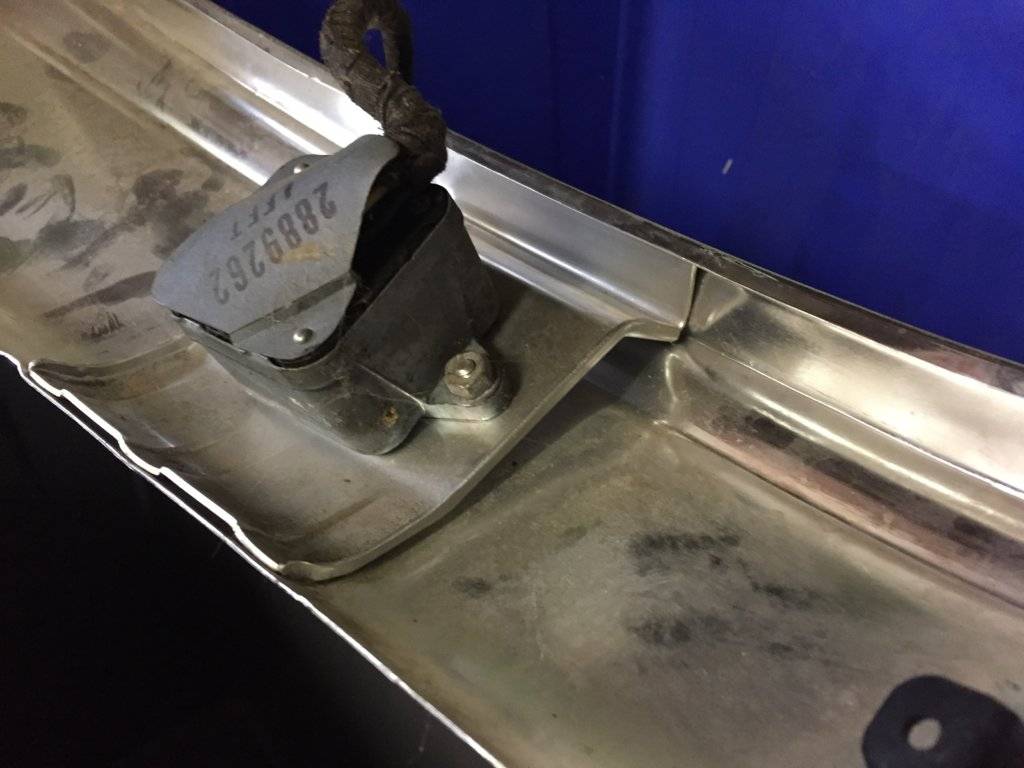

Here are a few more photos.

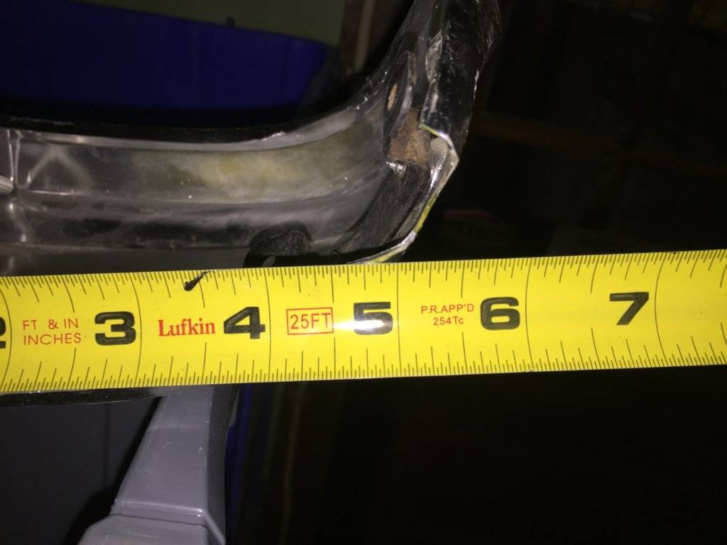

If you can imagine taking a measurement from the very front of the aluminum trim to the location of the hole horizontally it measures very close to 10" and has a very close to 2 1/2" from the top of the trim.
Take note of the mounting bracket on the back side as well.
I saw it was different but hopefully the location of the controller is the same?

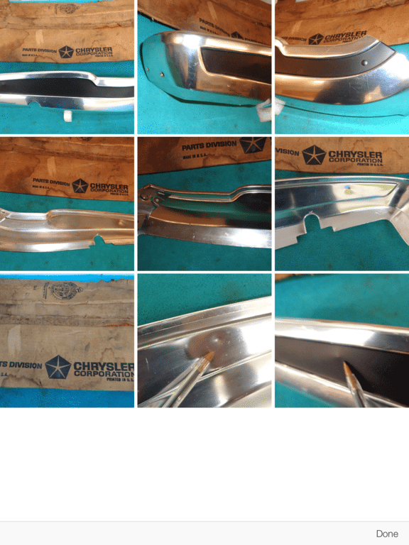

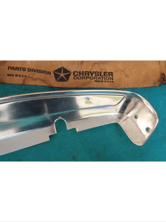

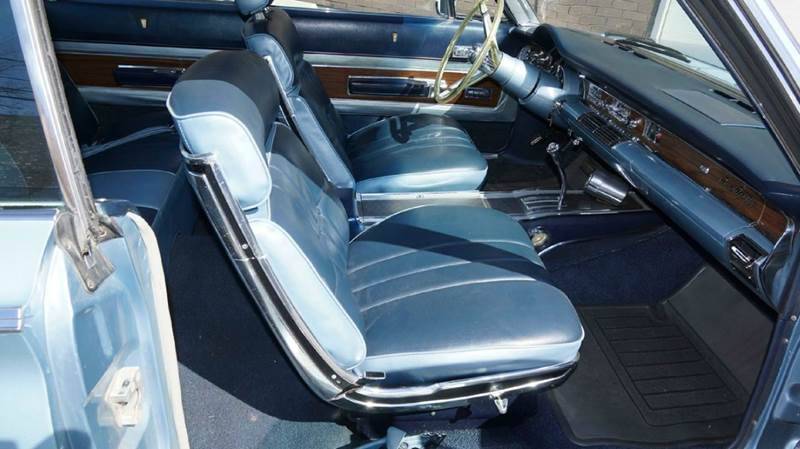

Tom, thanks for taking all the time, pictures, and measurements, but it looks like Ross is right they are different. The description, Ross gave, of the location, is right in line with where the joystick is mounted. Mine is mounted to the seat, not the panel.
Here is what you probably wanted to see. This is what the buckets had. Note that the switch mounts to the seat not the molding. These were taken from an eBay post.
