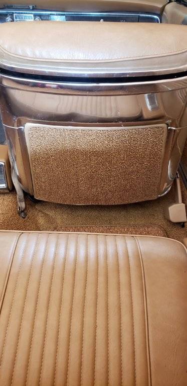

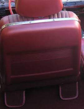

Do '66's have the flaps at the bottom of the rear of the seats to conceal the seat tracks? Here's a pic of them on my car. Not sure if it is correct for a '66 or not.

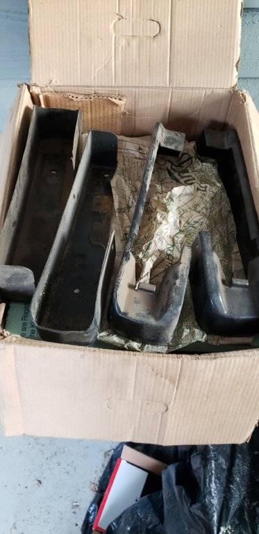

Thanks @detmatt , Christmas came early, nice filler packaging. Matt set me up with a passenger power seat base and all the panels. He even sent me an extra driver's side controller, when I realized I currently have a passenger controller.
I wanted his passenger controller because it was out of a Imperial Crown and has the cool feature when you lean the seat back forward it depresses a switch, which moves the whole seat forward. I think I can make this work on Goldie.

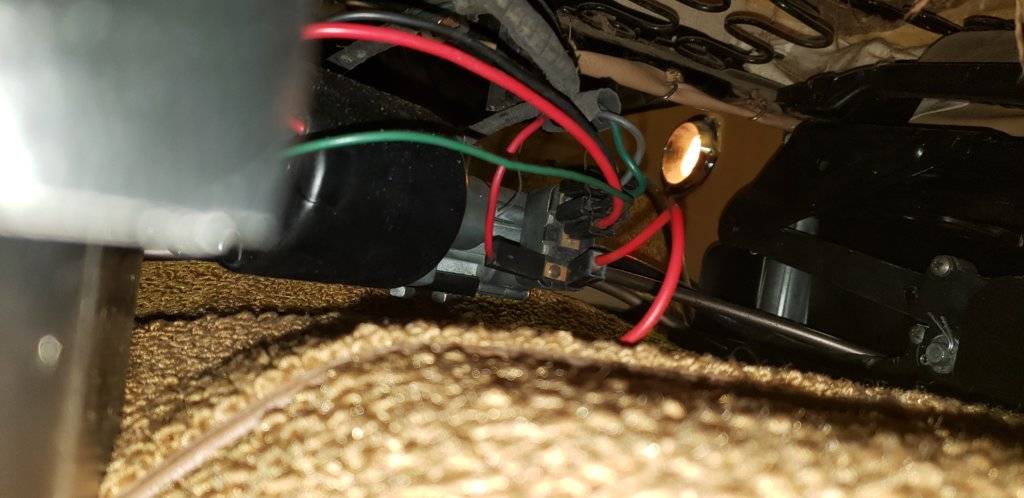

Took the front kick plate off, and the circuit breaker was right were the SM said it was. Tapped into the hot line and I was set. Got the correct terminal spliced in to make everything offical.

I can finally hear my stereo with the top down, fortunately I decided to install a passenger power seat, probably not until the off season. I installed the the amp under the passenger seat. It is small enough to share the room with the power base, when it is installed.
It did require me to move and reroute wires from my original location, but everything is located neatly under the seat and still appearing completely stealth unless you peek under the seat.
