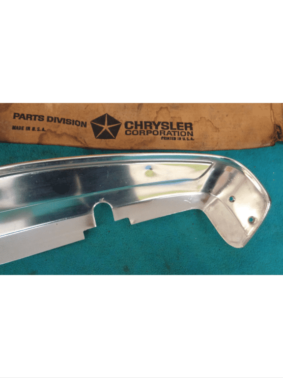

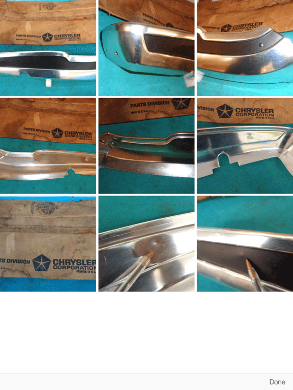

Here is what you probably wanted to see. This is what the buckets had. Note that the switch mounts to the seat not the molding. These were taken from an eBay post.
View attachment 274794 View attachment 274795
I presume this is an old post and it is not for sale. Quick search found nothing currently. Thanks by the way, great pictures, with Ross's measurement I will be set.
You are most welcome, I’m glad to help!

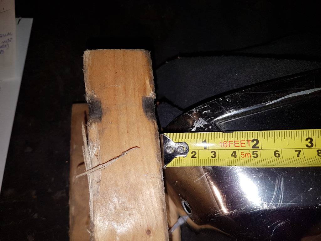

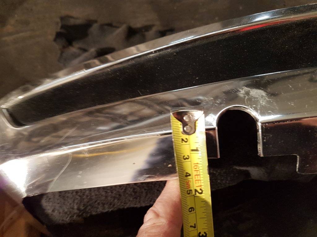

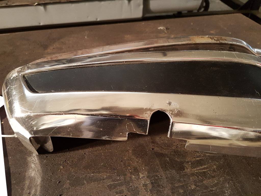

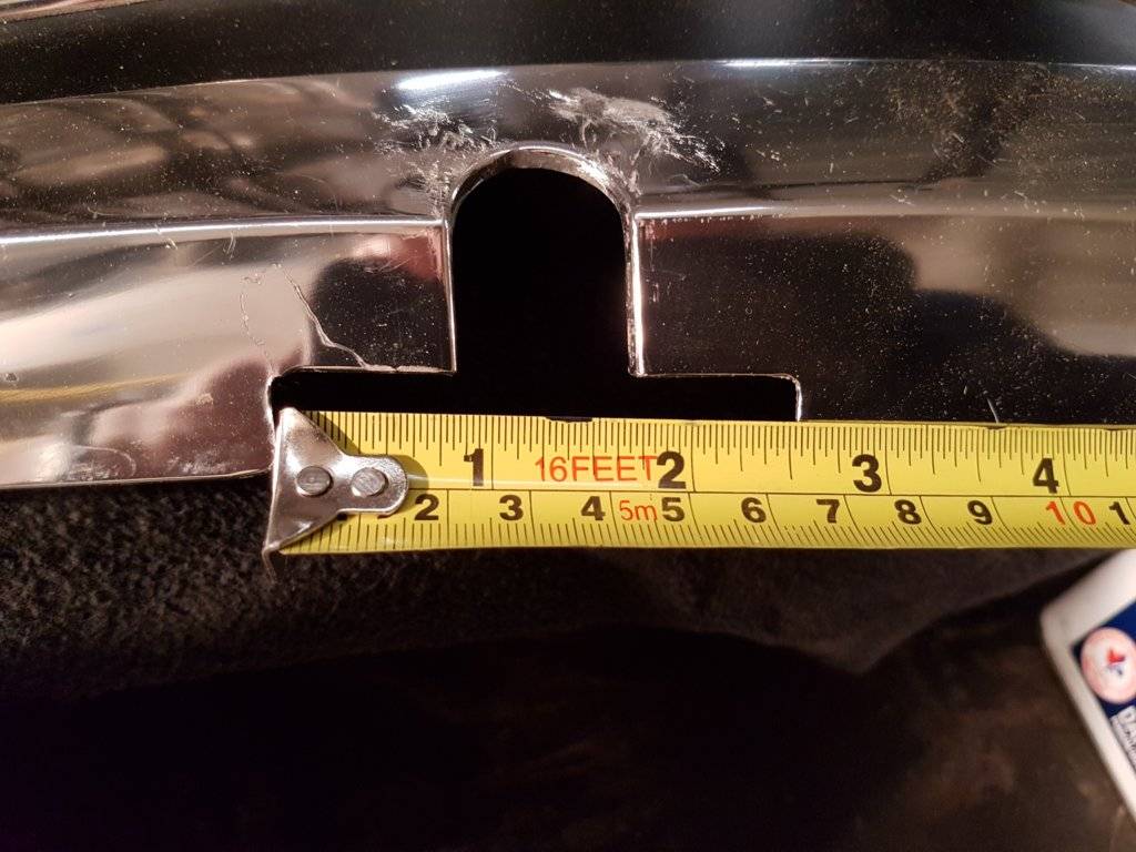

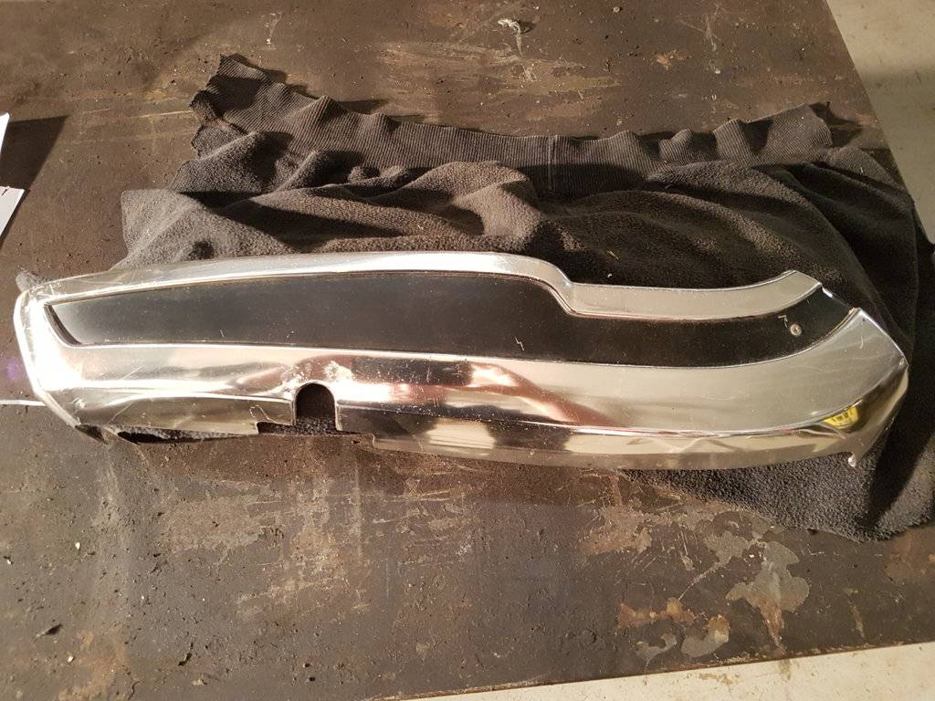

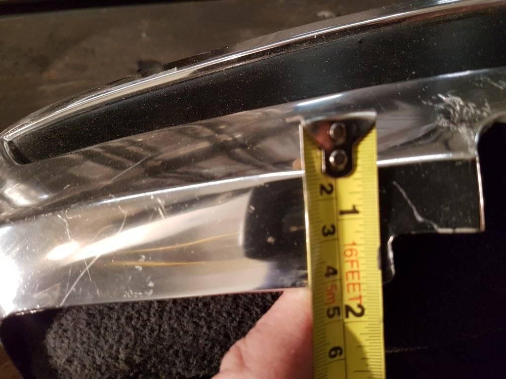

I made it to the shop today - here are some pics. I tried to show where I measured from, but it was a challenge to get accurate pics. Hope this helps.
Ross, that is great, thanks so much for taking the time to help out.

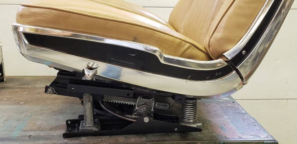

I made measurement between the manual and the power bucket seats. The power seat at its lowest setting is 3/4 higher in the front and 1/2 higher in the rear. I doubt if I even notice the height difference.
I also measured the power seat at it highest point. The front will go up another 1-1/2" and the back 1" My wife, at its highest setting, might be able to see the hood ornament now. :)

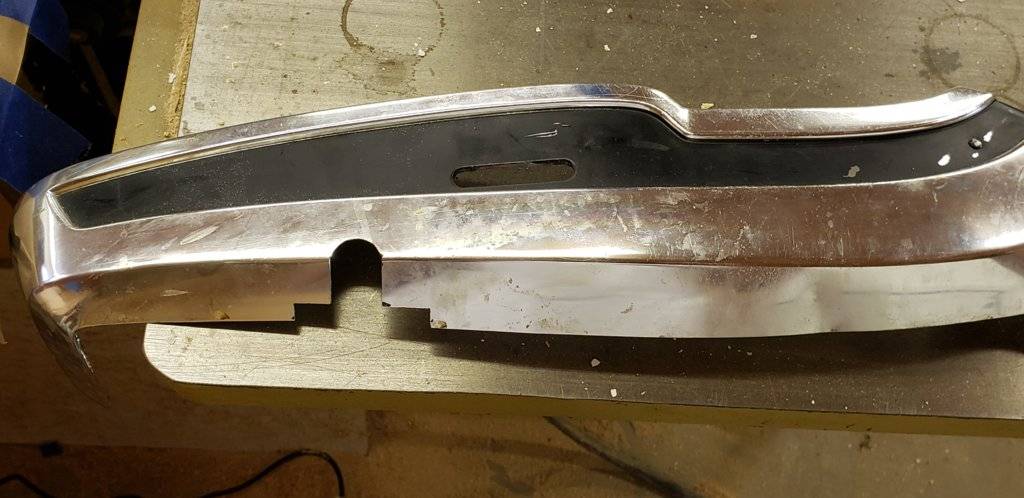

Thanks everyone for your help on this panel project. Ross your pictures and measurements were crucial. I made one cut everything slightly smaller put it in place made adjustments, very happy with the results.
What did you use to make the cuts, Mike? They look factory.
Thanks. I laid masking tape down and marked off the area until everything looked right. I used a dremel cutting wheel, free hand, to make my cuts, and rough in the radius cut. I then used various files to adjust until everything was square and the radius cut was proportional.
It really didn't take as long as I thought, the aluminum really cuts and files easily.

The seat bolted right up in the same location as the manual. There was an extra set of nuts on the seat, but I used the same ones as the manual.

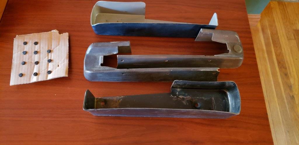

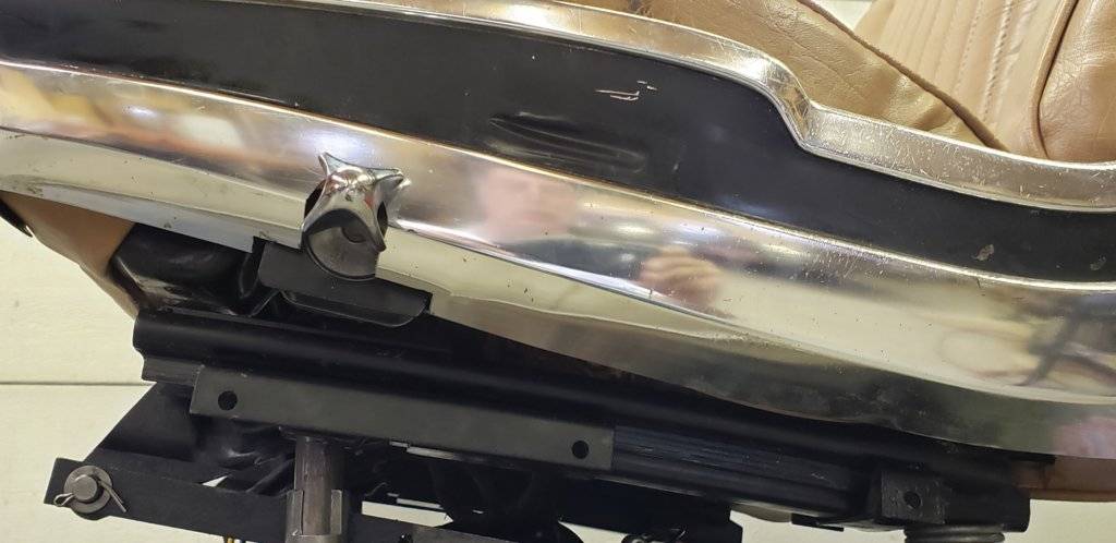

Well I thought I had the last piece of the puzzle, the seat base panels, to install my power seat back in Goldie. It finally hit me that I actually have the passenger controller.
Talking with Murray who I got the panels from, he had mentioned that the right controller has an R on the cardboard. I haven't checked it yet but I know I've got the passenger controller . I mounted mine upside down to get the front back correct, but the other controls are opposite.
Here here comes my perfect timing @detmatt just so happens to have a few power bases I'm getting one from him, for the passenger seat and now I will be getting the controller for the driver side. :)
