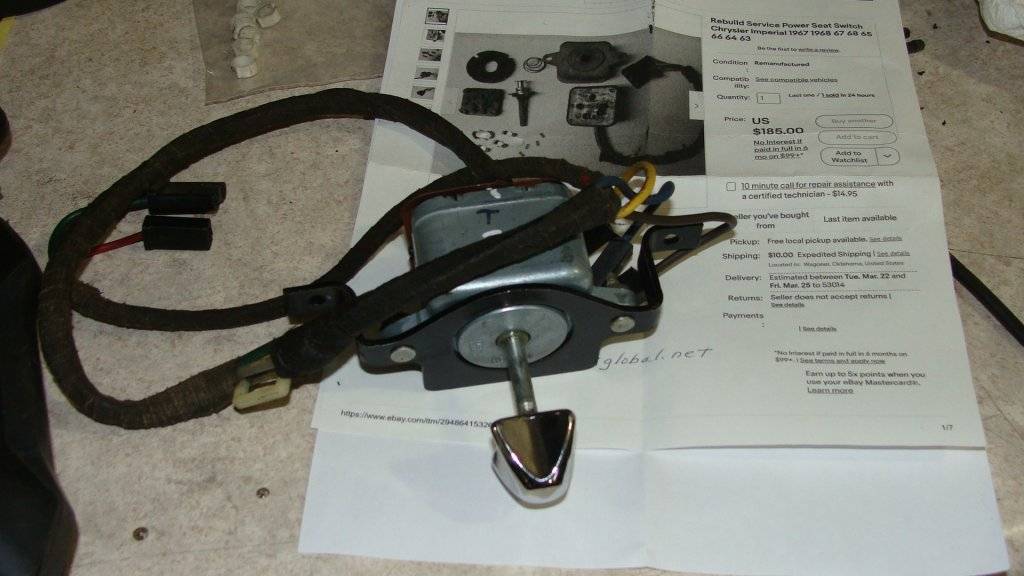

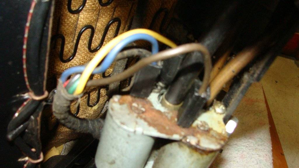

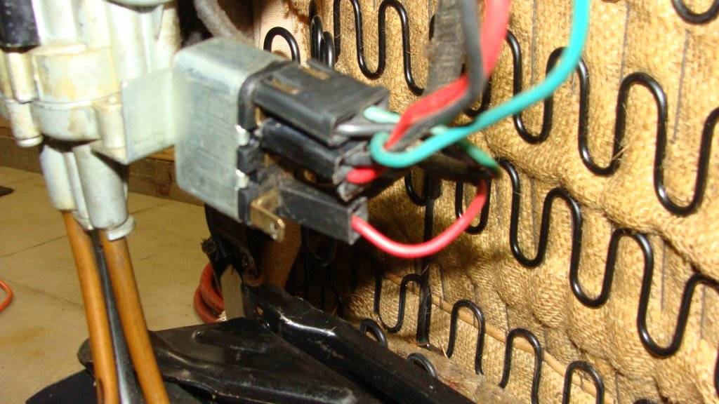

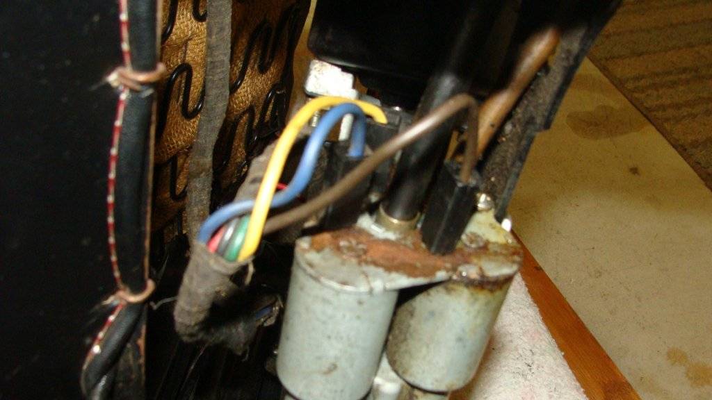

Hi, I'm hoping to get an opinion. 1968 NewYorker power bucket seat. Had the 4way star knob and relay rebuilt, originally I had power to that switch but it was falling apart. I've attached pix showing the assembly hooked back up. My question. Is it wired correctly? I'll be putting it in the car later this year I appreciate response.
Sorry I can't help because I got something switched around in mine, so some directtions are incorrect. I did get the power correct just the joystick did correspond with the correct movement of the seat. I hooked mine up to a battery with alligator clips before I ever attached the seat.

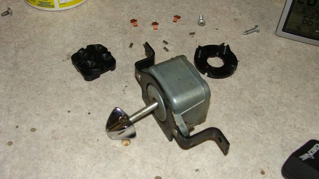

That looks correct according to my pics before I took mine apart. I believe you are missing the single power wire to the rectangular relay. Do you have any pics of the inside of the 4-way switch? I pulled mine apart and no pics to veryify which way the innards need to be put back in relation to the top/bottom. I planned on just trial/error.
I have one red wire coming up through the floor for my power supply, I don't have any pix, I sent it to Devenism for repair. Thanks for your comments Mike
