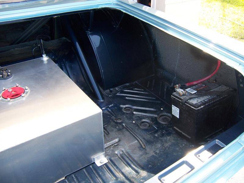

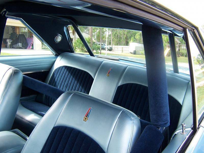

Henry, where did you purchase the scoops? When you have some time, can you take some pictures of the rear setup, trunk, interior shots please. The Dana 60 has been shortened and you mini tubed it, correct? Again, one of the coolest badass 66 Fury's around.
Thanks Tallhair, 66 Sport, The scoop was purchased at a local swap meet, actually I bought two of them, still have one for sale, They were a very thin fiberglass bond on style scoop that I modified by laying it up thicker and taller and I added a flange for 1/4 20 bolts, so it is a proper looking bolt on scoop. It is a 64 Max wedge style scoop that several fiberglass companies make in different manners. I chose it because the backside mimics the decklid on our 66 Fury's perfectly.

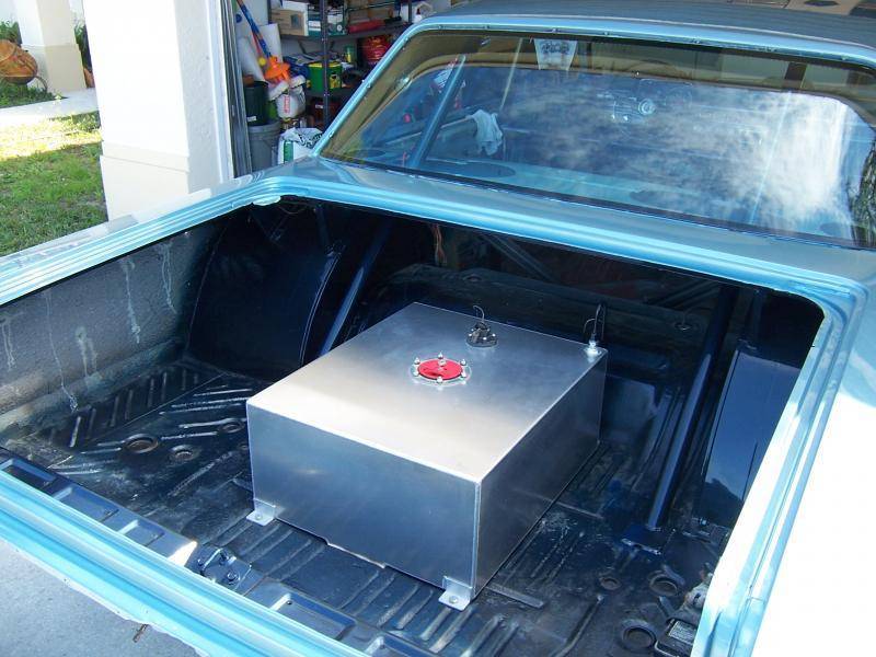

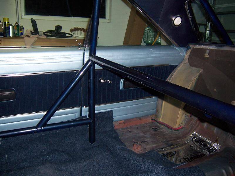

Here are a couple of build pics of the tubs I can send more but probably better to e-mail them direct to you. modelmakerinc@att.net 047.jpg098.jpg102.jpg103.jpg

You do really nice work and man I just dig your ride. Very badass! I will PM you my email address. I'd like to put together a scrap book of your car. I've done one for my car already. I love this **** and been a MOPAR freak since I could drive. I've owned a lot of them. Thanks for posting the pictures of the trunk and all.

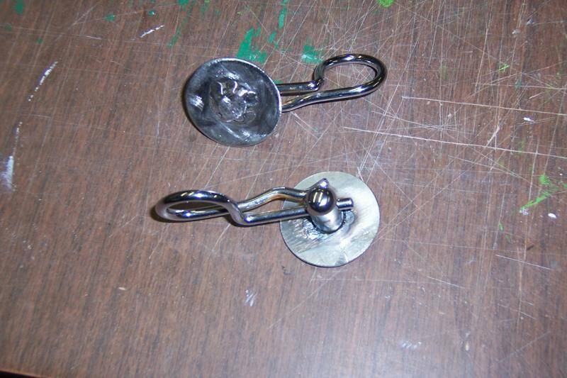

spent an hour after work today modifying my rear hood pins, I don't want to do body and paint to the hood again so instead of filling the rear hoodpin holes I made "fake" hood pins that will go and stay in. will catch some people off guard and I will probably pull the pin from them a few times until I lose the habit.

Henry, you going to have them plated? Wanted to ask you if you bulkheaded the trunk due to the fuel cell? Lookin good..!
They're the pins that I was using that came up through the cowl, I just cut them short to go through the hood and will bond them to the bottom , the chrome is fine on the exposed end.
A tech guy at NHRA told me with a complete back seat and full interior, a sealed metal bulkhead between trunk and passenger compartment was unnecessary, mostly since there is no way to inspect it. I would say if it were a used regularly as a "Race Car" I would have opted to do one. Many trips to the track never has anyone ever asked about it, they do check neutral safety switch, the shutoff switch, helmet and belts usually in that order.
