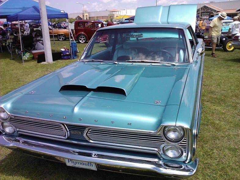

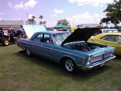

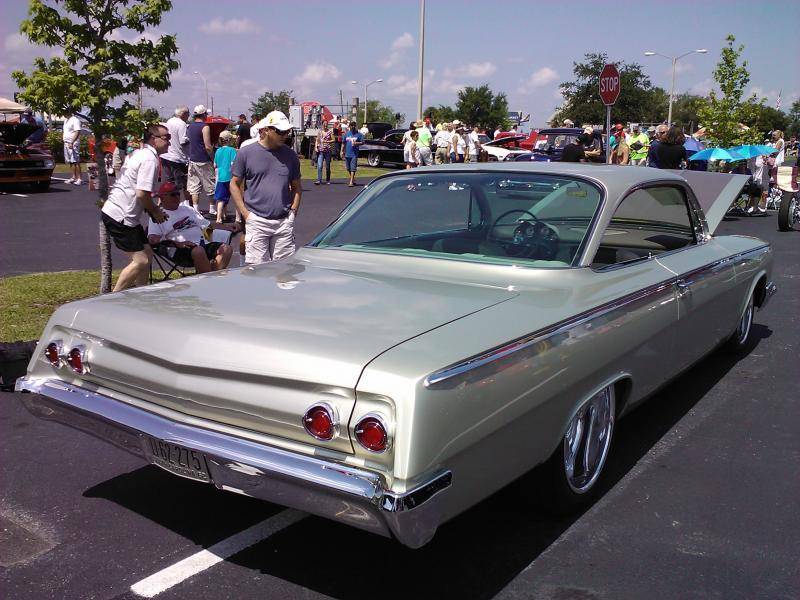

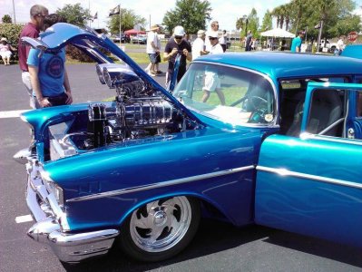

Well Fellas, this will probably be the last post on the Fury for a while, I have done as many upgrades as I can without spending a lot of $$$. I will be saving my money for future changes like A/C, or modern wheel and tire combo, I am not sure yet. I will drive it for the next few months, make it to as many weekend cruise-ins as I Can. The Car shows close to me are about done now that it hits 89* and up in the middle of the day, the few shows that are done are unbearable to sit through. I am considering taking the car to Carlisle, or the Nats. Here are a couple pics from the Good Guys show in Kissimmee over the weekend. I did not see one other 65-75 C-body mopar only a couple 56-59's were there.

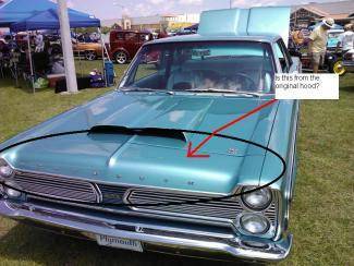

Henry, how did you manage to get a Fiberglass hood for the car? Also, you had to cut the original hood to place the front the way it is, or is that fiberglass also?
For all the years that I did service to the Fury, when the hood was up and I walked out to it I always said to myself that the hood being raised ruins the beautiful grill , headlamp and hood design. I think the front of the 66 Fury is one of the best looking ever designed, The hood is integral to the grill design. Like a shoebox chevy, it just looks wrong open.
Yes, I cut the leading section off of my original steel hood and built mounting brackets to have it bolted on, it is removable like any other part. For the rest of the hood I made what is called a splash mold out of plaster. you use the original part as a plug or master, spray a PVA (a release agent) or a lot of Vaseline. on the part then pour plaster of paris in several layers over top. when dry you flip it over and remove the part (hood in my case) and you have a mold that you can use once. clean up any obvious flaws, you spray gel coat and do a lay-up like if you are building a boat, or really thin if you want a race piece. It was after that I cut the hole for the tunnel ram and then much later added the Max wedge scoop

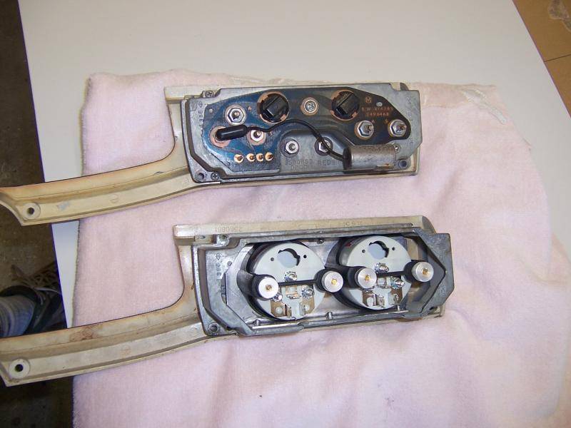

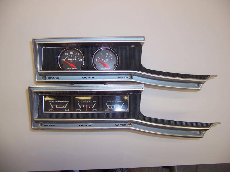

yeah Stan, There is a lot about my Fury that just really isn't seen or appreciated until I show or explain it. Here is another small part of my car that received attention that most people just miss or take for granted. just the left side gauge pod, the right is made very similarly.
View attachment 29354View attachment 29355
Thanks for the tip! I like the gauge pod, I was looking at mine thinking about moving them there but wasnt sure if I sould make it work...obviously I can...
