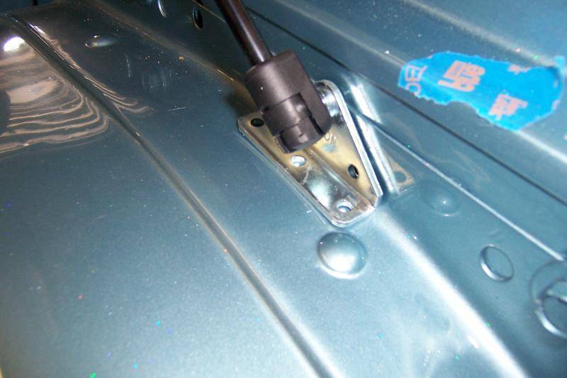

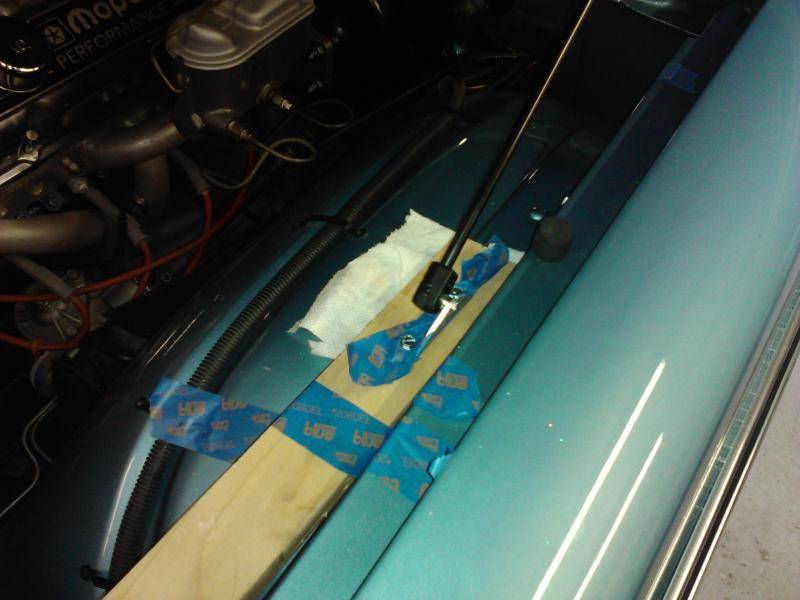

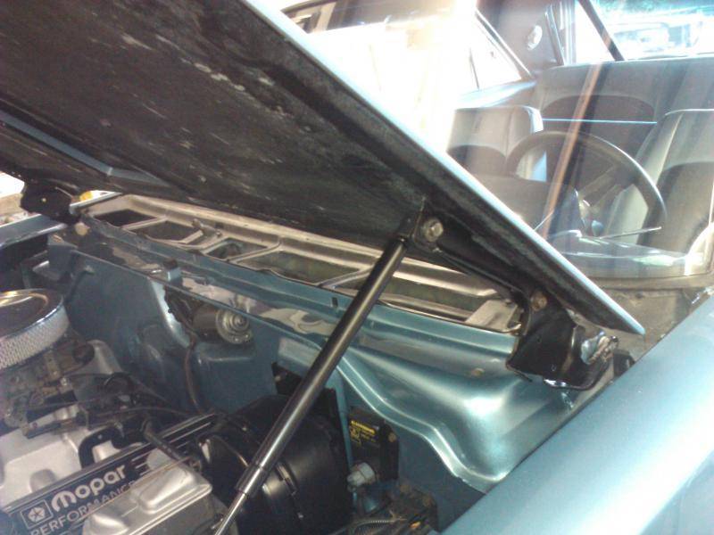

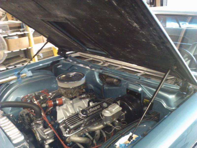

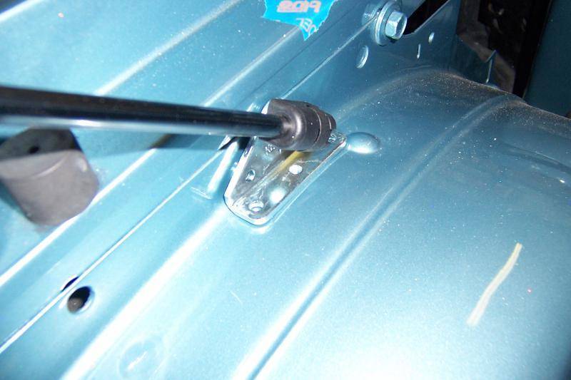

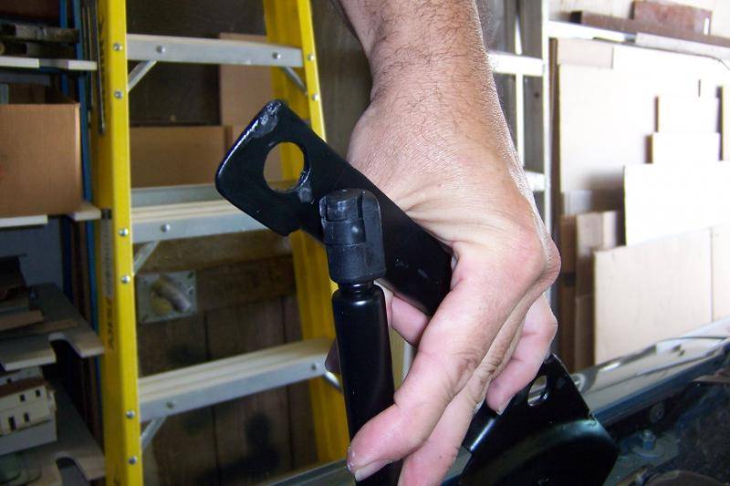

A little mock up of the strong arms, I bought several sizes and pressure levels and tried different configurations for the lift arm to work right, I tried horizontal pushing forward and vertical pushing up, the tightest, best look is vertical pushing up but it puts pressure on the fiberglass hood to hold it closed, with engine heat cycles and Florida sun it is not a good idea to stress fiberglass in that way. it will move and warp.
Horizontal pushing forward the geometry put me in a catch 22. When the lift arm was long enough to clear the hinge at the close position it was way to strong to pull the hood closed comfortably, when I went to a shorter arm it did not work with the hinge or it wasn't strong enough to hold the hood.

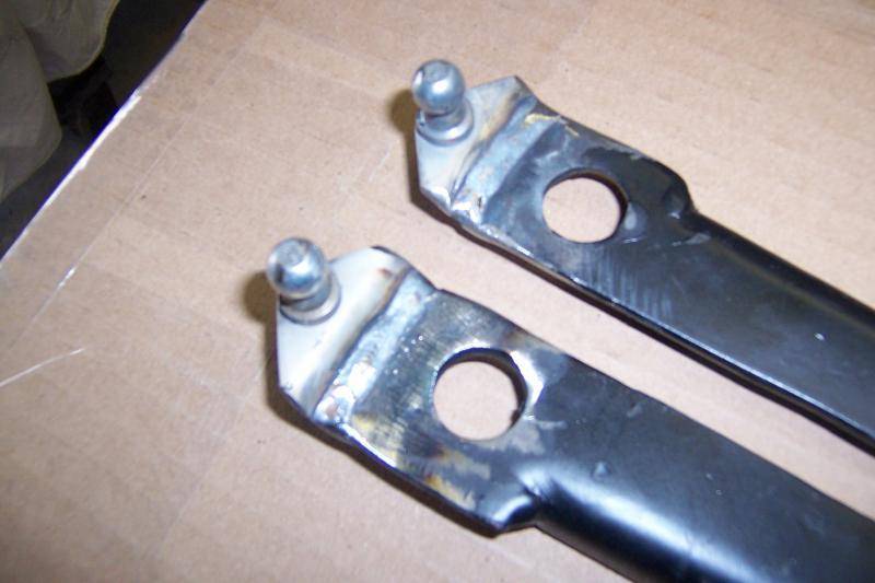

I went with the least attractive but best functioning set-up, Function over Form I guess. it is horizontal pushing back, I will weld the ball end onto the tip of the hinge and the lower bracket will sit tight on the inner fender, when the hood is lifted around 8" up the strong arms take over and lift it to its position. In the closed position the strong arm pushes straight into the hinge, leaving no stress on the hood whatsoever. We have a winner. WP_001641.jpgWP_001642.jpgWP_001643.jpg
Very nice install Henry. Looks great and you got it function correctly. Nice job man!

Very nice! I really like how you came up with the hinges. It really looks like it is supposed to be there. I have seen the factory do some WTF type of mounting on that kinda stuff. Really liking everything your doing. Of course it is pretty easy when you have probably one of the nicest cars out there!
Hey Acreage,looking good! Are you using any kind of metal reinforcement plate underneath that inner fender for the mounting point? I guess you may not need it with a fiberglass hood since your using two hood struts to help equalize pressure. I was considering doing the same thing with linear actuating struts with my stock steel hood. BTW,would you happen to have the measurements of the struts you used in the open and closed positions.Any manufacturer and part numbers would help too. Thanks!

GreaseMonkey, I used this site to find the gas struts: http://www.siraweb.com/ I measured what I thought would be the appropriate geometry and chose the length that seemed right, 20" with that length in mind I bought a strut with 37 lbs of pressure figuring the manner I was installing the hood would have a lot of leverage against them. they are too weak in one arrangement and they are too strong by a little amount in another. In the vertical arrangement they were almost dead on for lifting and holding the hood, but at collapsed or with the hood shut the arms want to push the hood open at all times and the fiberglass hood would suffer in time.
When the arms are horizontal they push the hinge into the pivot and the base forward on the inner fender, a very stable and strong area they don't push up on the hood until the hood is 6" -8" open then they extend to full open. Here are a couple of pics that show the different placments. If I had a steel hood the vertical scenario would be perfect with a very strong (maybe 80- 100 lb) lift arm
