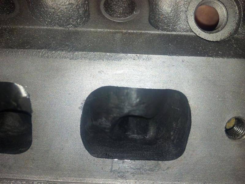

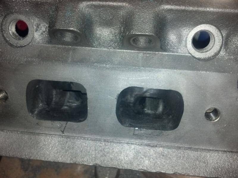

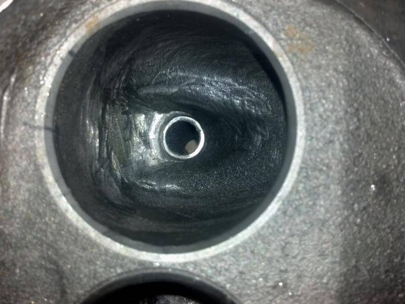

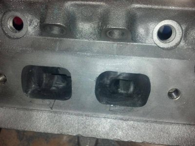

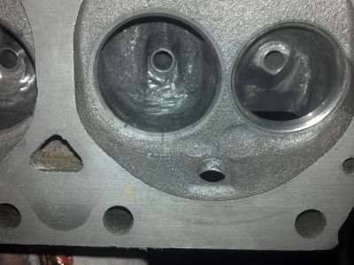

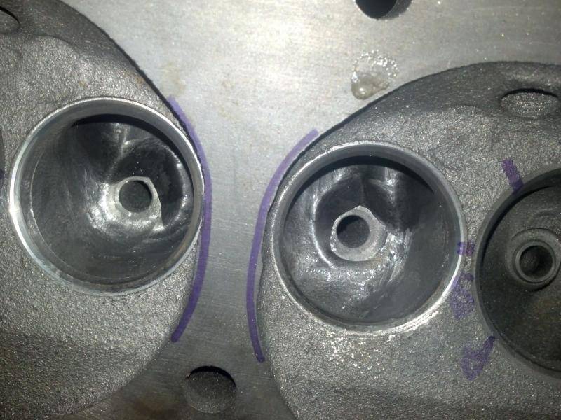

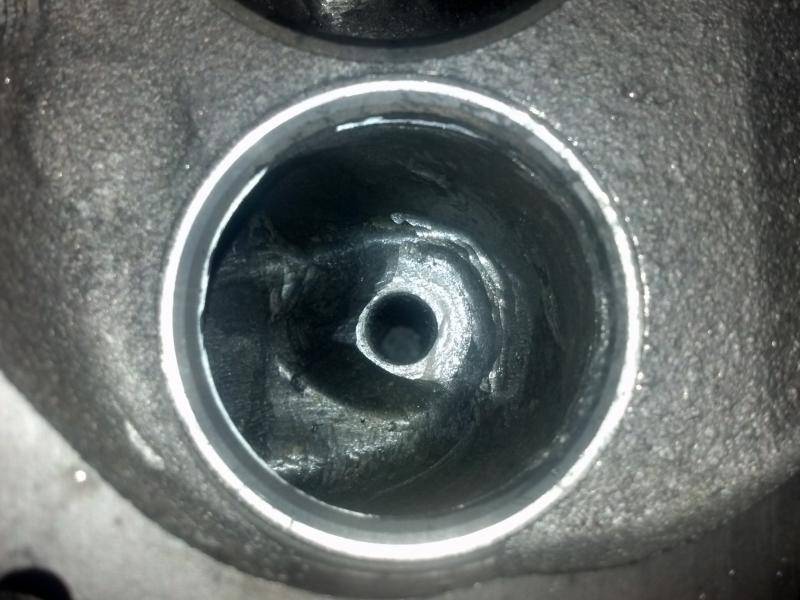

getting better IMG_20140107_200401_654.jpgIMG_20140107_200341_175.jpgIMG_20140107_200341_175.jpgIMG_20140107_200304_667.jpgIMG_20140107_193817_687.jpgIMG_20140107_193817_687.jpgIMG_20140107_193817_687.jpgIMG_20140107_193805_184.jpgIMG_20140103_140731_911.jpgIMG_20140107_200341_175.jpg

I'm trying, always good to try new things! And hey I'm a positive person ya never know could always be used later as a tech article. How not to port cylinder heads haha! bout 3/4 of the way done with one head. One more cylinder then sanding rolls and maybe deshroud the valves and possbly clean up the casting outside of the valves.

You're doing well, but a couple notes...
You are wearing a dust mask or respirator - right?
On the intake ports - You need to concentrate on the port entry more - the main flow is along the roof and "inside" curve so make the corner radius cleaner to follow the gasket shape. Shape differences there can have a large affect. The port floor is better left untouched and lumpy. In the bowls with the templates - IIRC they are made for 2.08 valves. Follow the templates and leave the bowl smaller. Don't "hog it out". It will flow better properly shaped rather than larger. When you have the valve job done make sure the shop uses cutters for the seat angles, and have them to a 5 angle - that includes a throat cut and an unshrouding cut in the chamber. Don't polish it beyond the rough grit sanding rolls, and leave the floor untouched until the area where the approach to the short turn starts.
On the exhaust - Do not go to gasket opening size at port exit. Raise the roof to the gasket hieght, blend the lump (I'd be careful - there's coolant right there too) on the roof, and keep the finished port about .100" smaller than the gasket size. Blend that back to the bowl area and again - watch your corners. The exh port can be fully polished.
Thank you very much! Thats the kind of advise i was needing! Yup i'm using a dust mask! Just porting a bit at a time when i do have the time and the weathers nice.
