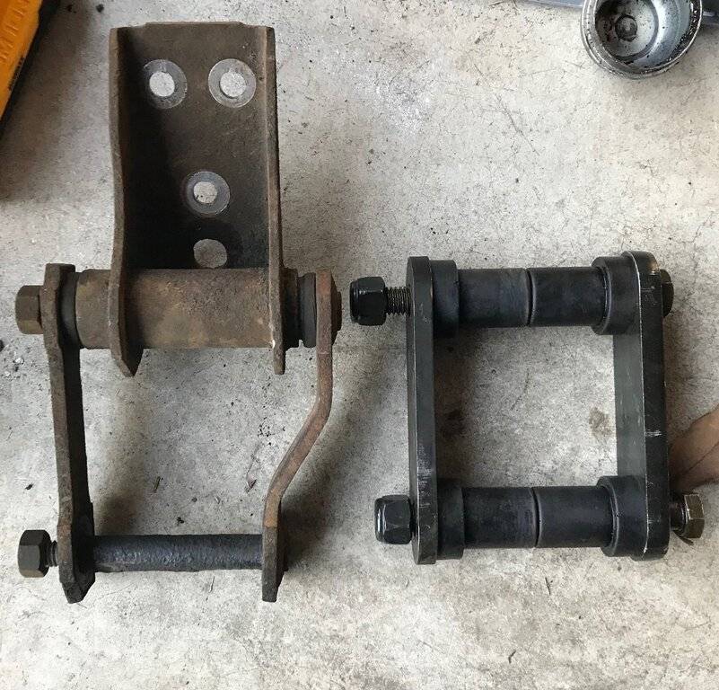

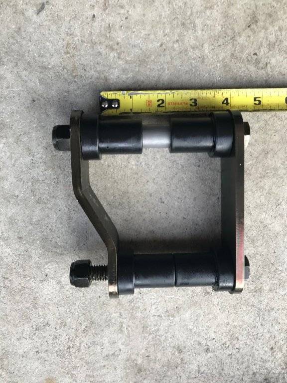

The offset looks right, but the width of this shackle looks about an inch wider.
So.... The question is if the extra width is being taken up by those bushings? Or is the new shackle not pushed together for the picture?
But, if nothing else, it seems to me that if the offset is right (or close enough) and the width can be changed by shortening the metal bushings between the uprights, this could be the answer.

The shoulder of the poly bushings from Firmfeel is much wider than the stock bushing. The top is about 3 3/8" between the shoulders, which looked roughly the width of the hanger. Could you measure the hanger width? (mine is on the car)

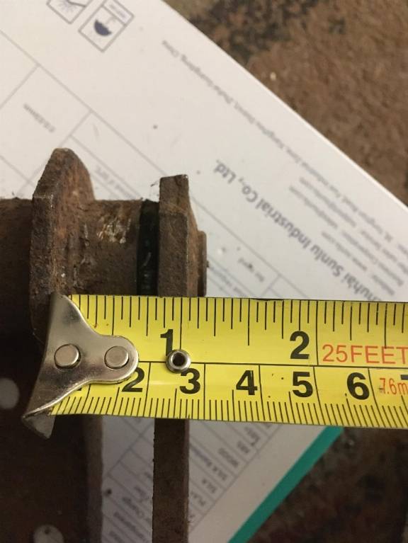

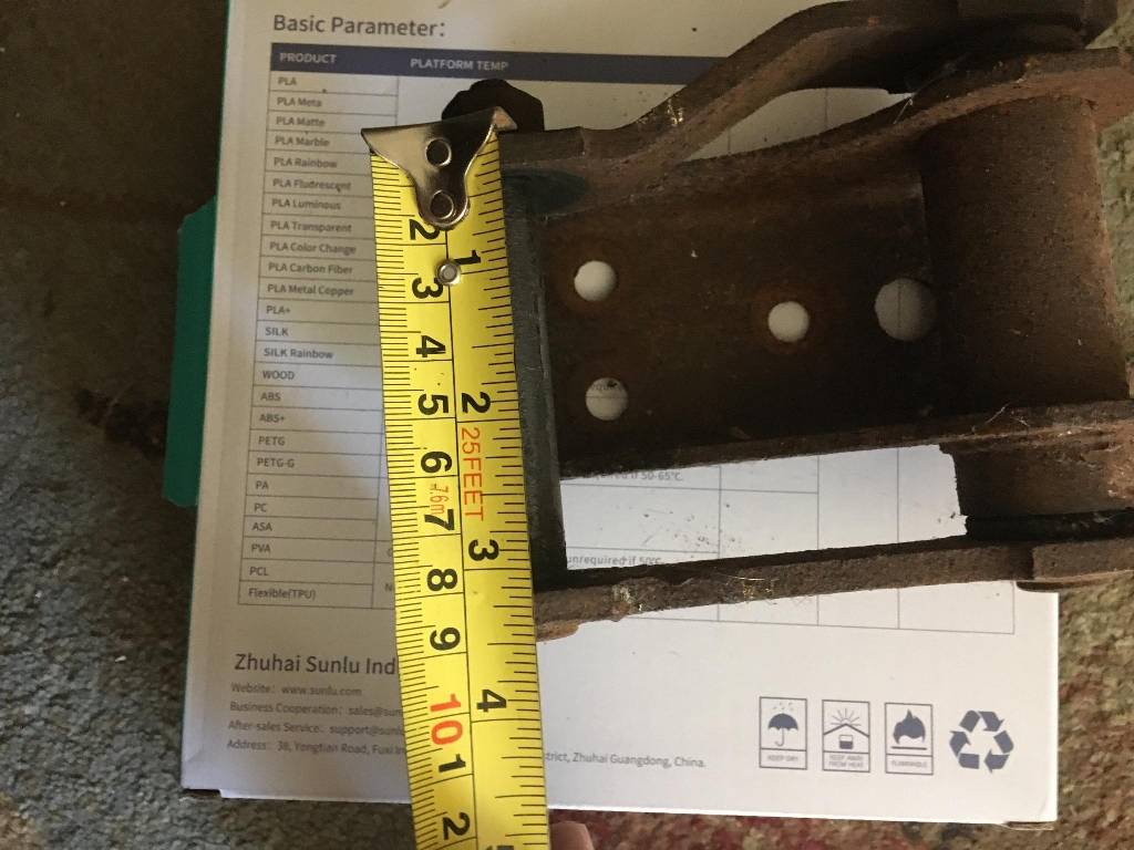

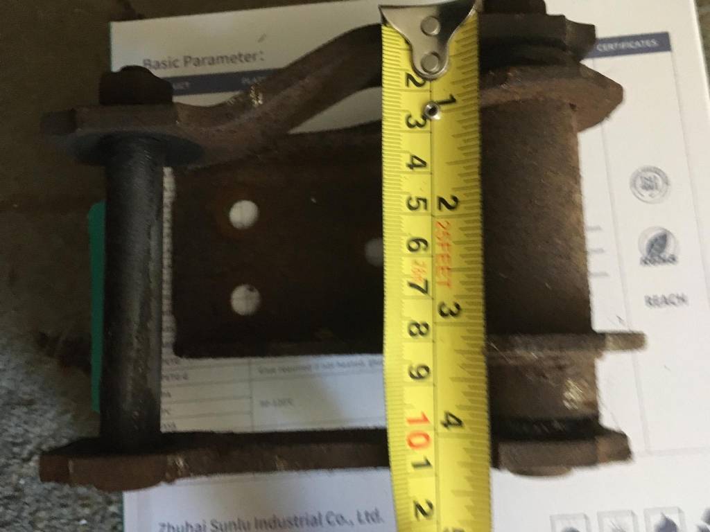

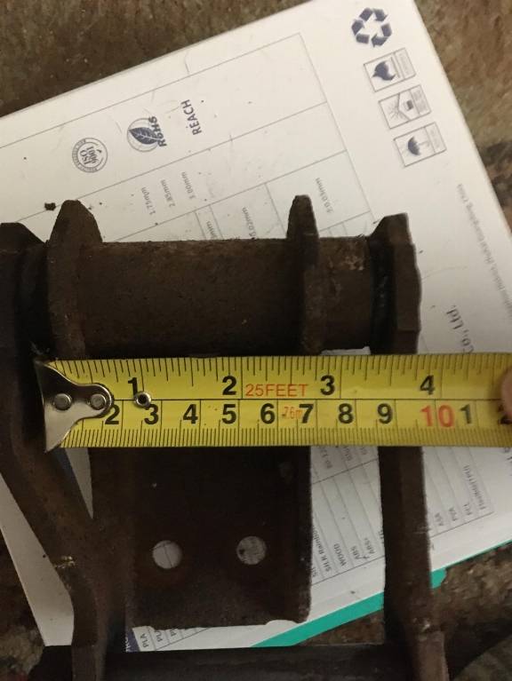

The width of the "hanger" at what I think is the important part of this discussion is ~3 3/8". The tape measure picture doesn't really show the measurement accurately, but it is 3 3/8".
One side of the tube sticks out ~5/8" and the other side ~1/8" (couldn't get a good pic of that 1/8" side)
