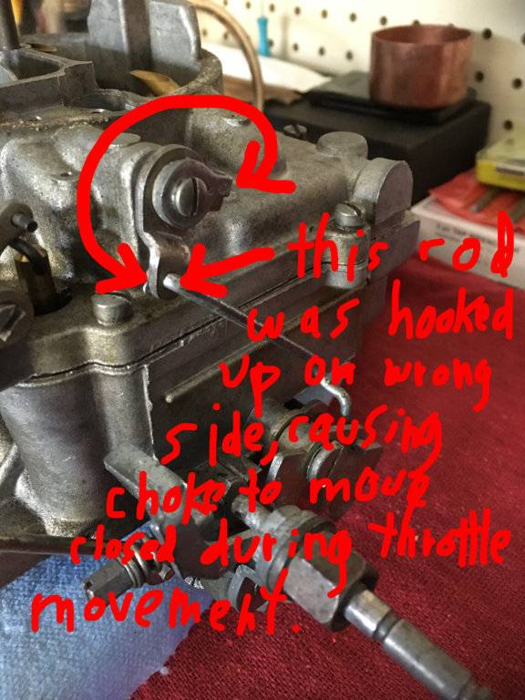

So, I've at least solved and resolved the choke issue. It was malfunctioning because of the rod(pictured) being connected improperly(lever was in wrong position when rod was connected).. took me a while but through comparing it to other properly working Carter AFBs I figured it out.

Thank you, I am learning more and more each time I've got an issue, as I'm very hands-on with just about everything. I figured out the choke issue and that now functions perfectly after a minor but critical re-adjustment.

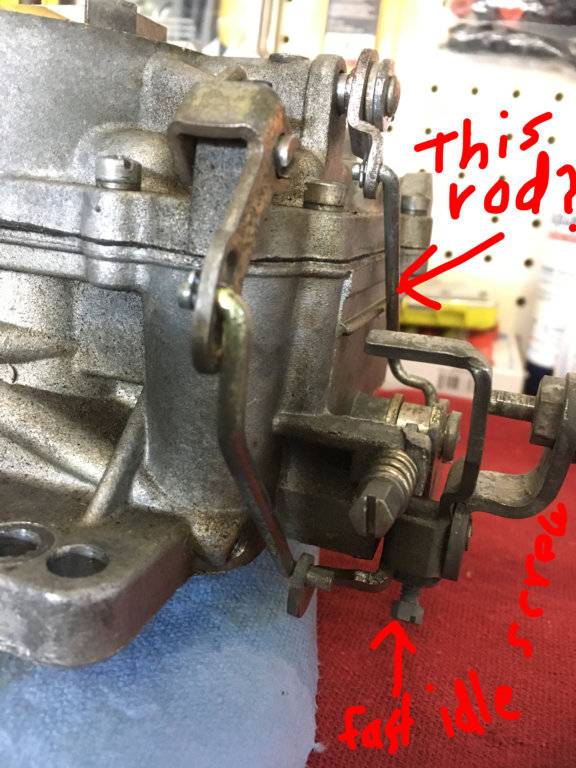

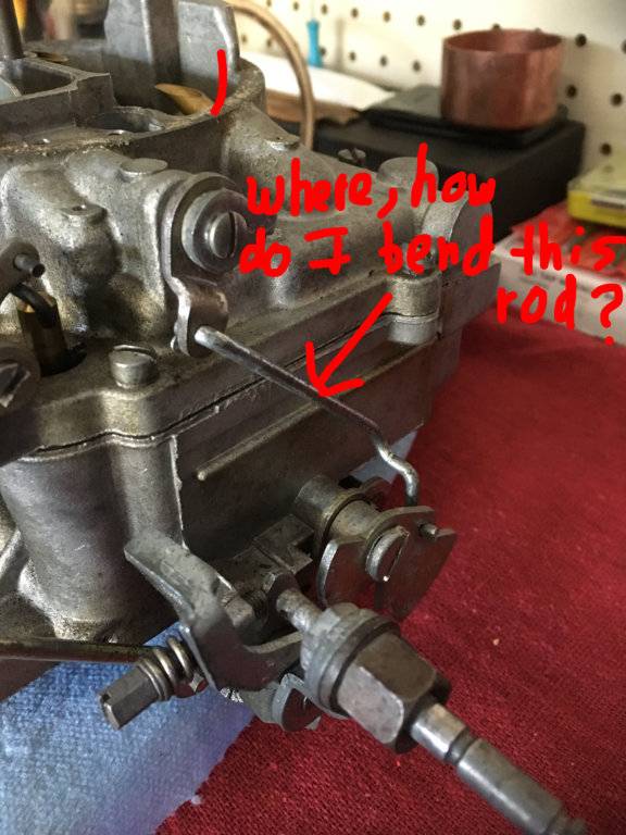

My fast idle speed is good upon start up. I clearly should bend the rod while engine is up to temp.. but where and how I don't know...
Do I need to touch the idle screw or fast idle screw at all once I set the cam free?

Try backing off the fast idle screw about 1/2 turn before you bend anything to see if that closes the throttle plate. The rod you have featured is the correct one to bend if that becomes necessary.
