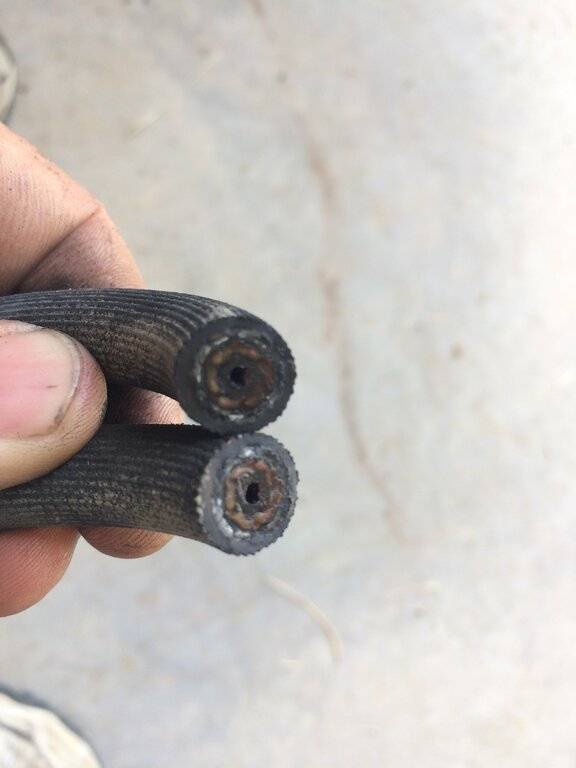

The MC was stuck so no pedal movement started the this brake saga. With the MC removed the pedal and booster rod moved freely. I managed to pull the distribution block and gave it a good cleaning and all the ports flowed as they should. The rear rubber hose has already been replaced by PO.Let's ask this question and work backwards.
Did everything work before you started replacing parts?
I will try bleeding the system again this week hopefully with better results. On a positive note the trans is working
