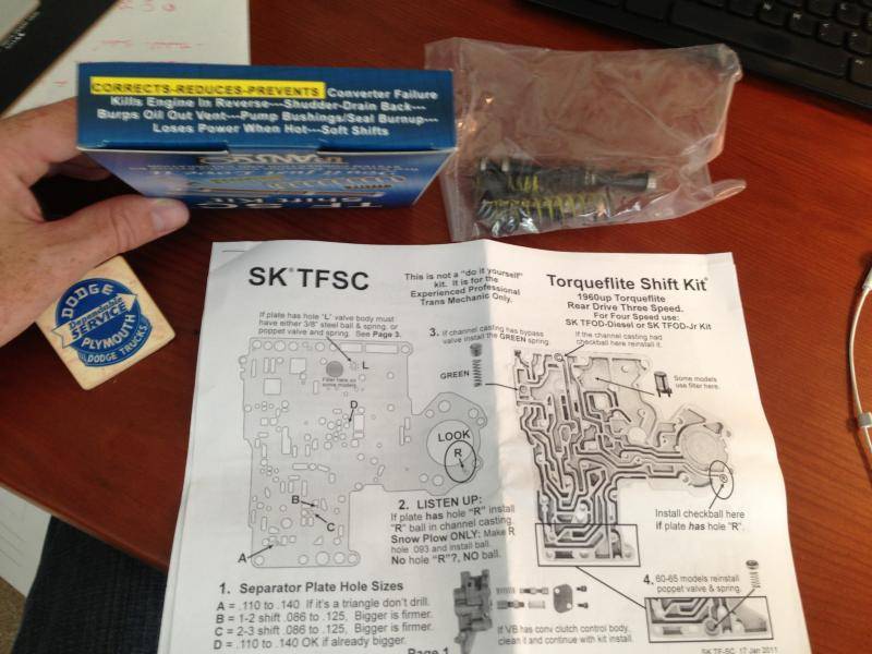

Picked this up the other day...this is the mildest shift kit offered by Transgo. This company received a lot of acclaim on the Allpar site on the page that talked about the "Legendary Torqueflite". The founder, Gil Younger, was known as "Mr. Shift". Sounds like he was quite the well-respected go-to guy for trannys.
This kit isn't really supposed to make shifts much firmer, according to various sources I've read, just improve the flow of fluid, prevent converter drain-back, improve oil flow to bushings, correct soft shifts. As an added bonus, it'll allow the fluid level to be checked in park.
Tranny is working fine now. But figured I'd install this kit over a weekend and hopefully keep this 727 in service for a few more thousand miles, maybe 50. currently at 93k.

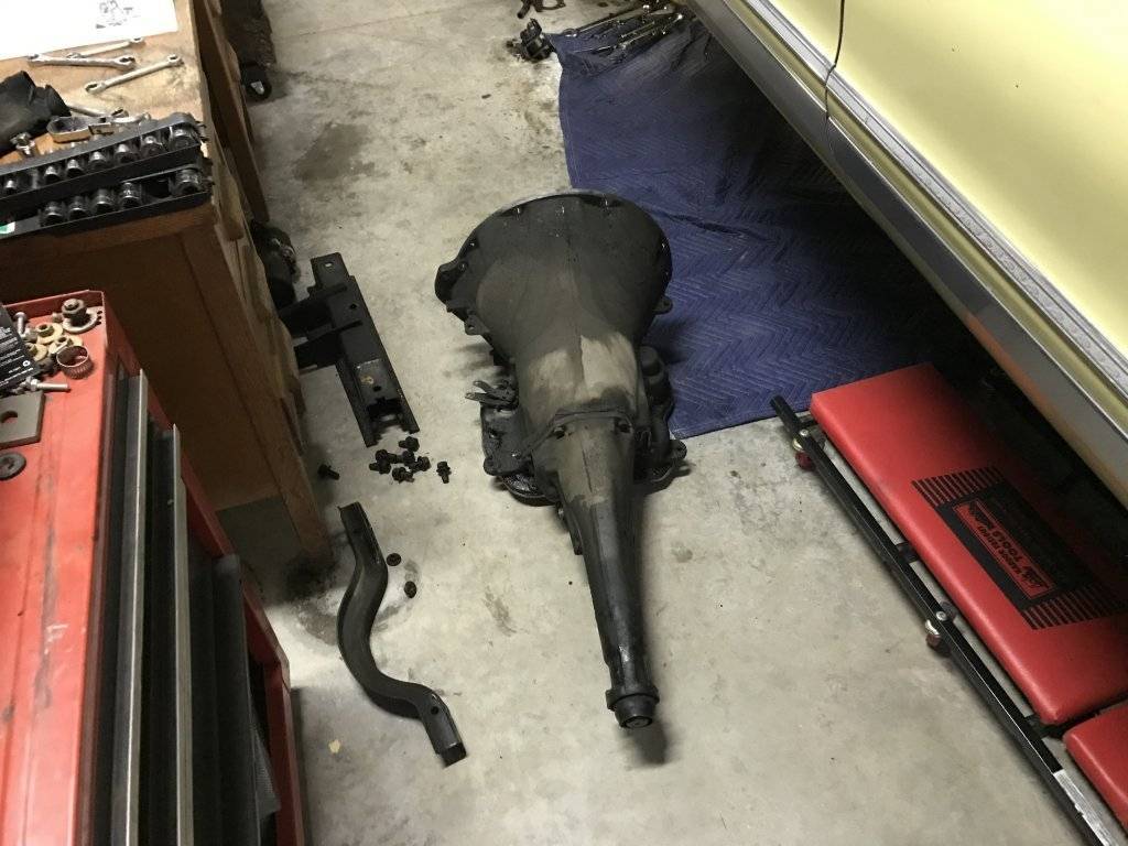

Speaking of which, this is one of my current projects. I sure hope I remember how to put it back together...
It looks a lot worse than it actually is. The factory service manual is actually pretty good in describing the sequence and the adjustments. It sure helps to have some of the factory service tools for some of the clutches and such. I personally would not take apart the valve body unless there was something wrong that suggests it as a culprit (rare). Just clean it and save yourself some time. I used to take them all apart until I realized it was pretty much a waste of time.
One caution, be sure to replace the o ring on the kickdown lever shaft as the service manual is skimpy on mentioning that, and you don't want a leak from it down the road (it will leak out the back of the case).

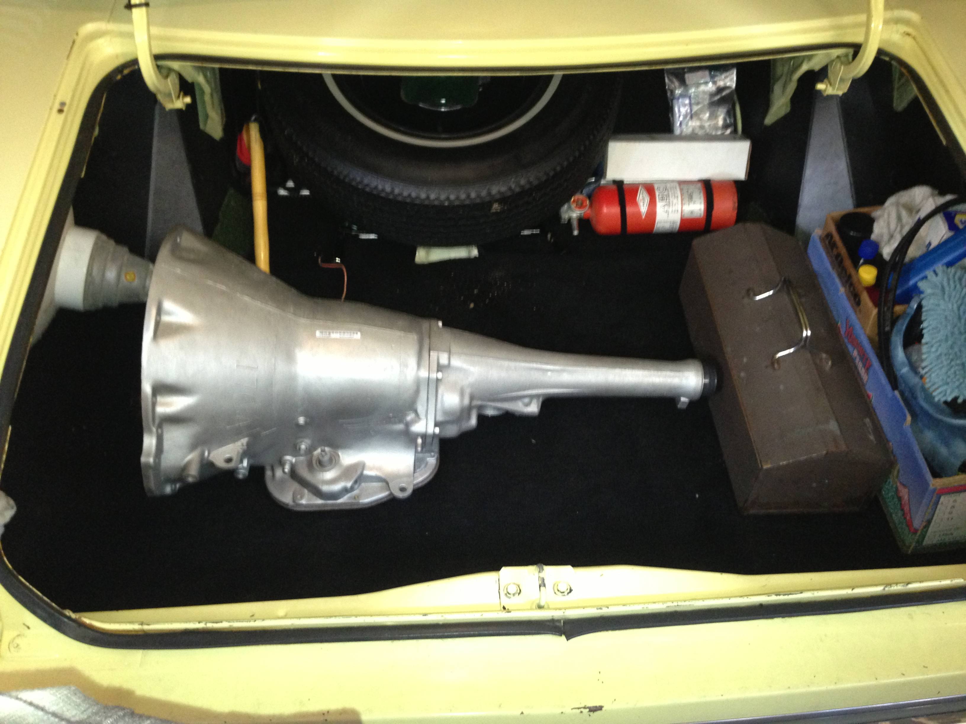

I had it delivered to a friend's shop then I picked it up last week. It sure fit nicely in the trunk!
I have one of these in my '69 NY. I love it. The shifts are firmer, but not harsh. Just as advertised. The weights on the converter, by the way, might be for helping balance the motor. I have heard that since 440's are internally balanced, using a torque converter from a motor that is externally balanced (such as a 400) should be avoided (I trust someone will correct me if I've got this wrong). My guess is that externally balanced motors use weighted converters.

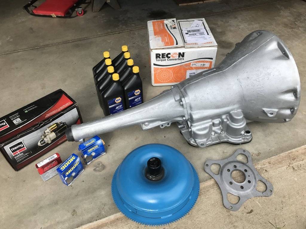

...and roughly 8 months later, the weekend has finally been set aside! Got the tranny, TC, a new starter, new U joints, seals, O-rings, rags, pans, blankets, containers, and tools packed in the trunk (still with lots of room leftover, lol). Driving 100 miles east to the in-laws' ranch to do the job (since we live in a beehive and wrenching is frowned upon here). Should be fun.
