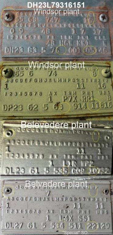

I want to understand the relationship between production date (which technically I know is scheduled build date) and the sequence number, and additionally whether or not there's a w code on the tag and also if the production plant plays a role here. In looking at 8 fender tags, what I notice are:
- some have w6, some have w8, and some have no w code.
- tags with w6 have sequence numbers 05xxx
- tags with w8 or no w-code have sequence numbers 10xxx or 11xxx
Am I correct that you can't get the factory from the fender tag - that it's only going to be on the VIN plate?
Which factories built Monaco's and Polara's? Windsor and Belvidere IL ? If this is correct, then can it be said that the 05xxx sequence numbers would be Windsor-made, the others being Belvidere made? And that maybe all Windsor-made tags will have a w-code stamp (either 6 or 8) but Belvidere tags will either have w8 or no code?

For 66 and 67, SO numbers are make dependent. Meaning assigned SO codes for Valiants (A body Plymouths) are different than B body Dodges which are different than C body Plymouths which are different than Chrysler's that are different from Imperials. The topic of SO/VON assignments across the various years is a book unto itself.
For 66 and, presumably 67, it appears as if each plant uses a five digit SO number with the last three digits resetting each day. The first two digits indicate the make and body classification i.e, C body Dodges built at the Belvedere plant start with the number 10001 each day of production meaning you can have a sequence of 801 10001 and the next day have car 802 10001. IF you build more than 999 cars in ay one day, then the first two numbers go from 10 to 11. If my theory is correct, a car with SO number 11202 would be the 1201st C body Dodge built at that plant on that day. I'm still compiling data to verify this theory.
One still finds non normal SO assignments for fleet cars, lease cars, show cars etc. This classification of cars would start with numbers different than the typical assignments. For example, a DK cop car SO may start with 89. A DL27 promo car may start with 22. A typical US sold 67 Dodge SO starts with 10 or 11 whether it's from the Windsor or Belvedere plant.
Each plant had its own coding nuances meaning, yes, you can, sometimes, determine the plant of origin by the specific nuances on the tag. Different plants coded differently. Identifying inspection stamps vary by plant.
As pointed out, 67 Windsor used screws too afix the tag, the Belvedere plant used rivets. '67 Windsor coded w/6 or w/8 to indicate the final country of sale either Canada or the US. Belvedere did not code this. 67 Windsor used a two digit tire code. Belvedere used a three digit code.
So you can look at a 67 full size Dodge and determine at which plant it was built simply by looking at the tag.
The VIN rages are different for Windsor w/6 and w/8 cars.
In my estimation, Windsor used the 05 SO number in conjunction with the w/6 code (built for sale in Canada) and the 10 or 11 SO code for w/8 built for sale in the US cars. Belvedere used SO numbers 10 or 11 for typical full size Dodges. More examples would help with this research.

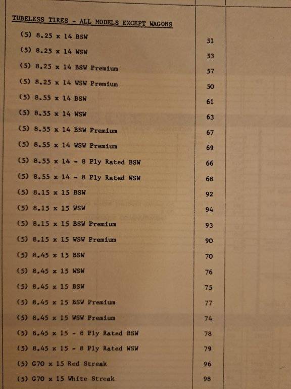

I did not know about 2-digit vs 3-digit tire code difference. Were there that many tire sizes that needed 3 digits? Did all cars always get a spare tire?

See list of tire sizes and codes. (Canadian fleet list,btw)
As others said, each plant may use their own codes.
The (5) confirms each car got 5 tires. In some provinces and or states, a spare tire is required as part of their vehicle inpection/ certification.
So yes each car got a spare tire.
