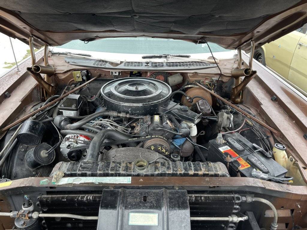

A new ICU and a Mopar voltage regulator are on the way from Mancini Racing. Plans include looking for the correct alternator, and detailing the engine compartment.

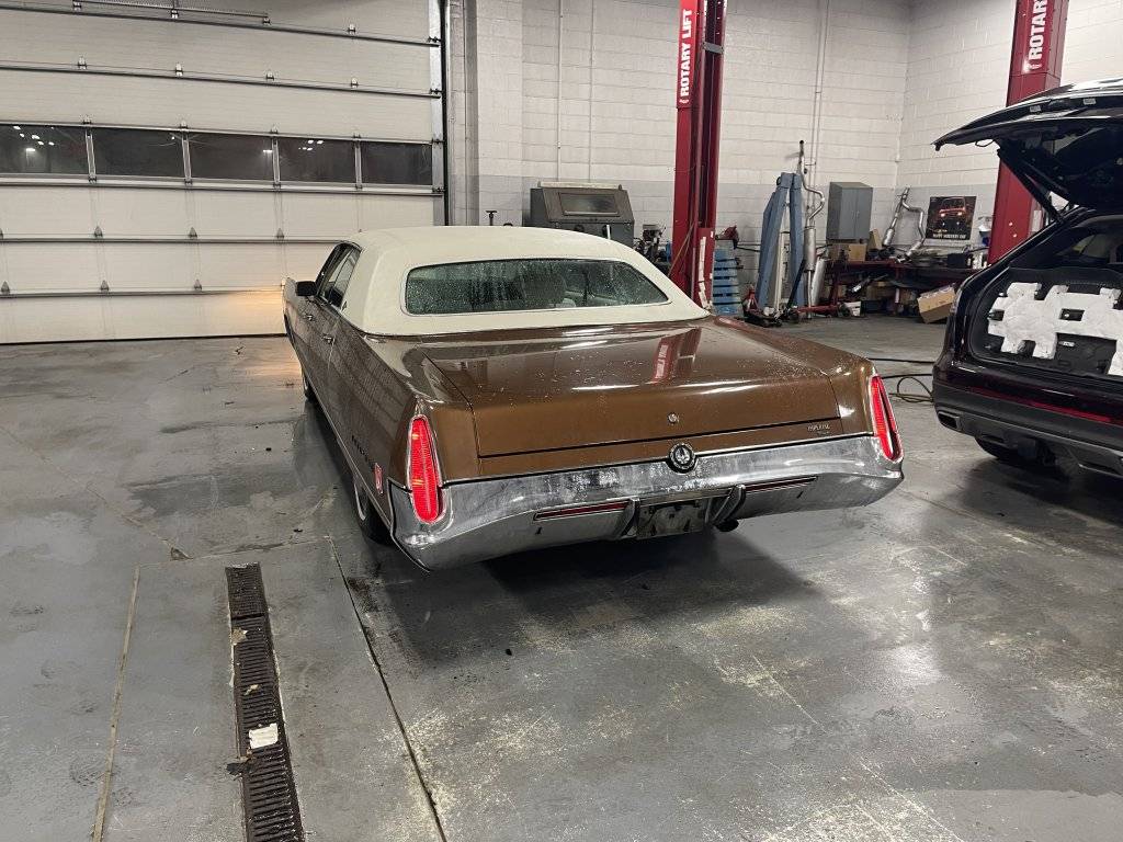

The trunk is the worst part of the car with all the dress-up panels damaged and the carpet being totally gone. I have an interior guy who may be able to make a new trunk carpet for me.
I got the alternator replaced, new ICU and a new voltage regulator. The old ICU had the epoxy melted out, as usual.
The car went out to lunch and it was a 48 mile round trip. It did really well.

I will be installing some x-mat on the trunk floor as well. It is a glaring flaw when driving the car. It is quiet inside, except for the road noise coming through the unfinished trunk.

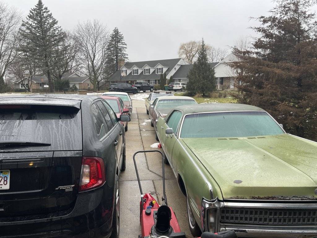

2 1972 Imperials, a 1973 Imperial, and a 1972 Valiant. The 1973 Fury is still around, but I am working on it at my dealership on the weekends.
I see your AutoTempII servo has been upgraded already with the aluminum bottom. Does the ac work?
What does the 2nd vacuum canister on the passenger side wheel well do? My car only has one there
No it does not work. The blower has been rigged to a toggle switch. There is no temperature control at the moment either.
It must have something to do with dual A/C, I have not had a chance to really dive deep into repairs yet. It is too cold to spend much time outside.
