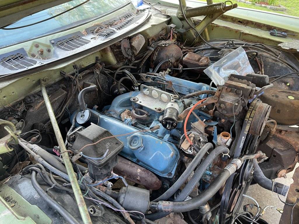

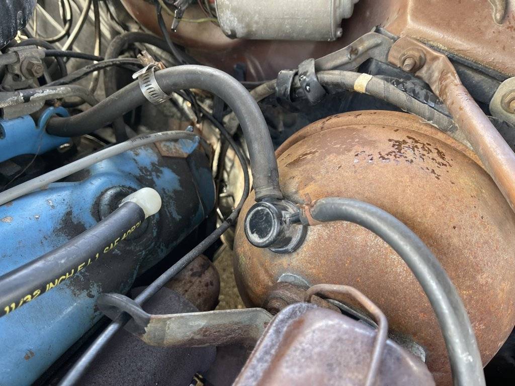

I swapped in the correct two nipple check valve. I will be adding new hose to the booster soon.

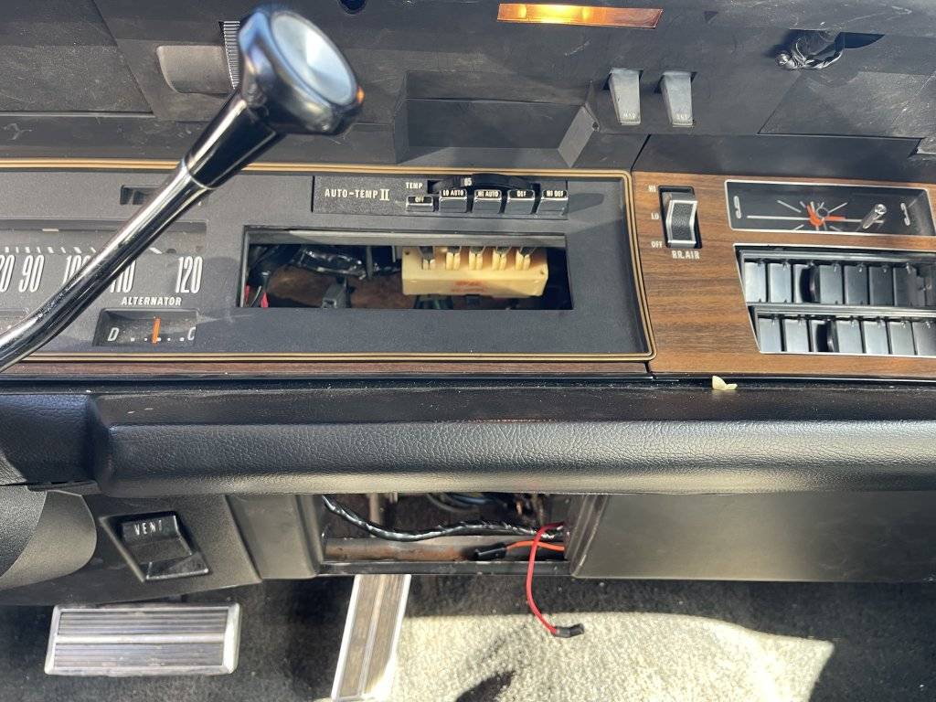

Continuing the diagnosis of the Auto Temp II, I have determined that the system is electrically 100% ok. I manually applied vacuum to the blower master switch and compressor master switch and everything started working.
I am trying to trace the vacuum circuits for the concern. Still diagnosing and repairing damage from the overlays.

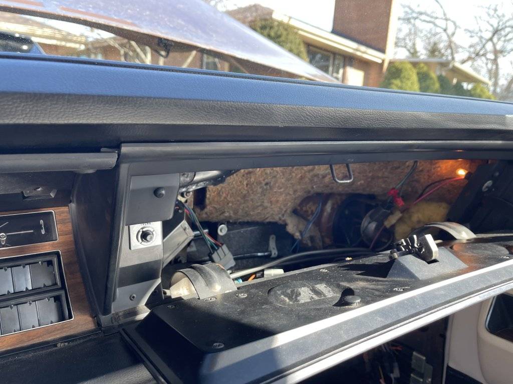

Cleaning up the dashboard after the previous owners paid a lot of money for half-assed work. The glove box liner was destroyed and ruined so I will replace that. The original speakers are long gone so now I need to make something work.
There were more Scotch-Locks, zip ties, self-tappers and extra wiring than a hardware store.

I haven’t done much pictures on it. It’s just following the manual and understanding the description and operation of the system and following diagrams.
The manual is the base you need to understand and fix it. But in my case(and I figure in most of our cars) the system has been messed with. It's bypassed and I've just a switch that is off/highest fan speed on hottest temp. I think many systems have been messed with since the original design was prone to fail. Sharing your experiences and progress gives others a better understanding how to fix stuff that's not depicted in the manual

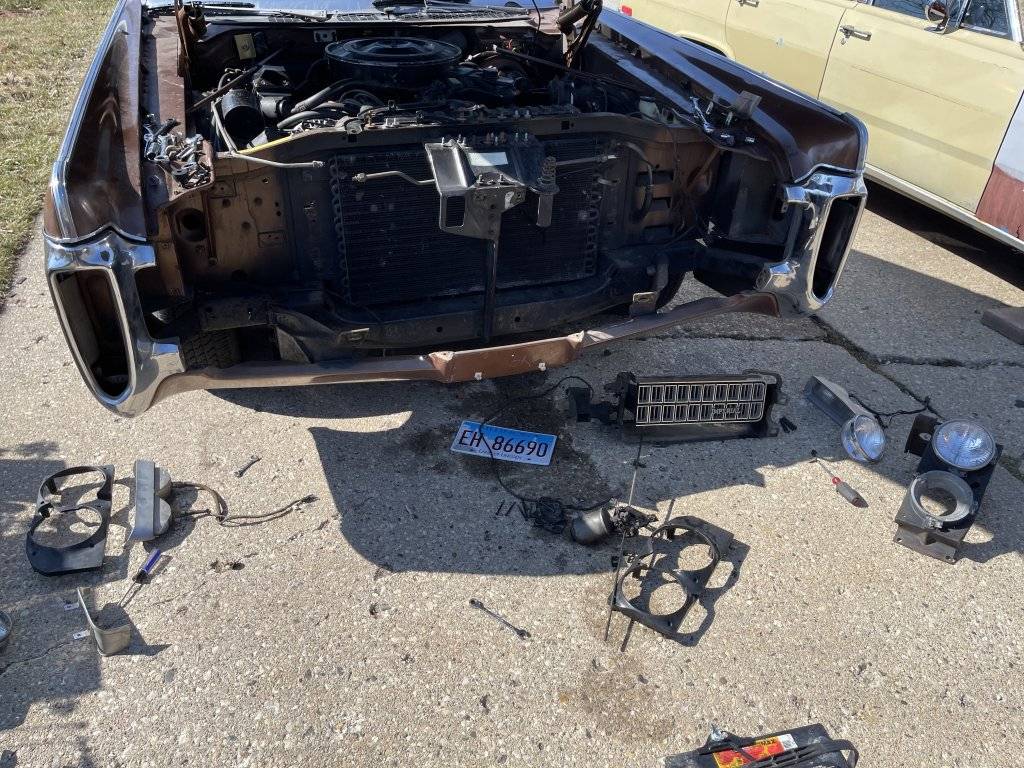

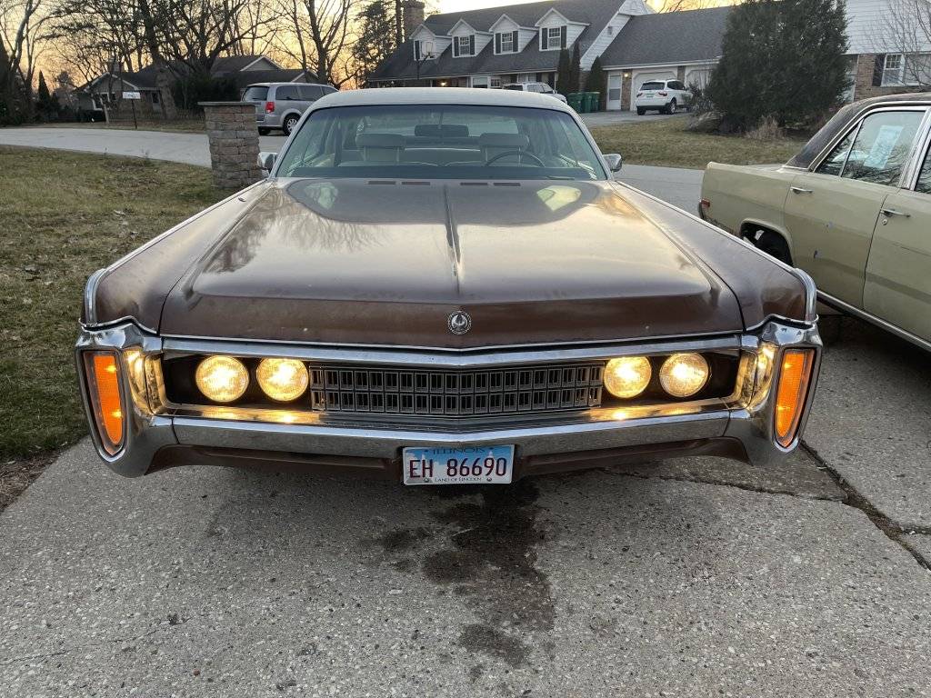

The seller said the headlight doors were binding and needed adjustment…sure they do…

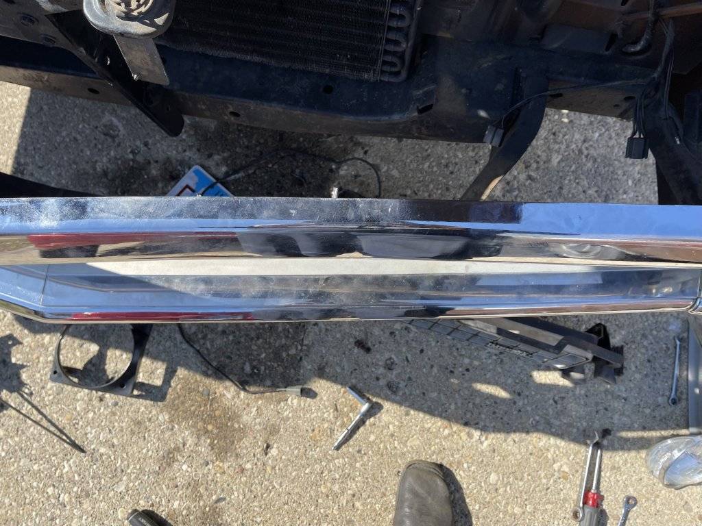

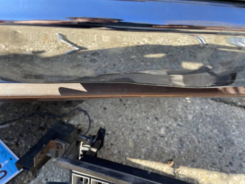

Some one was driving and hit something or the car was hit. Everything in front of the core support was damaged in one way or another, and of course a beautiful pit-free grille is bent.
I sacrificed the grille and bumper centers out of my other 72. Now I will either replace that one or get this grille fixed and use it on my other 72.

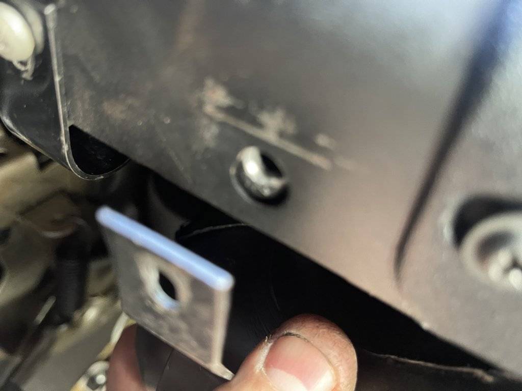

The stupidity of people never stops amazing me. The moron who installed the overlay and toggle switch drilled out the mounting hole for the air duct screw that connects the heater box to the driver side spot cooler.

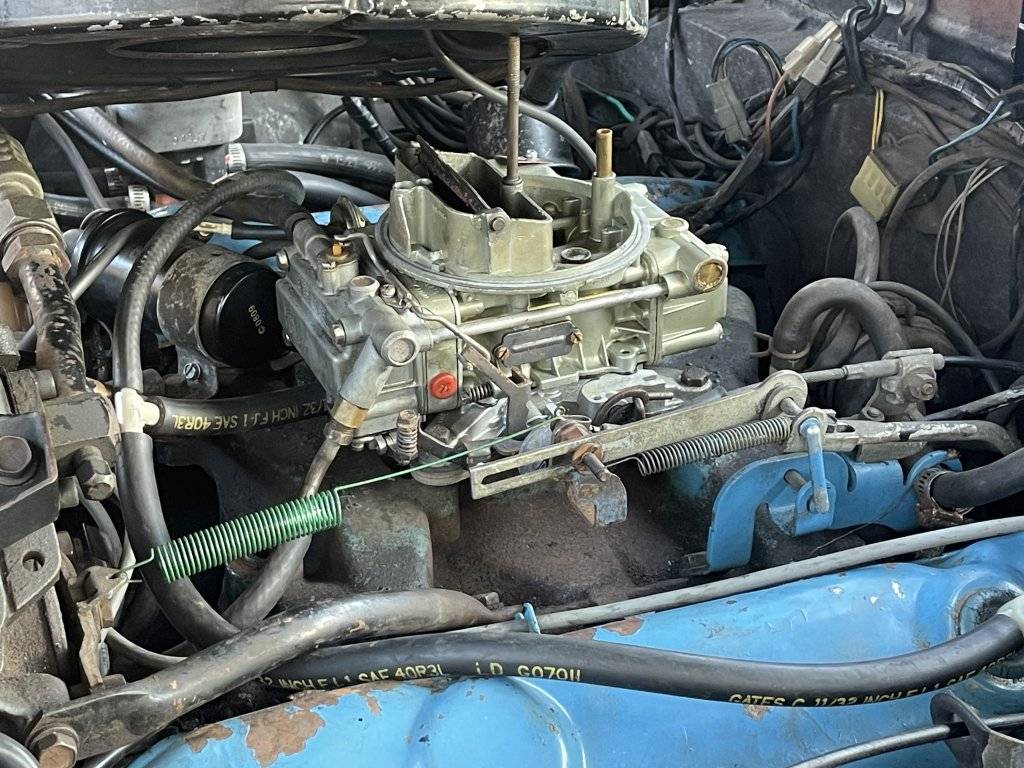

So I’m not letting the neighbor caused accident fiasco bring me down. I got the Carter AVS swapped off the car and got the Holley 4160 on. It seems to run much better actually. It has a roar to it with the secondaries opening that it never had with the Carter.
The fuel line was butchered to get the Carter adapted, the choke was swapped as well and the person who did all this reused the original 50 year old gasket which was dried out badly.

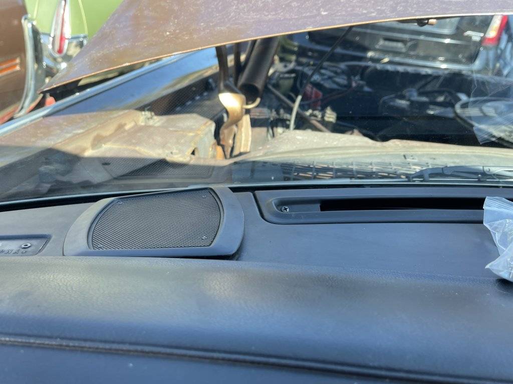

I got the original radio in and working, but the speakers are still a mess. They have been butchered. I need a 4”x10”, 2 6”x9” and 2 of the small round ones.

Small ones should be 3.5" round.
