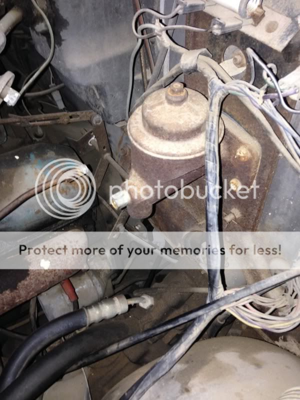

The difference between the two styles of master cylinders is, the single piston, like what you have, powers both the front and rear brakes from a single reservoir. The dual piston has a dual reservoir, and the rear portion of the master cylinder powers the front brakes, and the front section powers the rear brakes.
the nice thing about the dual piston, or dual circuit system is that the front, or rear system can bleed down and not technically be functioning, and you will still have the other system, be it the front or rear, still working. All this in theory of course. With the single piston set-up is the master cylinder fails, then you have no brakes at all.
