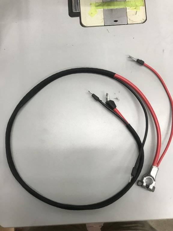

Bill Evans provided the 69-70 cable. I will get specifics as to vehicle it was off of. Send samples to Quirey Quality design

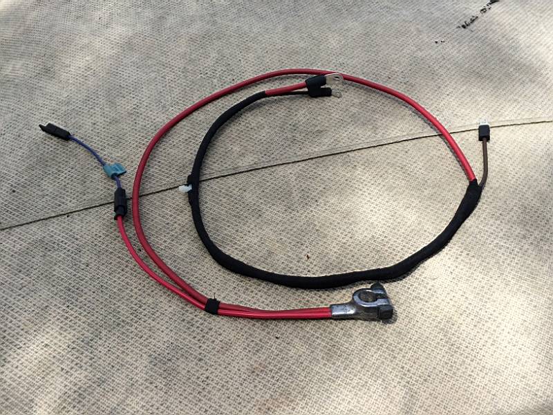

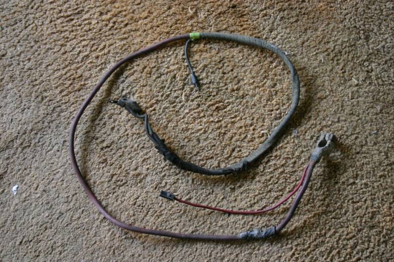

I looked at my (3) 69 Chryslers and my (4) 70 Chryslers and they all appear to be the same. But all of them have fuseable links too. So MrMoparCHP's (Alan's?) cables do look correct to me while the ones from Evans that QQE has do not appear correct.

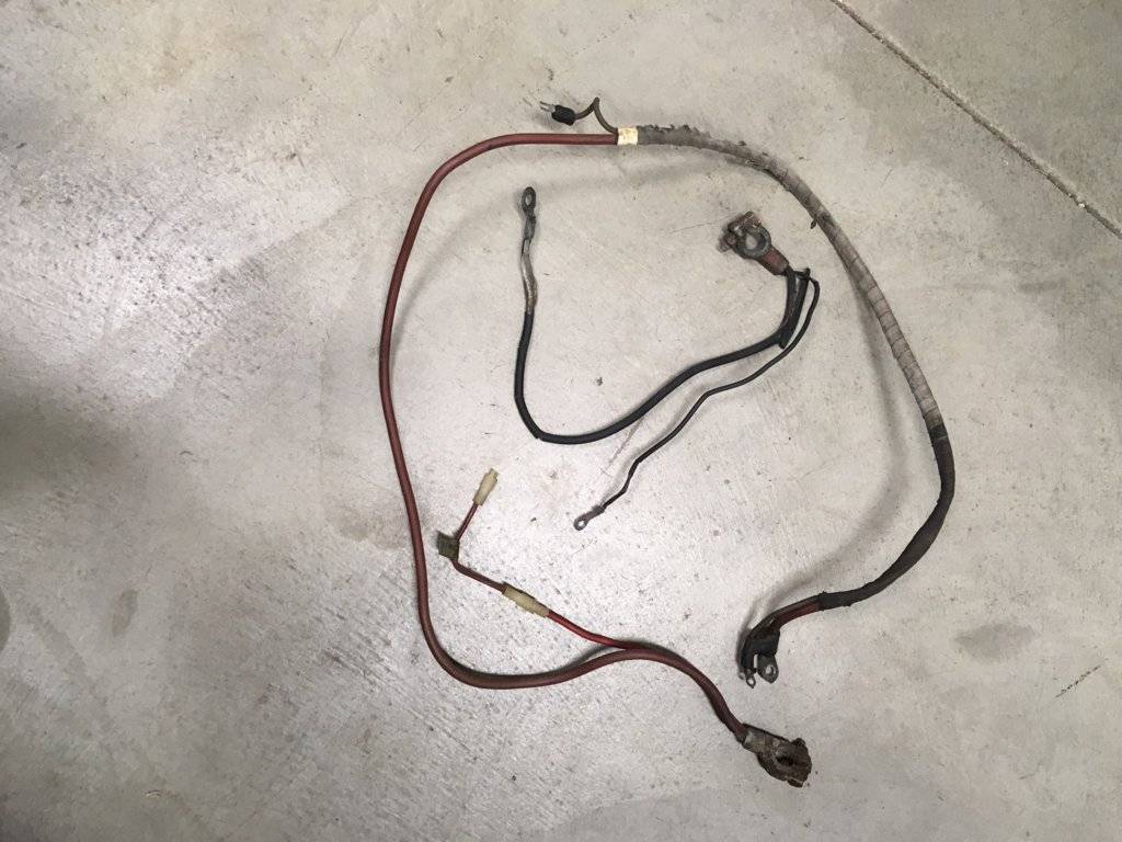

I also removed the all orginal battery cables from one of my 71 Chrysler 300s and I will send them to QQE this week for reproduction (photo below). They both look the same as all of my 71 C bodies.
Actually, in studying the cables that are correct for the 69 - 70 models above, it appears the positive 1969-70 cables are really pretty much the same as the 71-73 positive cables except that the fuseable link terminals are quite different. Since the end of the fuseable link that connects to the rest of the wiring harness must mate correctly, the 71 - 73 cables must have the correct fuseable link ends. The negative cable has a second ground wire for the 71s whereas the 69 - 70 negative cable is only the one negative ground cable. So this project should be pretty straight forward really since it appears only a change to the fuseable link connectors would be needed relative to the correct 69-70 cables and addition of one more ground wire to the negative cable for 1971.
