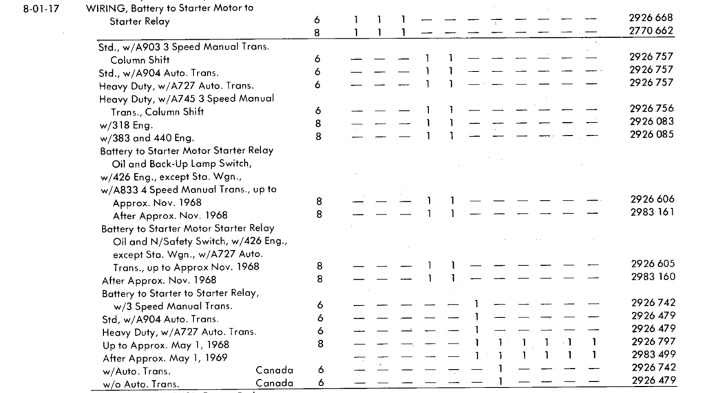

That is what thought as well, main difference is the location of a clip and maybe the length.Following up, Found this, attached. I'm guessing the up to May 1968 means May 1969?
Car was built March 18 1969, 318 is the SPD
Suspect 2926797 is the correct number, concur?
