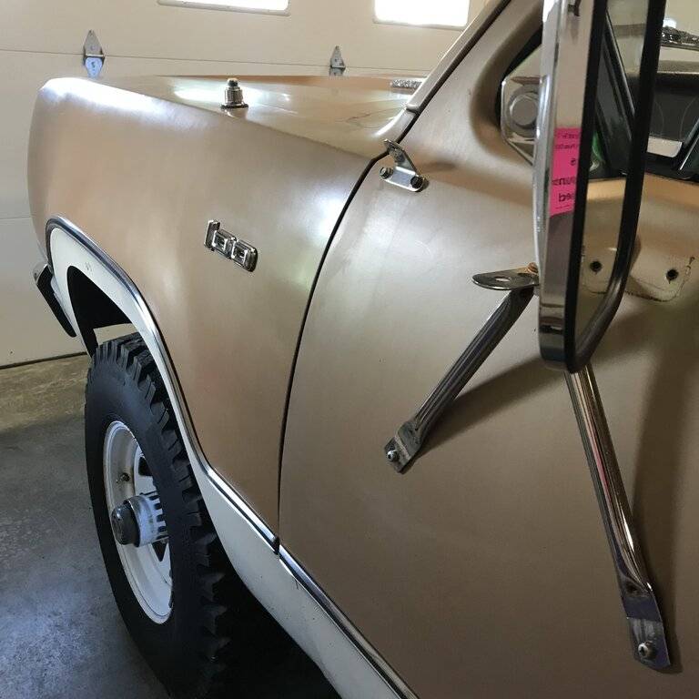

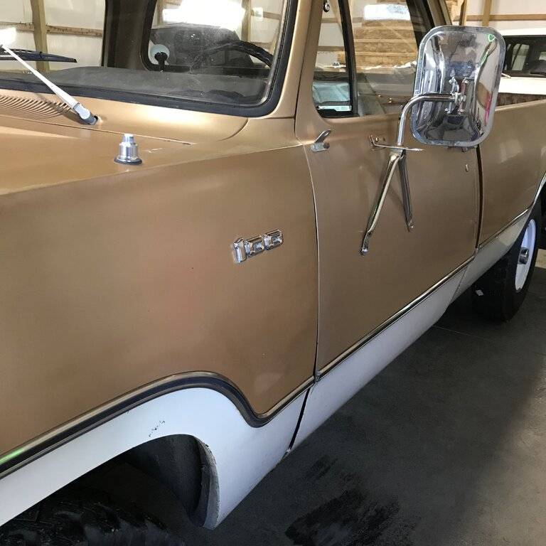

I did the comet wash to my ‘72 Dodge pickup. The paint is original, very thin and very oxidized. After the comet I used Meguiar’s Polish by hand, then waxed it w/Meguiar’s Gold. Not a huge, but definitely a noticeable difference/improvement. I don’t think much more could be done with this paint. It was a ranch truck in MT and I doubt it was ever washed, let alone waxed!
The VIP has much better paint and I feel the same procedure (maybe substituting the Comet with the clay bar) will yield better results.
Note- I did nothing except Comet the drivers door. The front fender was cleaned, polished and waxed. Contrast.

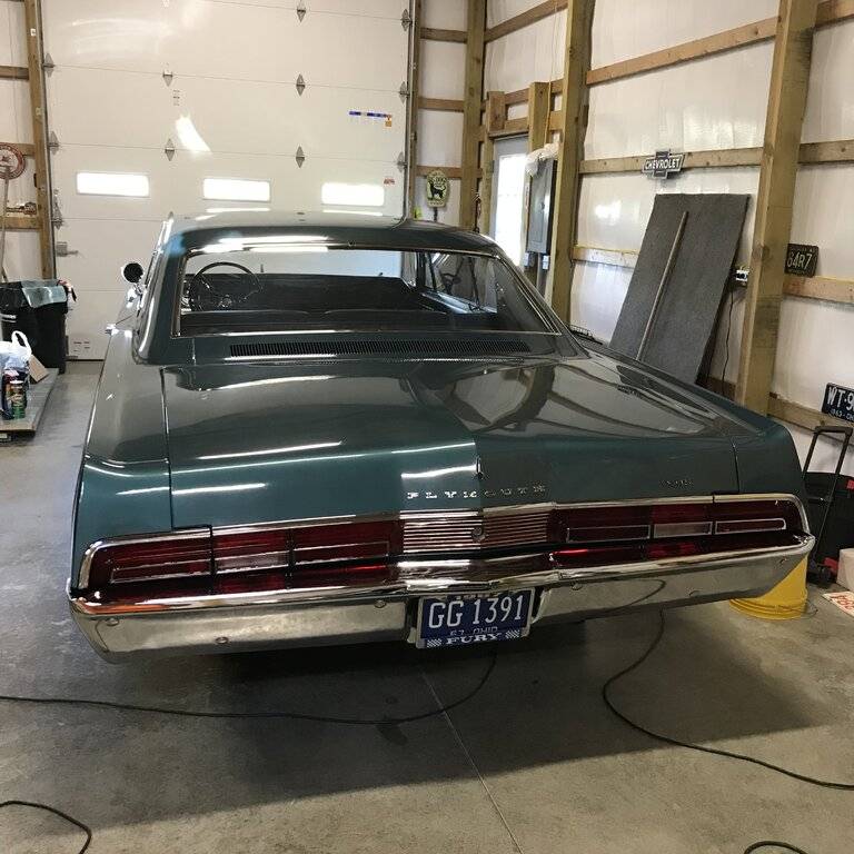

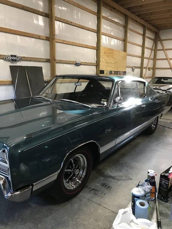

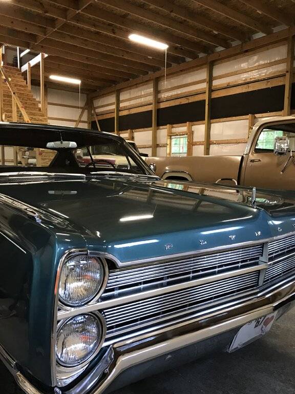

OK-Thanks to everyone who weighed in w advice on my precious Plymouth. I started out with the clay bar- good advice! I couldn’t believe how much ick was on/in the paint on this car. Using the ziplock bag on the surface before & after showed me the difference! Following that, I used the DA and Meguiar’s Ultimate Compound and the orange foam pad. I will wax it tomorrow w Meguiar’s Gold. Really pleased with the results. Virtually all the shadows and weird streaks/spots were removed. Plenty of dark turquoise paint removed on the pad as well!
I’ll get outside tomorrow and get some final pics once she’s all done. For 53yr old paint, it looks damn good-despite the factory orange peel!

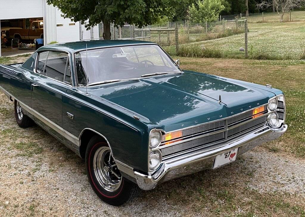

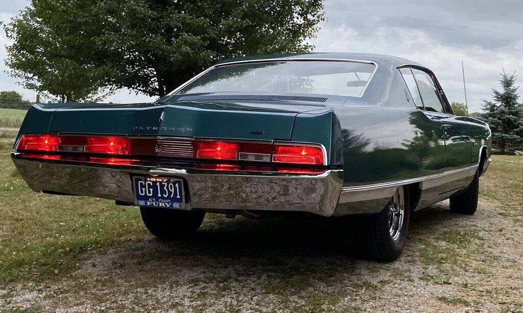

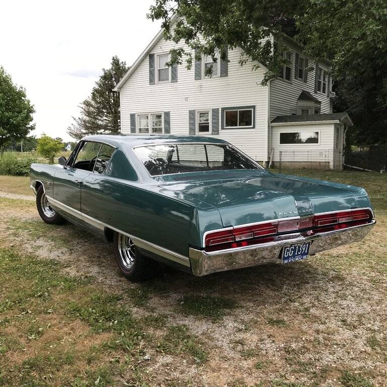

As promised-the end result. Lots of time and elbow grease but I’m as happy as can be with how she looks. I dare say she looks better than the day she rolled off the lot!
