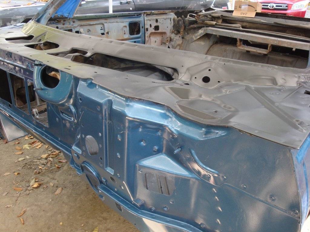

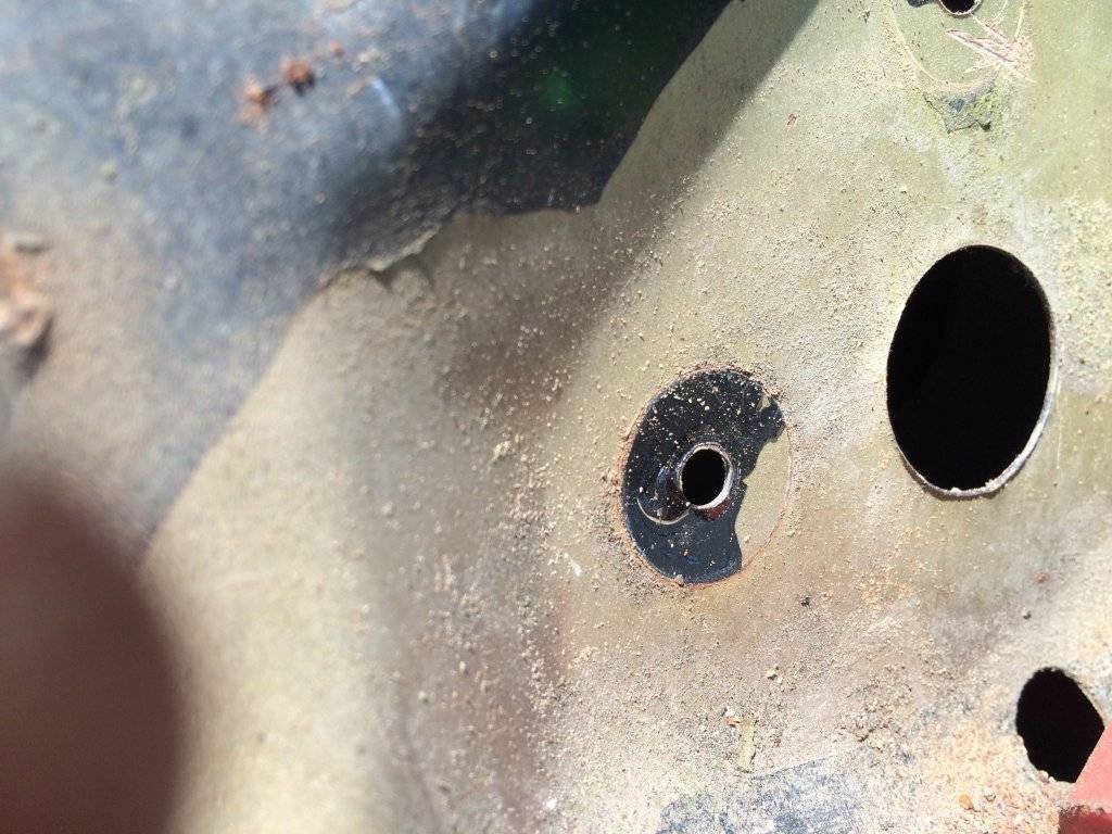

Just thinking out loud... Do you suppose the cowl was painted at the same time as the radiator support? That could open up a lot of possibilities for gloss as I think the requirement was "make it black and not too sloppy".View attachment 97860
Look at these closely. Under washer is Gloss, and on the edge where no elements it had a "gloss or semi gloss" look to it. Maybe you have to see it in person. I always assumed it was satin, but now I'm thinking semi-gloss.
I actually bought a can of dupli-color a few weeks ago and was going to use it on some inner fender areas. The color match is very close.No is a gm Color...believe is Bahama blue but looks pretty well the same...car will loOK killer with that blue....keep up the good work

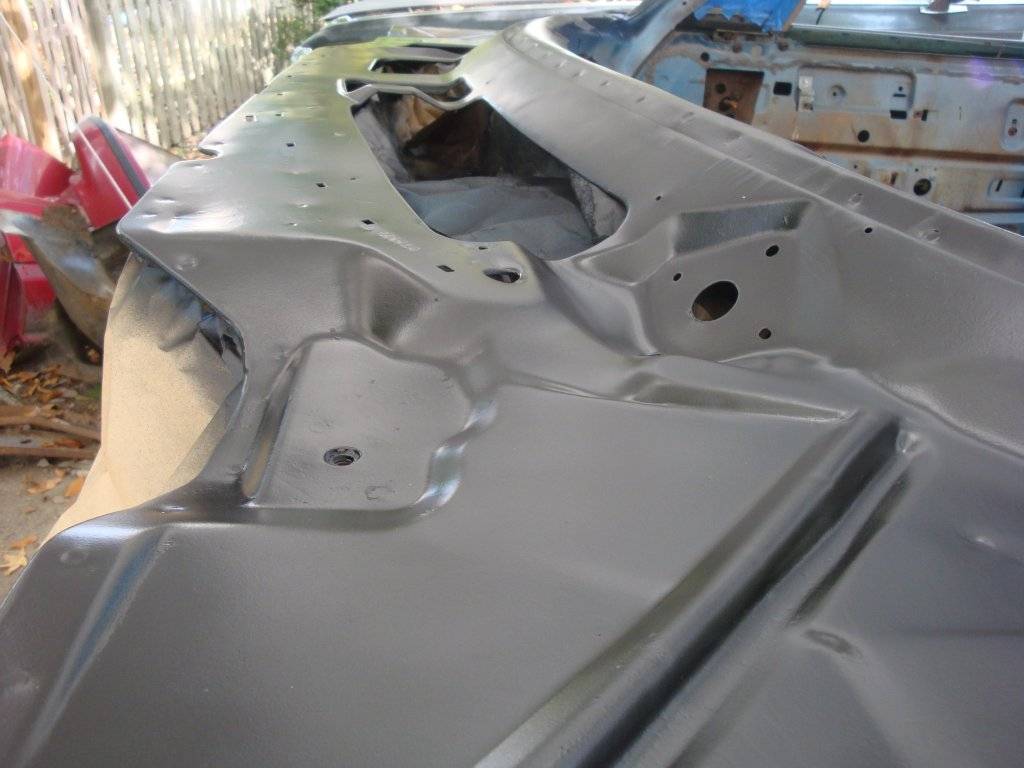

Thanks, Will!The cowl is not flat black, nor satin or semi gloss, (which does work OK).
It's a 70% gloss. Or gloss black reduced with a hardner.
Sometimes buffing a semi gloss finish works well.

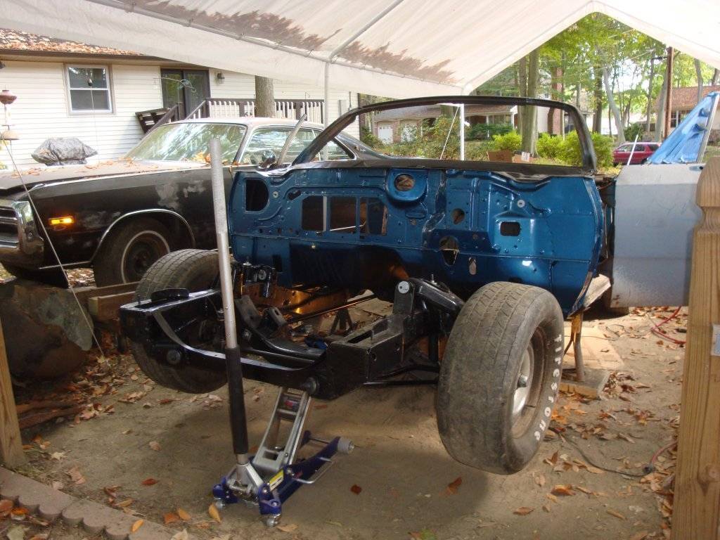

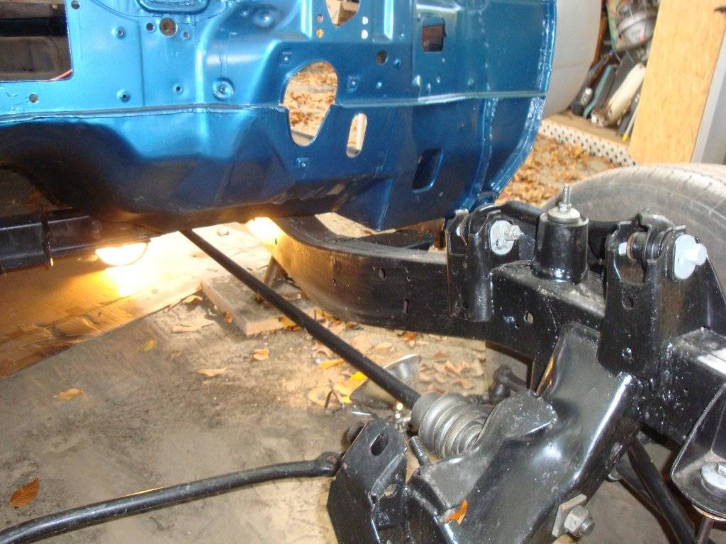

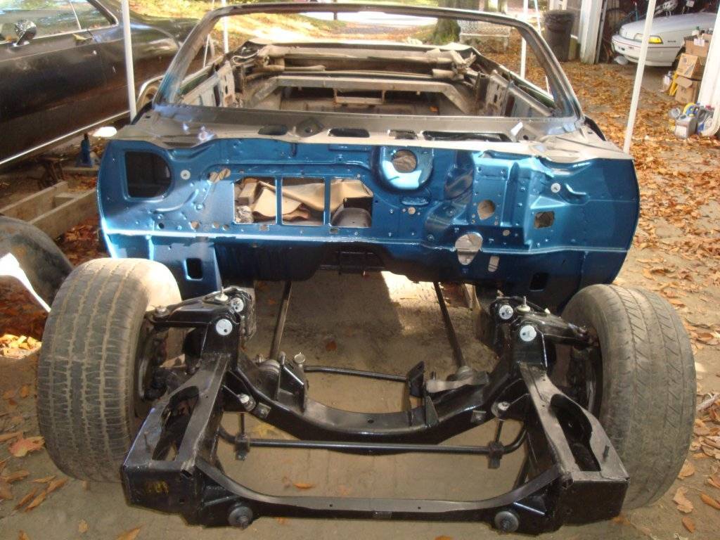

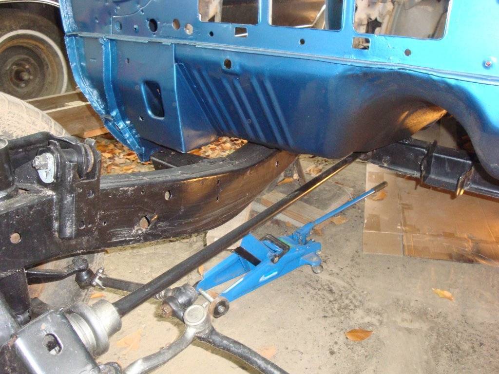

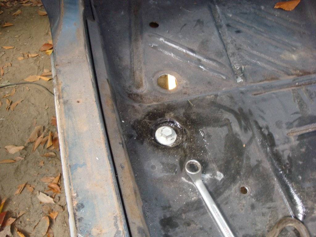

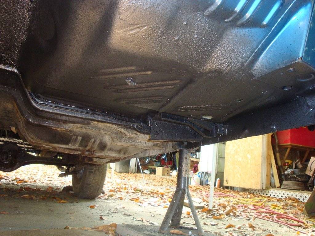

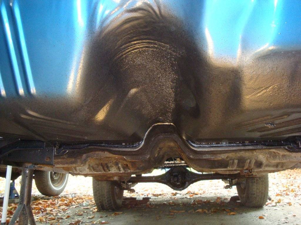

Just to round out the season, I needed to re-install the stub to get it all put to bed into the garage for the winter. It's not easy moving 300+ lbs of steel around the yard alone, lining it up and bolting it in place, especially after two years and not remembering where the bolts are or how many I needed.
Looks about right:
View attachment 98520 View attachment 98521
300 lbs of steel above my head: View attachment 98522

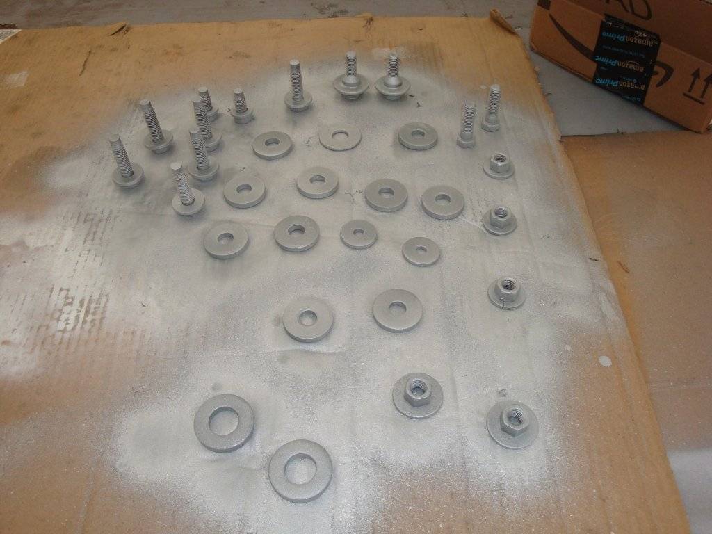

There they are! A little zinc coating for good measure. View attachment 98523 View attachment 98524 View attachment 98526
Reunited, how it feels so good:

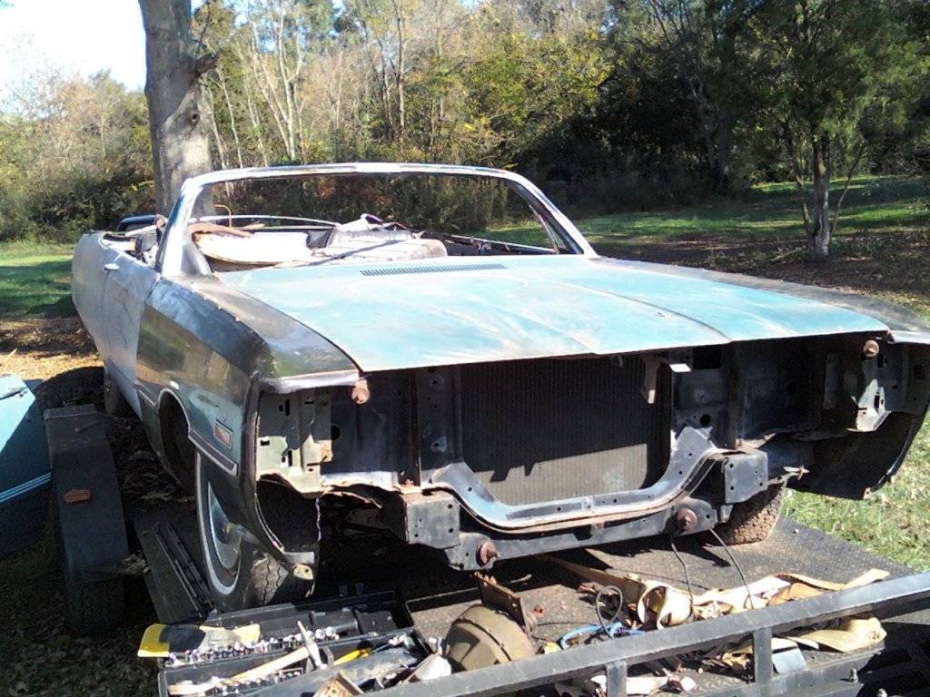

What a difference 10 years make:
Jim,
Glad to see some noticeable progress and it looks like the car will be ready for you to return to me soon. You do remember that it was just a loaner ..... Don't you? Besides, you're getting a little too old for that top down hair blowing everywhere kid stuff, you're more of a minivan guy now.

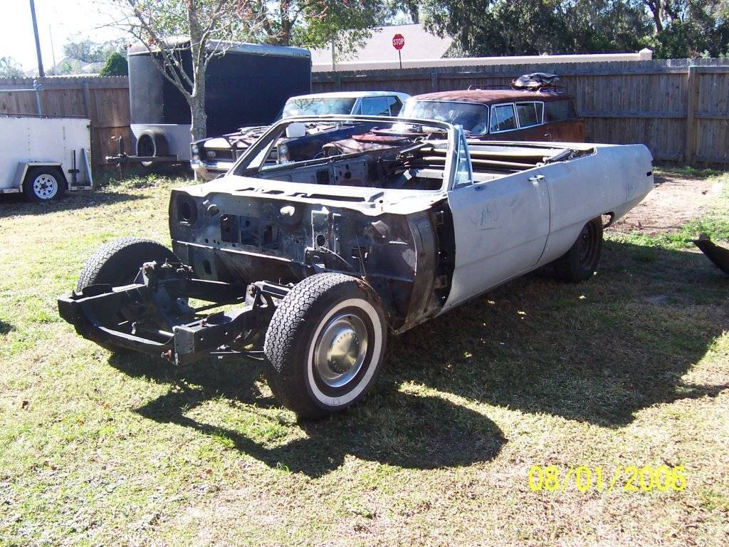

The picture of the car before I bought it is dated August of 2006, but I bought the car from the guy in Florida in February of 2006.
