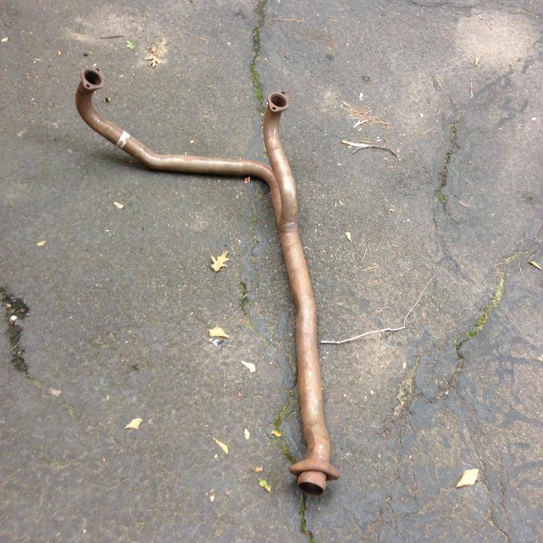

Happy Fathers Day Jim! A "Y" pipe is sure better than a tie any day, Nice find! I just replaced the dual set up on mine with the single exhaust about a month ago. Less power but much more pleasant to drive.

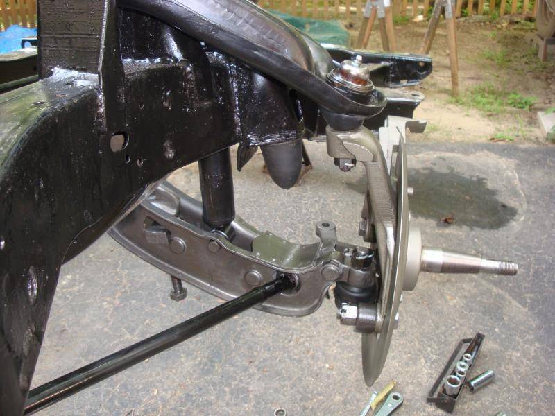

I tell my son, "leave the hammer in the tool box". So what does dumb dad do when he cant remove the strut rod from the lower control arm? Pick up the hammer of course. Only a second or two mashes the threads nicely. Lets spend more time fixing poor judgement. How do you remove the @&$! strut rod? That's just for future reference, now the the nut is back in place this one will stay put.

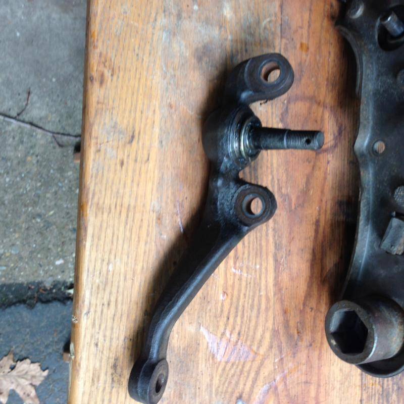

Finally got the steering arm and lower ball joint off the spindle. My guess is that this is much easier to do while the suspension is still mounted on the stub. Looking for lower ball joints now, are you telling me that these are only available as an assembly?

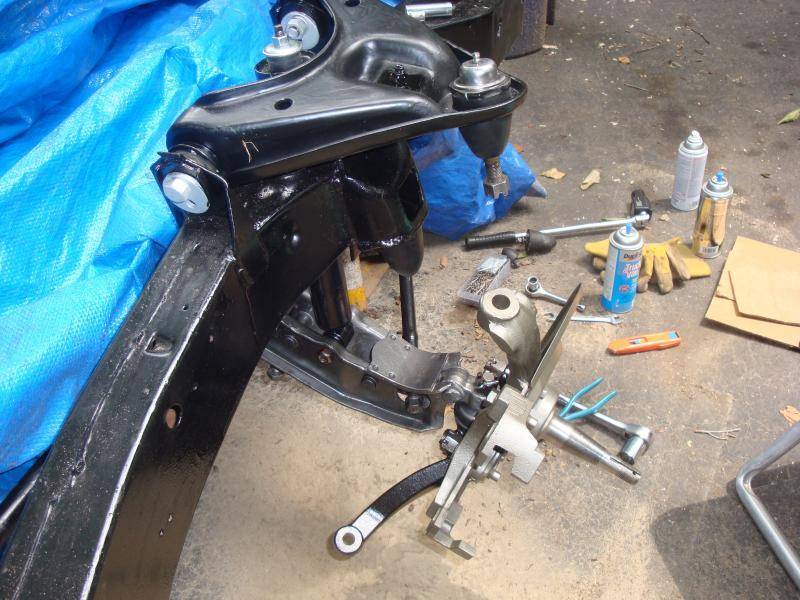

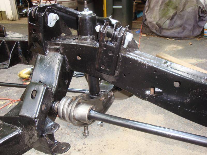

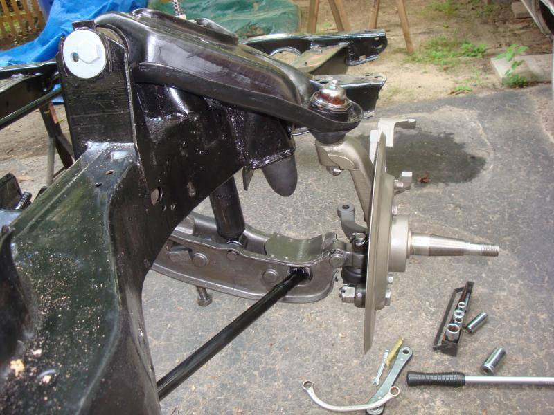

Last year I left off with cleaning up the stub frame from Alan "MrMoparCHP". This year I went through and blasted, painted and refinished all the components. I didn't have many full days to work on the project, everything was done an hour here and an hour there. Here are some before and after shots:
Almost too pretty to hide under the car:
Suspension Details
Upper ball joints had been replaced, but the boots were bad. Tie rods also looked good. I found decent replacement boots in the Dorman Help section of Auto Zone. New lower ball-joints were sourced from PST and Monroe gas-matic shocks from Rock Auto. All parts were wire-wheeled clean, painted with POR15 silver or black, re-greased and installed.

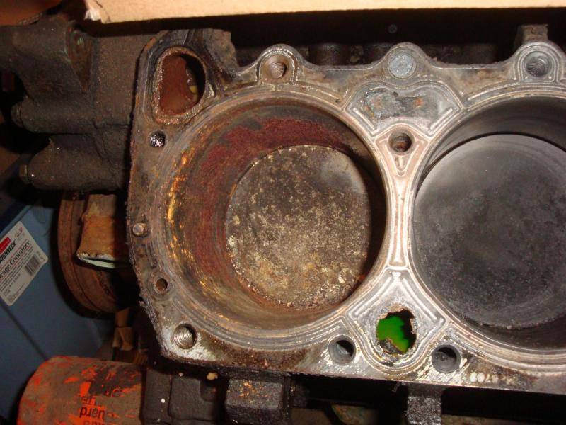

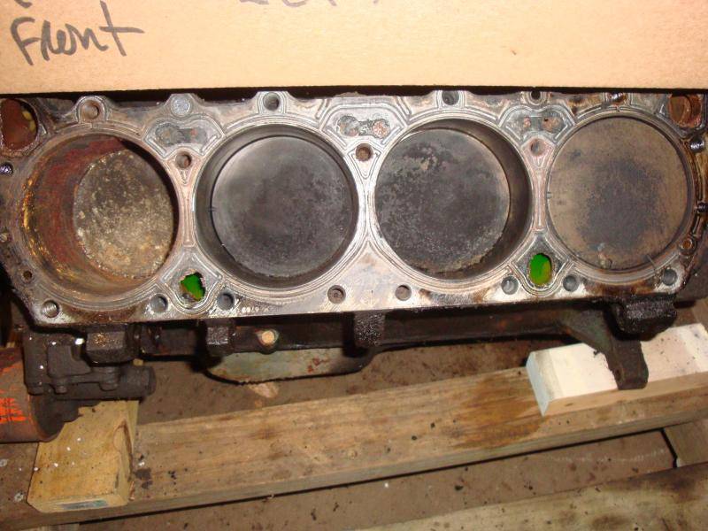

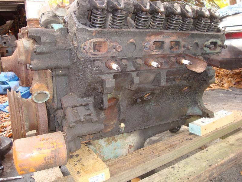

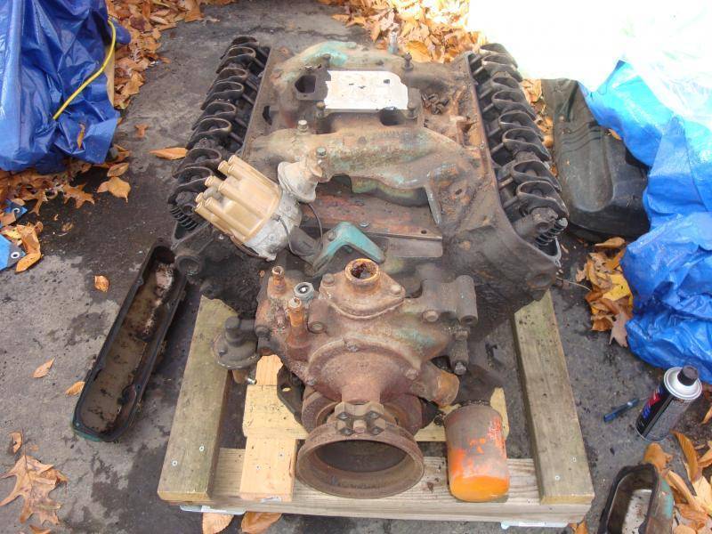

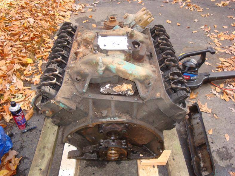

I removed the heads and prepared the engine for the stand. #1 is rusty, although the engine spins freely. All the other cylinders look worn. I had hoped to simply hone these and fit new rings, not sure if that is in the cards. The cam also looks worn, no bent push rods and the lifters all move freely. That three legged stand scares the crap out of me, but a friend of mine swears by it. He's built a 440, slant six and a host of small blocks with it. It's all I've got at this point so I'm giving it a try.
