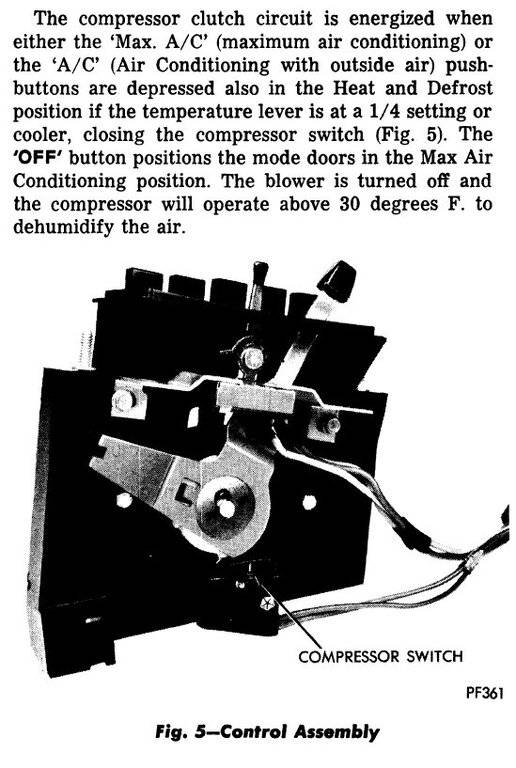

First off, most of my knowledge concerning Mopar A/C systems is not hands-on experience but is nerd wisdom that I gained through reading contemporary material. Like this April 1971 explanation of the ATC II system in the Master Technician Service Conference booklet series.

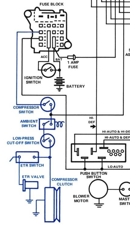

And yes, there was even a time delay to avoid fogging the windows when starting the engine and the A/C still being "warm". Here is a section of the respective wiring diagram showing the power supply to the compressor clutch.

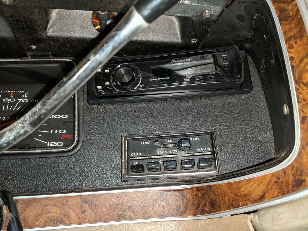

This is what my 1973 Dodge AC control unit looks like. I'm ignorant on this matter. Where and how would the 1971-72 switch install? Thanks, Ben
The difference is on the other side of the switch, behind the instrument panel. There is an added switch above the actual push button control behind the instrument panel. The front of the instrument panel would look the same as yours.

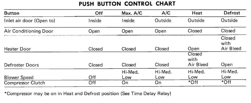

The following chart is from the 1971 shop manual. See last line for A/C comperssor clutch operation. The 1971 System still had the Time Delay Relay that Steve so rightfully mentioned.

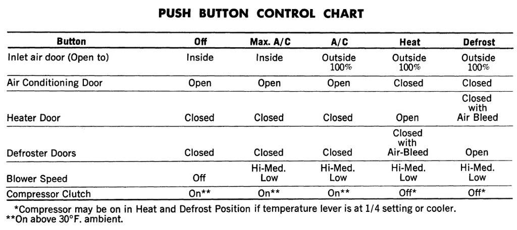

The following chart is from the 1973 shop manual. See last line for A/C comperssor clutch operation. The 1973 System no longer had the Time Delay Relay but featured a new switch attached to the temperature lever.
Yes, that is the switch I was referring to. Thank you ceebuddy for posting this!!
