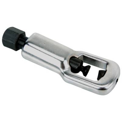

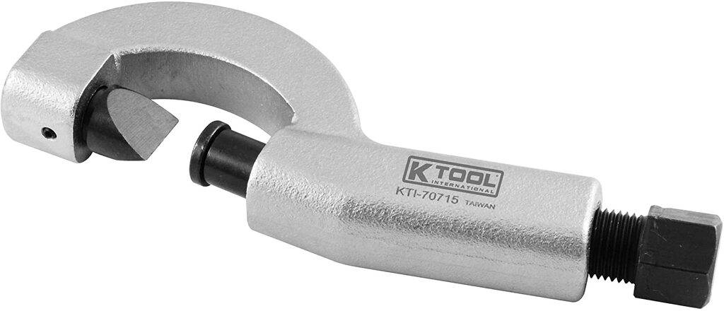

Get yourself a nut splitter and crack the nut in half.Hi Big John. Need advice.
If they're going to bust the rear shackles, how do I get them off without busting them to put them on the new springs? Thanks, Ben

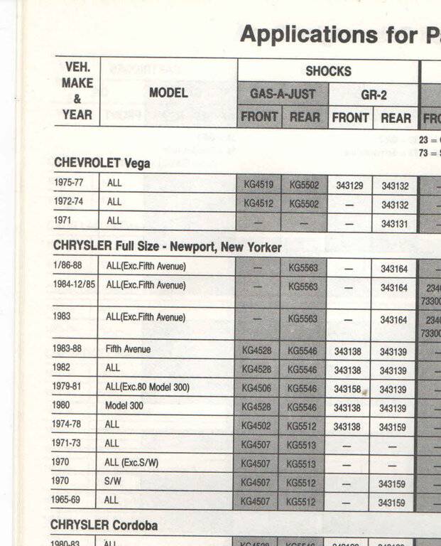

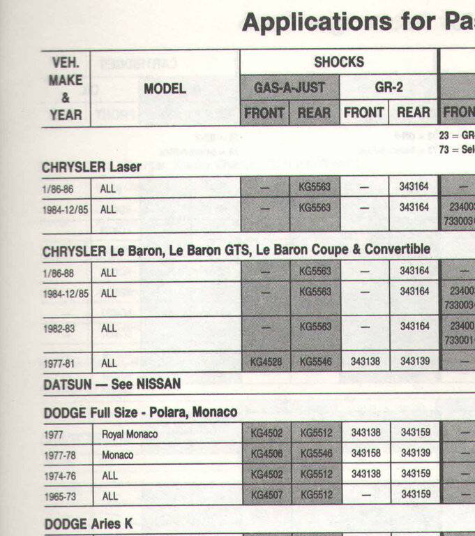

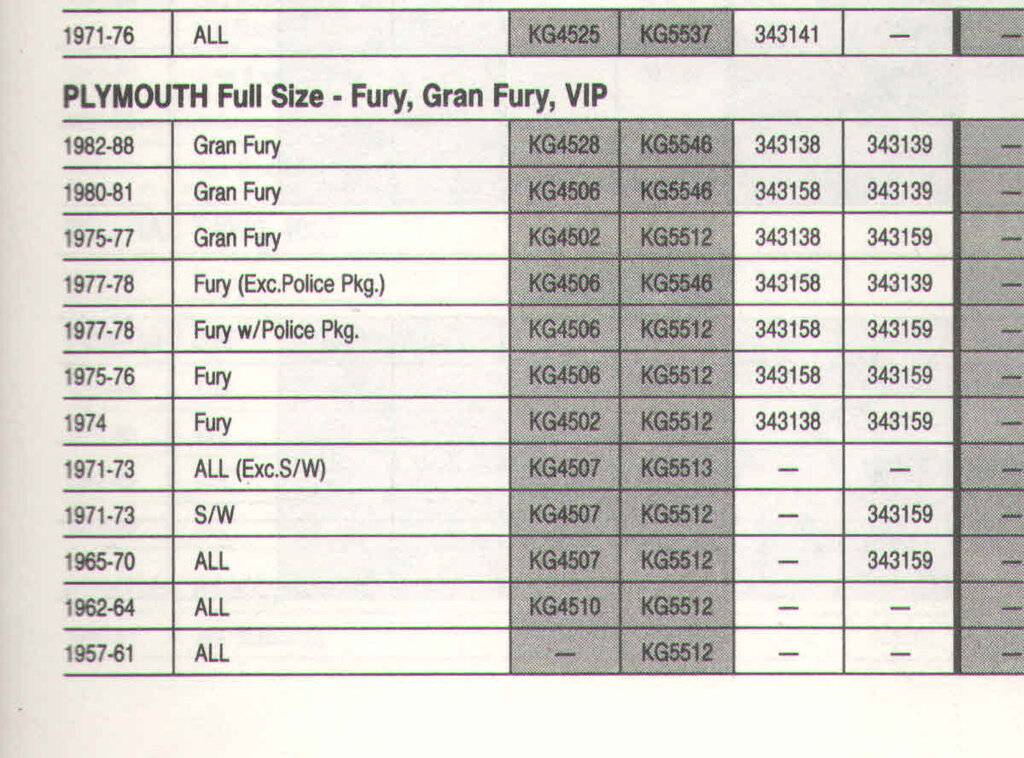

I have a 1972 Plymouth Fury. I bought some old NOS Monroe's off ebay, but would like to do something else. You are right about 25" clearance. I measured approx 25.40". I bought a 1988 KYB paper catalog off ebay. KG5512 fits all c-body Dodge, which is why they work for Michel. However, KG5513 is listed for your 1973 Navajo Newport and my 72 Fury. KG5513 is a discontinued part#. Unfortunately, the tables at the rear did not give extended and collapsed length on the (New Part# for 1988) KG Shock line. I think Chrysler altered the rear subframe for Chrysler 1970-1973 and Plymouth full size 1971-1973, but left Dodge alone. Not sure if Bilstein has an application for 71-73 Chrysler/Plymouth full size and at $240 per pair, expensive.
For anyone who is interested these are blowups of the pages from the 1988 catalog. The cut off columns are for struts and cartridges, inapplicable.
Hey! Thanks a lot for digging up all that info. Very illuminating

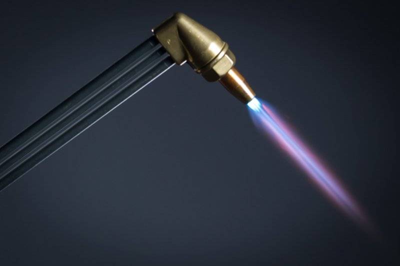

The worst are ones that will not budge with 1" impact, heat to bright orange with 1" impact now that's a stuck nut.
