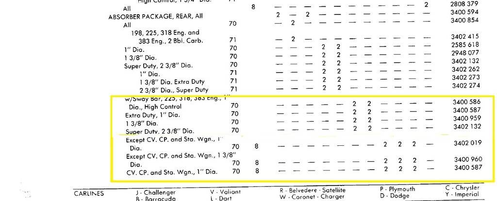

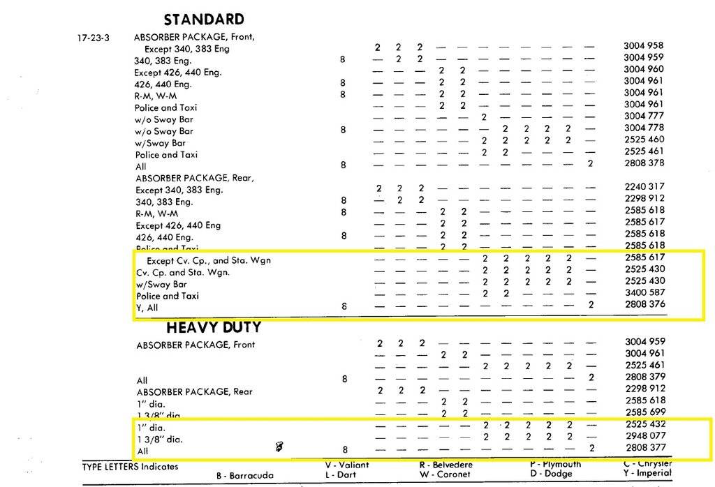

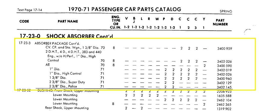

First 2 are from the 70/71 parts manual and third pic is the 69 manual
Some part numbers repeat between vehicles. Differences (if I'm correct) in suspension would be the rubber mounting on some of the 70 and 71 models. That wasn't done on the convertibles and station wagons and all the '69s, but I really don't know what others had them and what didn't.
3400587 repeats between all 3 years and I believe all those cars listed do not have the rubber mounting.
340019 repeats between 70 and 71 and I think those cars have the rubber mounts.
"Extra Heavy Duty" on one vehicle translates into "Standard" on others, which I've found is typical Chrysler.

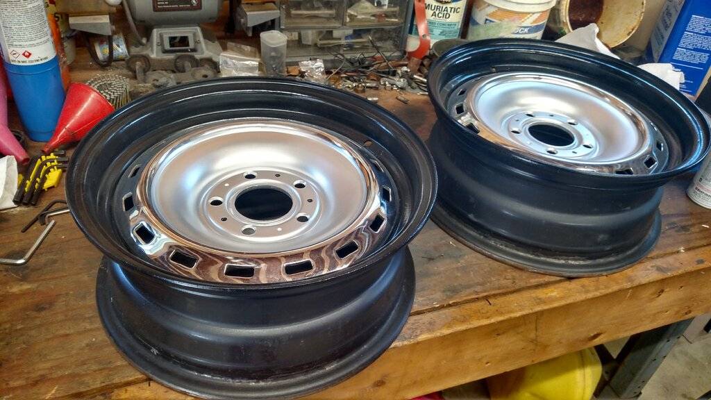

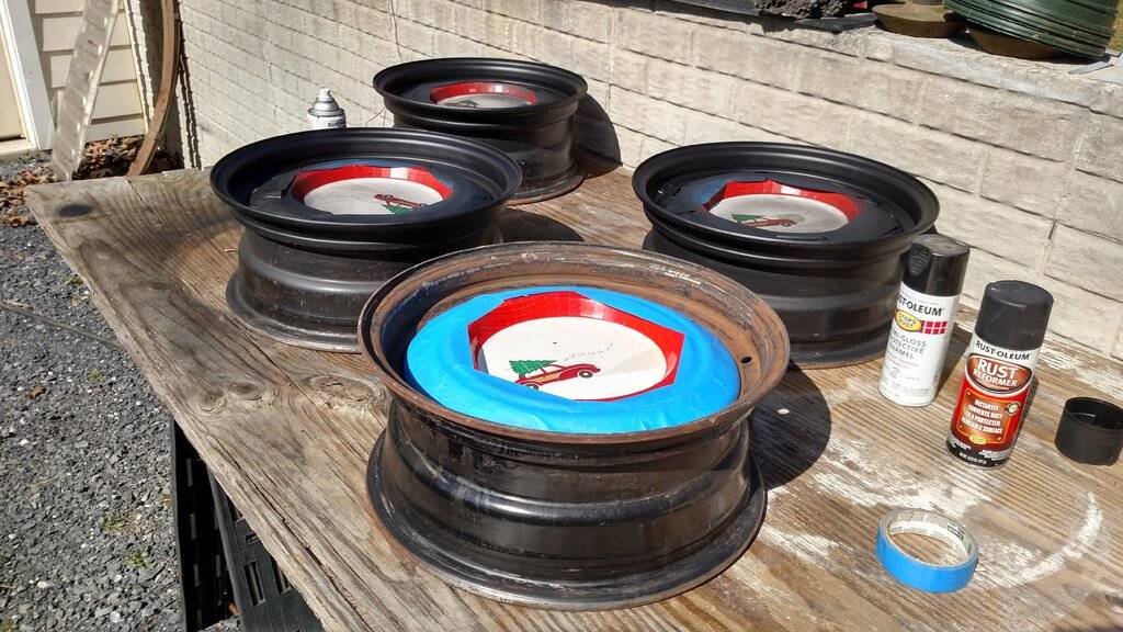

Its been no secret that I've been looking for a set of Chrysler Road Wheels for my Navajo. I don't HATE the wheels that are on it, but the car really needs Road Wheels. Thanks to (@sixpkrt) and @ayilar) I was finally able to put together a full set. One center cap is incorrect, but everything else on the wheels is good to go. I took (@71Polara383)'s advice and followed his procedures to do a refurb of the wheels:

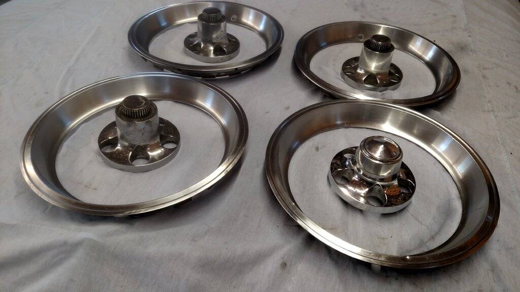

The trim rings and centers were a problem that @aiylar solved for me (Thank you! Thank you!):

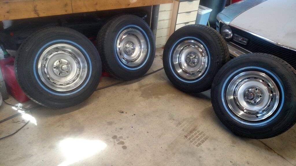

And here are my Road Wheels in all their refurbed glory:
When I get 'em on the Navajo, I'll post some more pictures.
Its been no secret that I've been looking for a set of Chrysler Road Wheels for my Navajo. I don't HATE the wheels that are on it, but the car really needs Road Wheels. Thanks to Tim, I was finally able to put together a full set. One center cap is incorrect, but everything else on the wheels is good to go. I took Wyatt's (@71Polara383) advice and followed his procedures to do a refurb of the wheels I got from Tim:
The trim rings and centers were a problem that Michel solved for me (Thank you! Thank you!):

Its been no secret that I've been looking for a set of Chrysler Road Wheels for my Navajo. I don't HATE the wheels that are on it, but the car really needs Road Wheels. Thanks to (@sixpkrt) and (@ayilar) I was finally able to put together a full set. One center cap is incorrect, but everything else on the wheels is good to go. I took Wyatt's (@71Polara383) advice and followed his procedures to do a refurb of the wheels I got from Tim:
Even the Rip, I see in one of your pictures that you have an Oddball center cap, which happens to be the kind from my 77. Would you be interested and letting it go?
