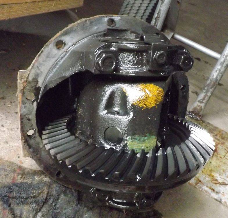

This is the new hogs head I'm putting in, same ratio gears and in very good condition, it is also a 489 case, strongest one to have. The old one is a 742 case.
[QUOTE="Wollfen, The old one is a 742 case.
That's odd. I thought all 69's with 8 3/4 axle used a 489. You think the 742 case was swapped in at sometime....?
So the new diff center is in plus new universal joint. I put new feet on the car too. Runs smooth again!
