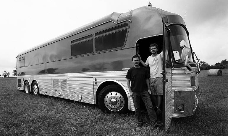

I seem to remember Waylon Jennings having an Eagle tour bus.
apparently ALL your braincells are still workin' -- more than I can say for myself at times :icon_smile:
http://www.pitch.com/kansascity/how...-legends-mid-70s-tour-bus/Content?oid=2191351
Waylon's 1973 Silver Eagle

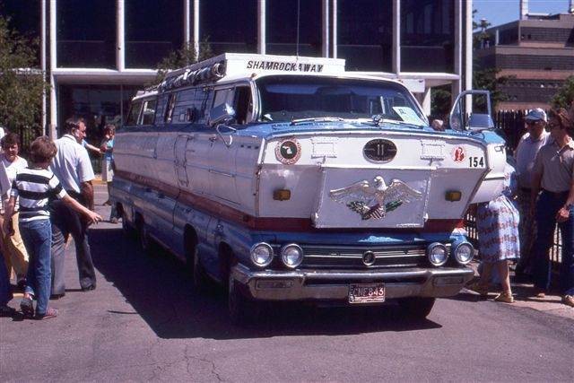

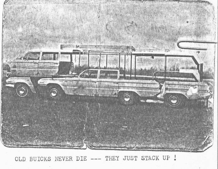

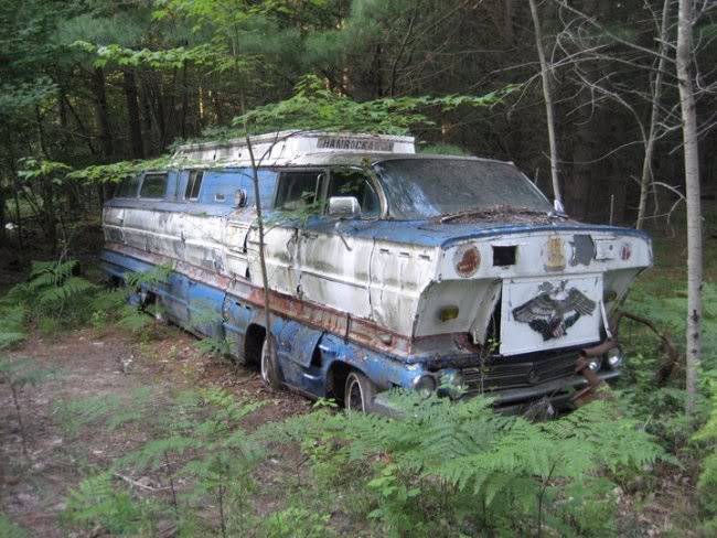

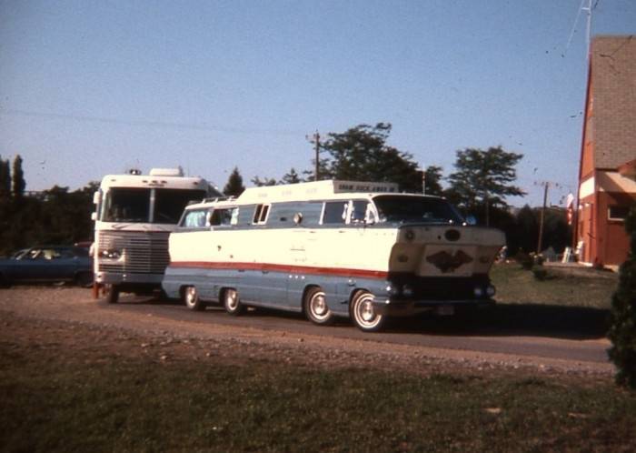

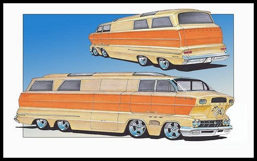

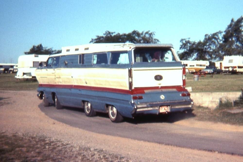

This is the time of year I always look around at buses. Found this. the ShamRock Away!
A homemade rig (looks like Michigan plate circa 1976-77), made from three 1962 Buick Wagons, single Nailhead 401-V8, almost 10.000 lbs, drive wheels third set from front, saved from a salvage yard and now for sale again, and last a drawing for somebody's vision for it (which I kinda like - kinda).
I am not considering it..just though it was interesting. I admire the creativity, but i dunno ....

I like the creativity and admire the fact that the builder had the tenacity to see it through... It is very hard to do a project of this size as a single person, I had help on days that I just couldn't do things by myself.

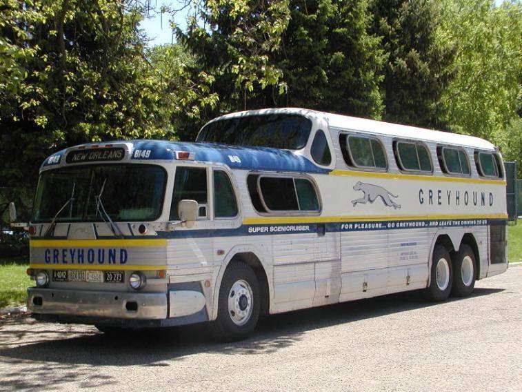

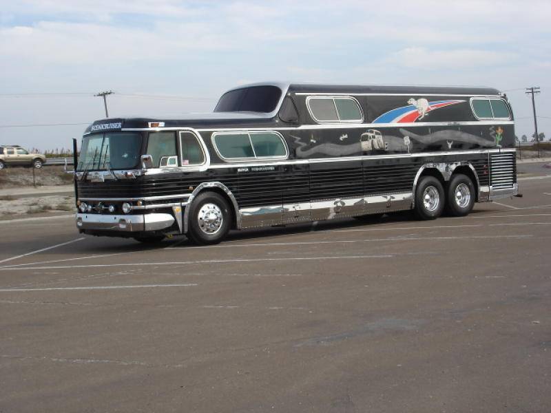

Within a decade, age 65 arrives at my door.
When I was 35, I decided that occasion would be marked with a major purchase and one year un-interrupted tour of the country. Then I figured I could get 10 years of usage before I was unable/unwilling to tool around in it anymore.
This is what I want.
Anybody own(ed) one? Know anybody who owns one? The perks? The pitfalls? Convert it? Buy one all done?
Thanks in advance to anyone for your thoughts.

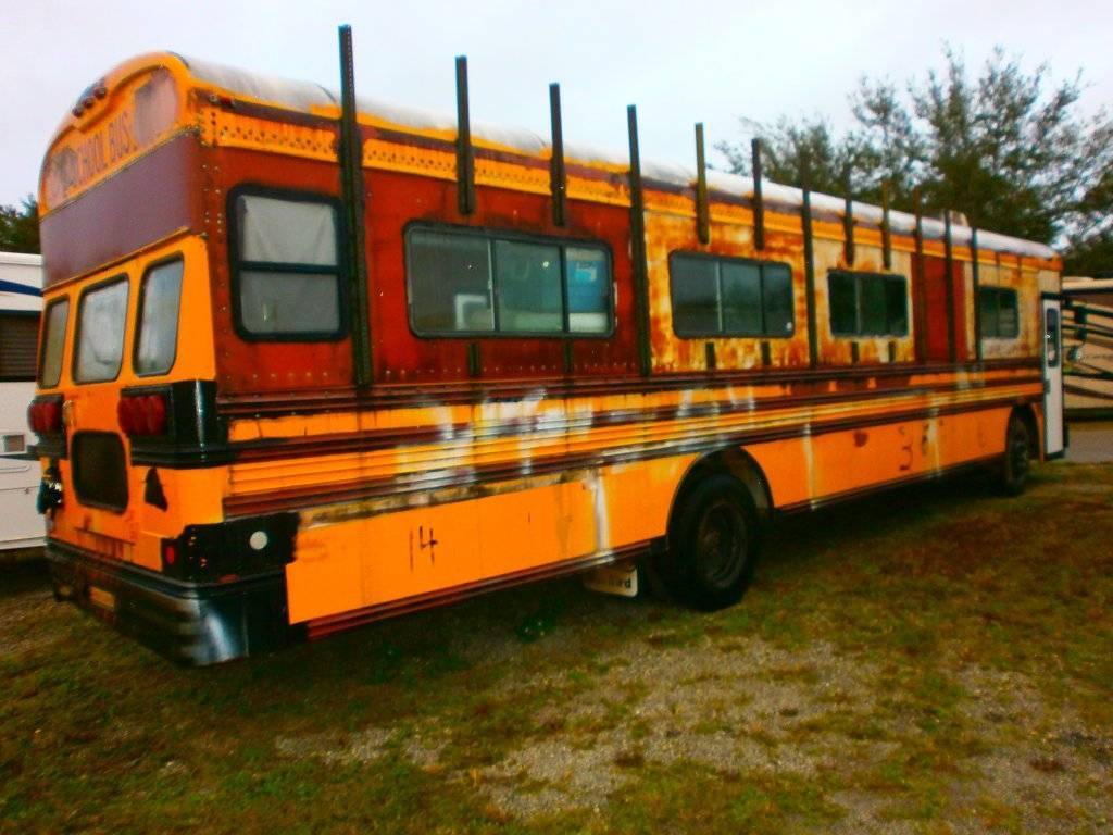

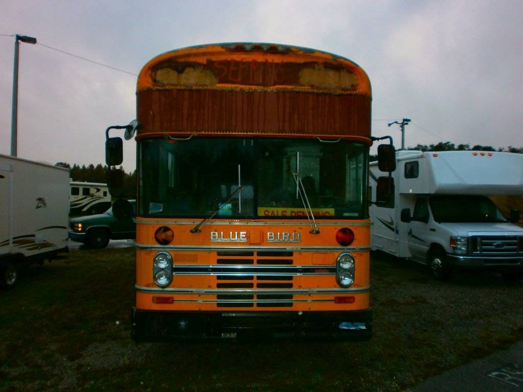

After all of my research and decision making process... I decide the most important things for me and my intended use. I planned for mostly going to the race tracks, being able to sit up top to watch. I wanted a spartan simple interior that would be easy to clean and maintain. I decided gas powered would better suit my use, long storage periods and easy to find parts when road trip breakdowns occur. Really didn't expect to do any mountainous driving. Except for city buses, which have no space underneath, none of the buses I liked were tall enough inside. Also if I ever went to an expensive infield... I didn't want some ******* with a prevost blocking my roof top view because of height difference.

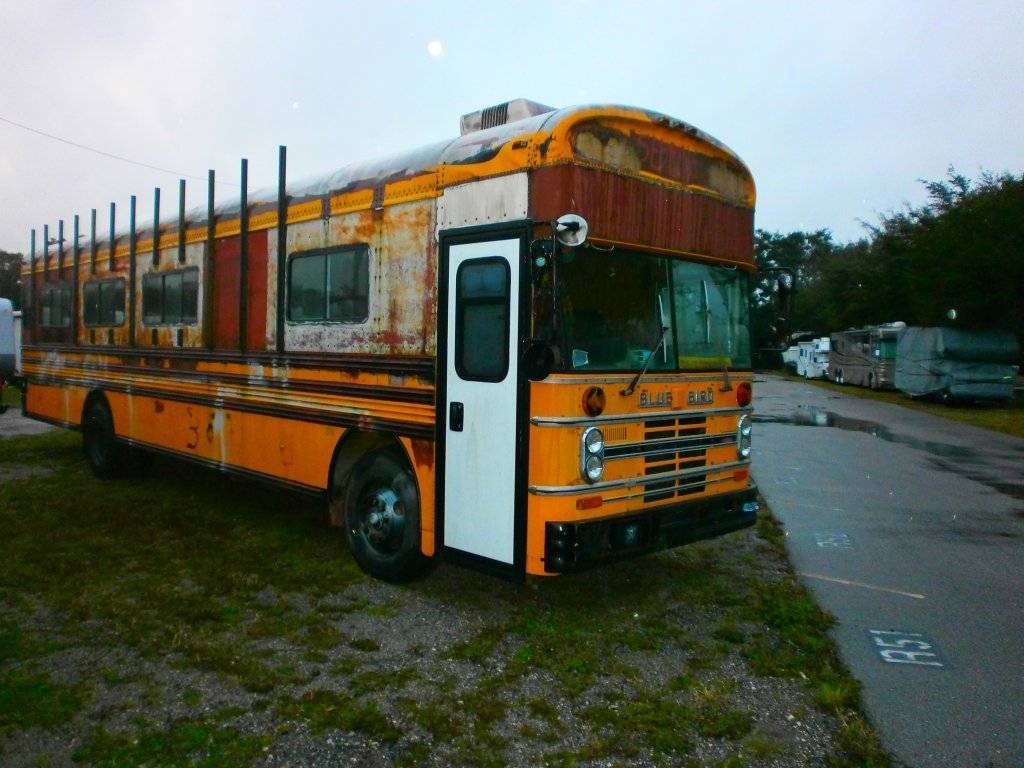

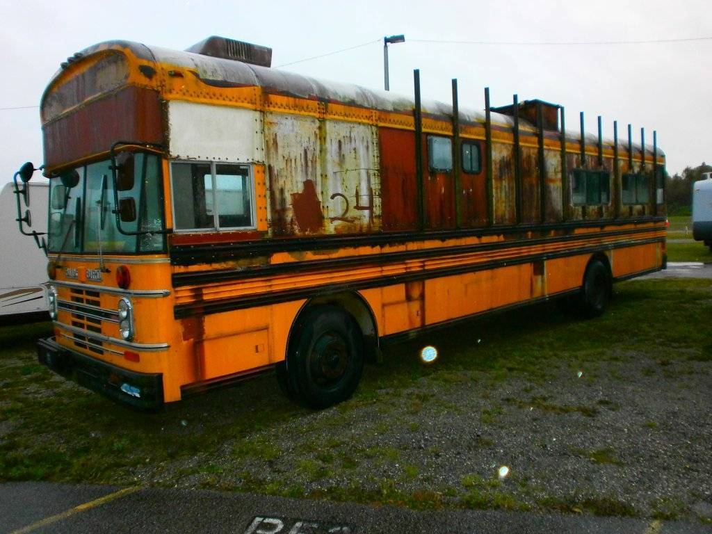

I found an 1985 Bluebird All American school bus. Similar front to the Wanderlodge, just inches shy of 40 ft (39+) and factory powered by a 427 GM truck engine(stroker, not vette)and Allison 4 spd.
I bought that bus in 2006. First order of business, getting the title work done... yes this was another of my tragic tales with FL DMV... But, It got transferred from GA to my name AND titled as an RV. RV branding was critical, it has air brakes and 34k gvwr... would need a CDL to drive it otherwise. The bus was built in GA and never went farther north... so very little rust, plus with galvanized steel construction... easy to work with. Aluminum school buses like Crown's would have taken me to more expensive materials and equipment to convert. The All American model was one of the most solidly built school buses ever. When ever I see a new school bus drive by, I look at the placement of the rivets. The Thomas buses I see have rivets indicating a full rib every other window... mine has a full loop every window (little less than 24" spacing).
Brought the bus home to the place I stored/built her. First order of business was removal of all interior sheet metal, side windows and seats. That was a ridiculous amount of work. Then I removed Exterior rivets at the windows and the lower roof. I biult a frame from 2x4s and used 6 screw jacks to cut/raise the roof almost 18". At each rib a 1" heavy wall length of square tubing was dropped in from floor to the start of the roof curve... I actually had to use big load biding straps to pull the roof down to set level. The tubing was shimed with flat stck and drilled/ bolted to the original hat channel that made up the roof. frames were made from sqaure tubing welded to angle iron for the RV windows that required the hat channel be cut. All of the interior hat channel (original) was backed up by an external hat channel (stop sign post) for the mounting of the roof decking. A roof hatch was fabricated so the access is from inside instead of a ladder allowing any drunken idiot to climb aboard, a little in field experience there. A 2" square tube was welded closed and bolted to the roof ribs from below... it runs the center of the roof most of the length of the bus so the decking has an attachment point, but also will never sag to the roof sheeting. The interior was insulated with foam and sheeted in bead board plywood.
Unfortunately, I stalled on this project several years ago. The amount of work I can put in during a day since my 2008 car accidents (rear ended twice, 5 disks in my lower back and neck damaged) and the never ending house remodeling/repairing took over. I lost my storage that allowed me to work on the bus at will (rest rooms, electrical... cutting, grinding, welding wasn't an issue... even had 220v), so now I would have to make a plan to move the bus to a location for work and back to storage at the end of the day. I could rent an indoor bay with electric (110v) and A/C... but it was a bit out of budget.
She still exists, I should be invading Highlands county with the unwashed masses this week with her... but life has given other priorities. Two of my friends who helped with the build have since drank themselves to death, my back injuries don't allow me to drink much anymore without paying a big price in pain for days afterward. The wife figured out that she doesn't really like camping, or the race track drunks, so she is out. I get a little excited about getting to a place where I could spend some time and energy and $ to finish her... but I don't see me getting the use I had hoped to out of her. The tires were old in 2006... 22.5" are not cheap enough to throw on a set for one trip a year... she has been to highlands county several times in the past.
Pics are from a few months ago when I started thinking if I should sell her, she is registered for another year and all told costs me $1200-$1500 per year in storage, insurance and tags. I won't recover my investment, so its mostly about reducing that expense.
