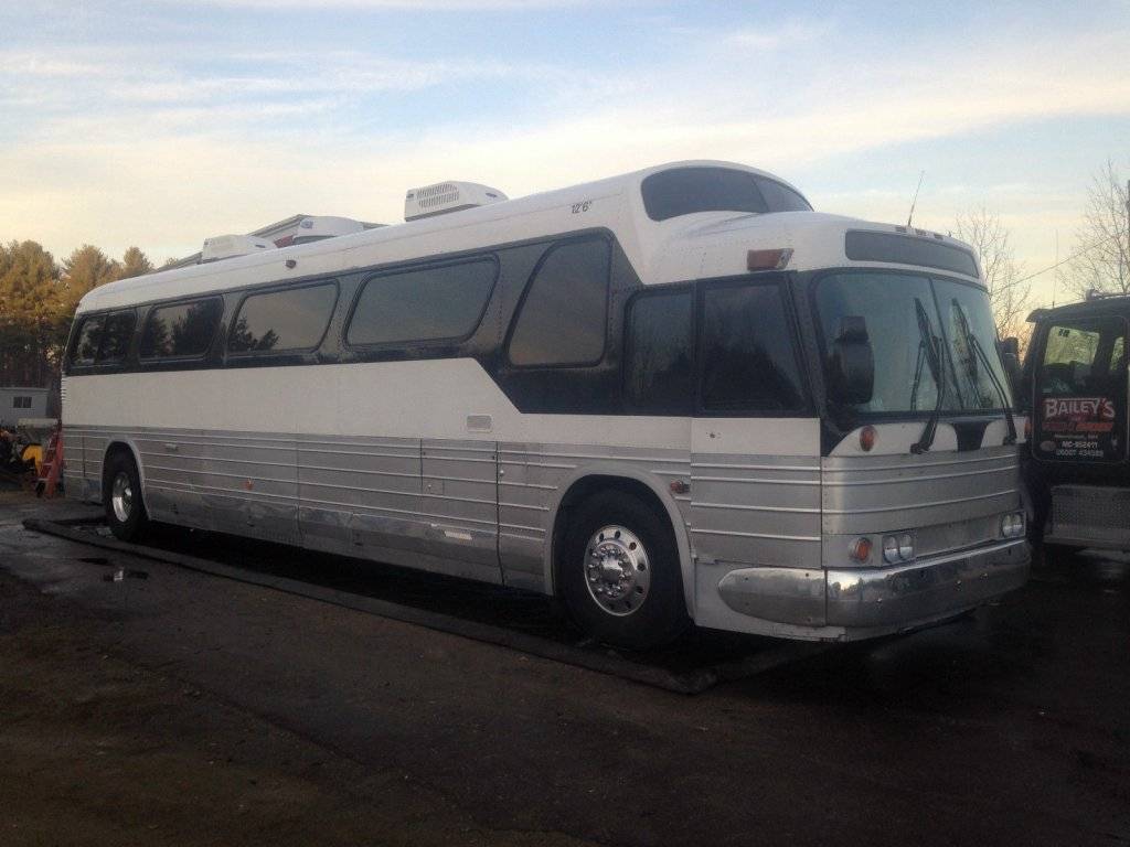

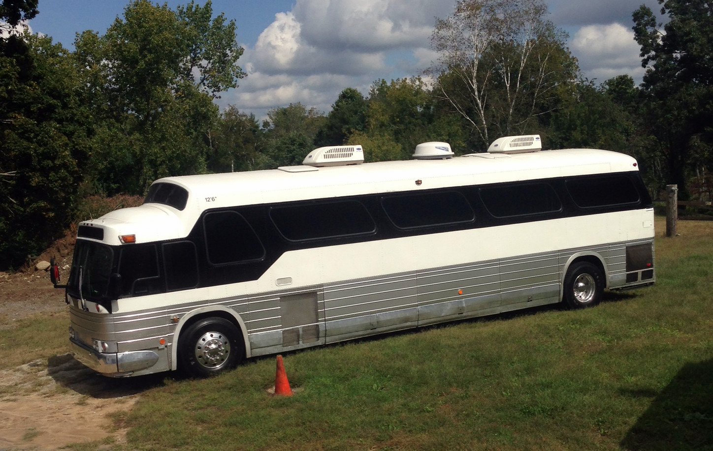

why the AC units on the roof? upgrade due to "preference" OR "necessity"
(OEM design does cut it, can't get parts, windows dont open, etc.?)
The OEM systems on the old stuff had a separate engine to drive the compressor, at some point I'm sure the manufacturers just took power from the main engine. Point is original systems only had to work when the bus was running. Conversions usually are for camping with shore power available and a generator when not... the availability of the roof tops and that they are the "normal" RV equipment is why they are done so often. There are some conversions done with split A/C systems which are common enough... It hides nicely, but requires a little thought to install cleanly. Regardless of how, a conversion needs an electrically powered A/C and a road bus would be engine driven.
