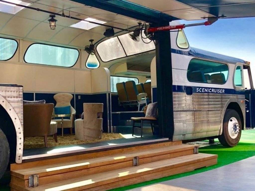

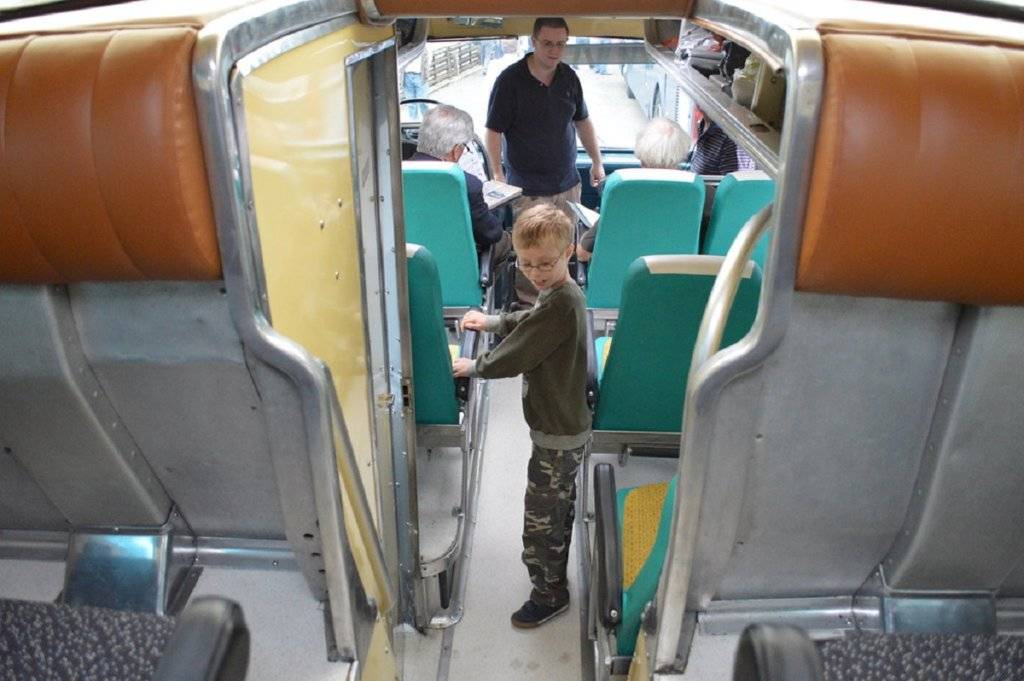

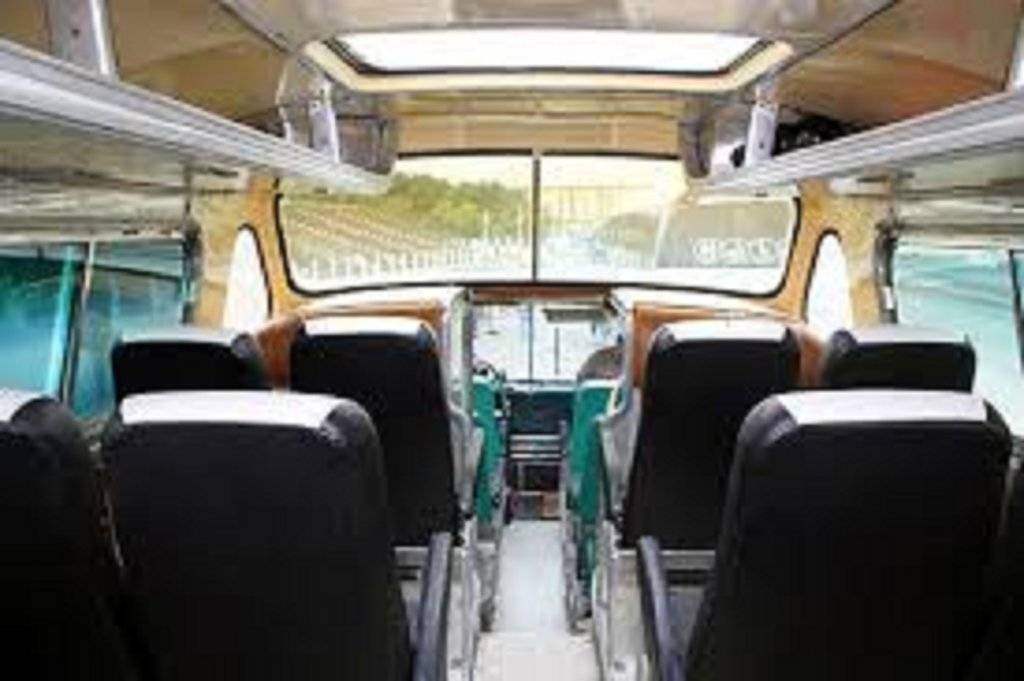

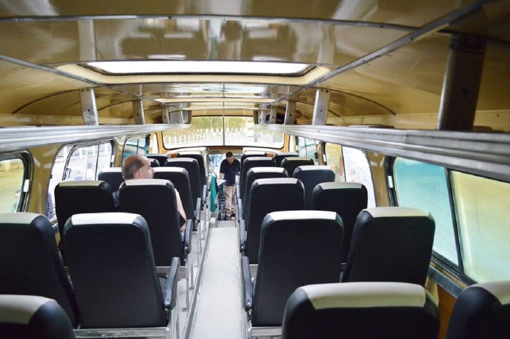

This is NOT my bus, but this view from upper deck looking forward is what I wanna try to preserve. I wanna see OUT the iconic panoramic upper deck windows with as little obstruction as possible.
Also, these pictures show a BIG decision I need to make. More on that in a second...
Same view in original configuration

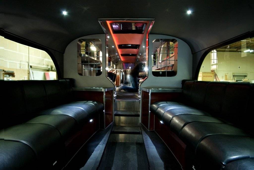

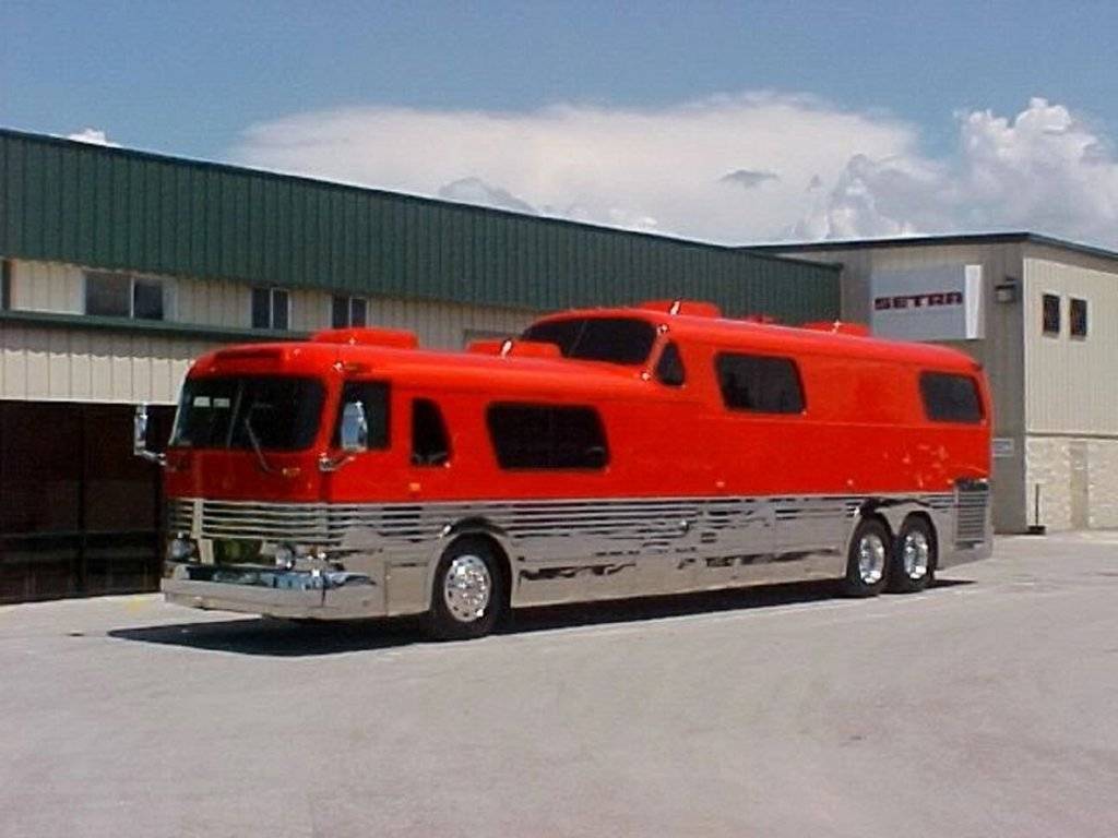

btw, this is how the Red Bull guys dealt with this view .. and how they dealt with my BIG decision.
OK .. my BIG decision. Actually no drum roll needed. I am not going to do it ... it has a $25K price tag.

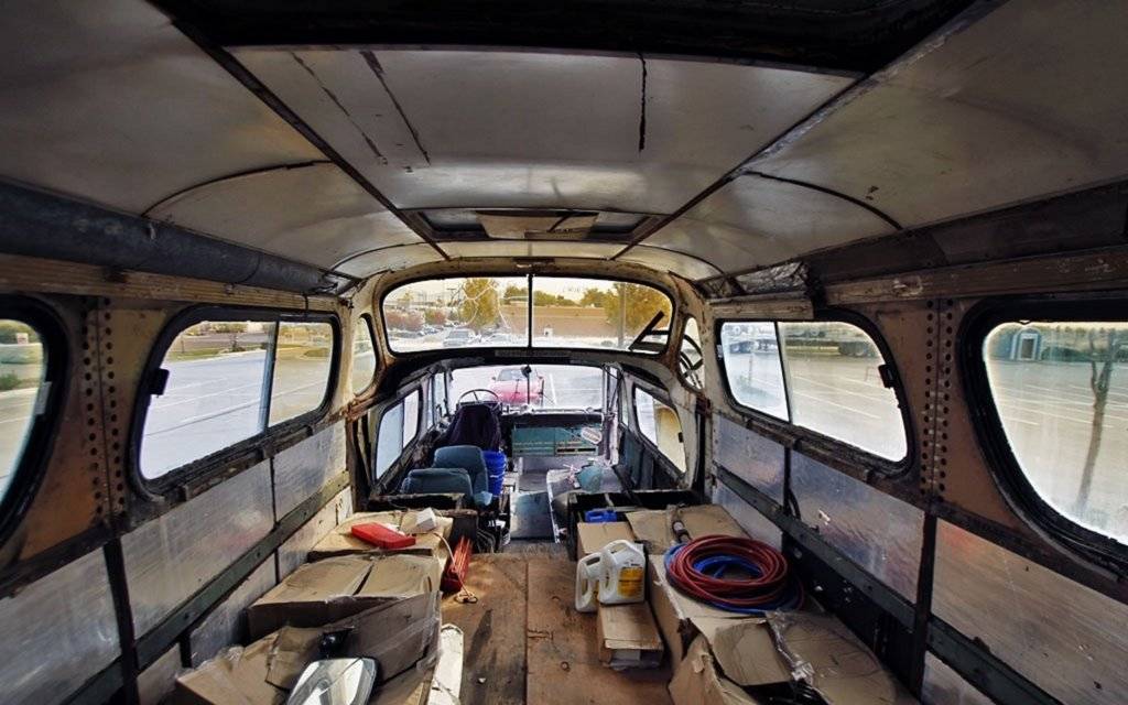

The Scenicruiser was designed with a very unique feature borrowed from the aircraft industry. It doesn't have a frame. It's whats called a Monocoque design. It's strength is derived from the outer skin and internal bulkheads. You can't just go chopping things out without a plan. There have been some Scenic's done like that and generally speaking, they broke in half or drove so poorly they becasme scrap metal. We have a failrly extensive background in building race cars and fabricating structures.
To be sure, it's a major undertaking ...

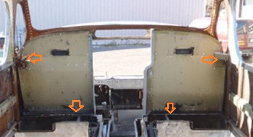

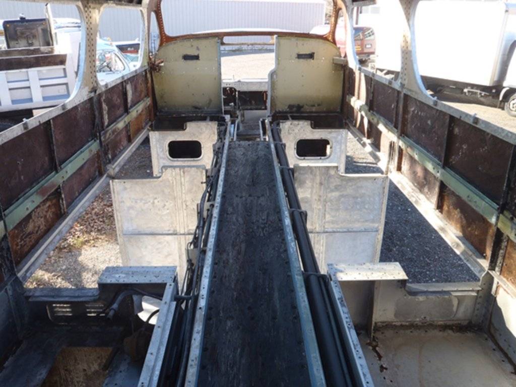

So again this is NOT my bus below but you can see in post #1120, and below in the stripped bus where the major surgery is needed on the luggage comparment buikheads (ya gotta flatten them) to remove the center aisle, and again what the Red Bull guys did to have a flat upper deck they wanted for their party bus

THere were seats and a padded section (safety mainly so you didnt smash your face on the bulkhead betweeen upper and lower deck). As kids, we made our Dad get in line early so we could be first on the bus to get those seats.
If you lower the floor, you have have a really tall seat to look out the front/sides. I want seats there in my upper deck design, and again I dont wanna flatten the floor/eliminate the center aisle.
Red Bull left the design style of a separation bulkhead between the upper and lower decks, but they flattened the floor and there are no seats to accomodate viewing through the panoramic window.

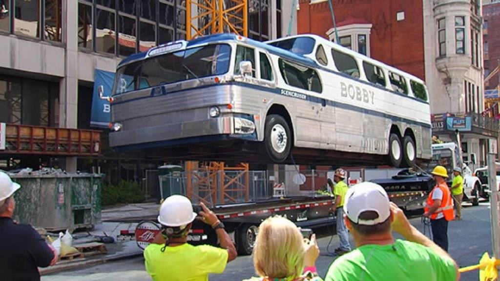

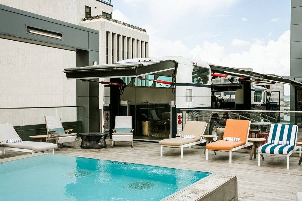

Just found out where one of the 1,001 PD-4501's wound up. Bobby Hotel in Nashville.
Source: Greyhound bus placed on top of downtown Nashville hotel roof
View attachment 285480 View attachment 285478 View attachment 285479
I'm not a fan of the Red Bull build, and I absolutely hate the hotel bus. I hope they both started with something pre-destroyed, but I suspect they both searched for the best starting point they could find.

BUT where these coaches split in half/crack a LOT is between the orange lines, and are weakest between upper/lower decks. so something is going on there for sure.
There's definitely "structure" going on ... its thick steel. gotta investigate more. with unlimited money at their disposal, Red Bull left them in but flattened the floor. i will ask folks on the bus forum.

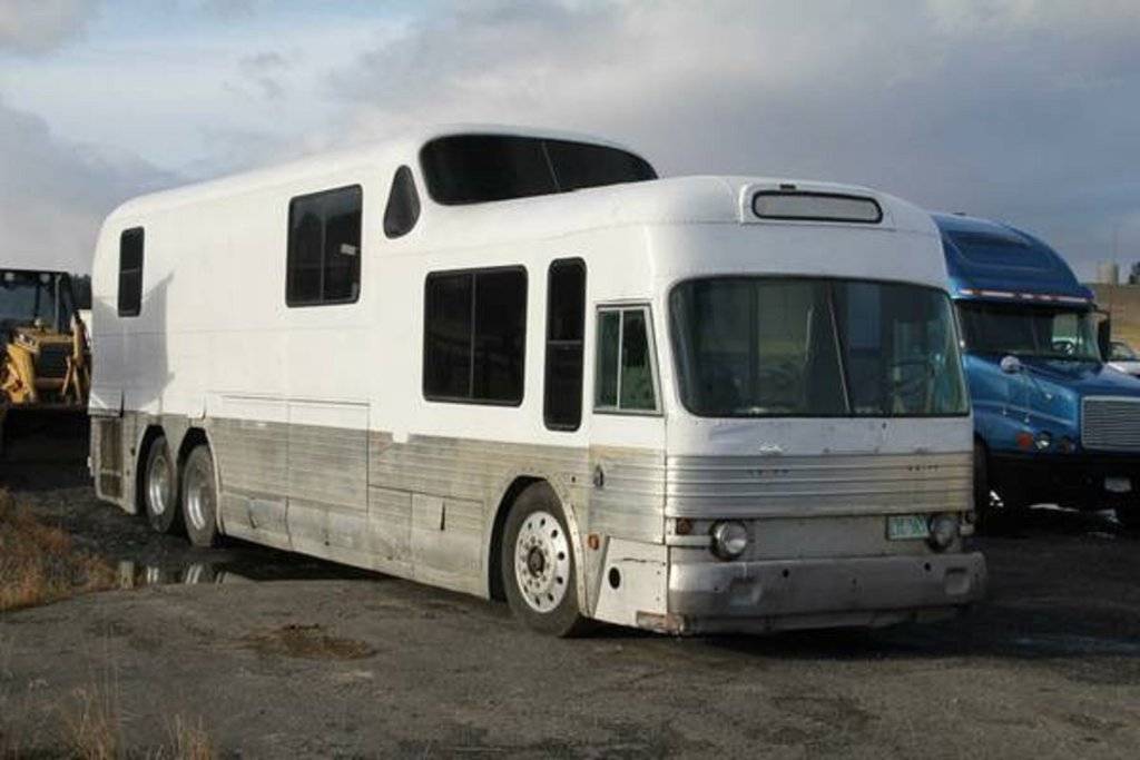

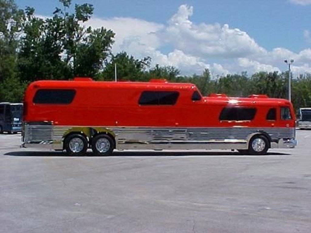

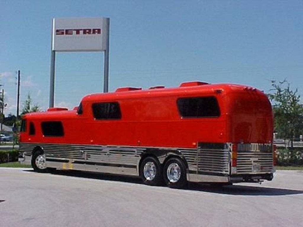

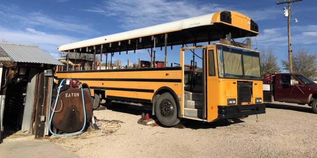

This one is here early on. Its raised roof AND lengthened (lower deck section).
Builder had BOTH the skills (he didnt pay retail) and the "cabbage. End product came out great from appearance sake.
Raising the roof is arguably requiring primo "monocoque" construction skills. others argue that floor flattening is harder.

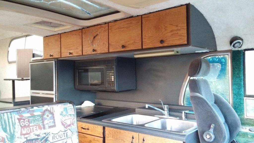

Then we had this one .. back in #551. Lowered floor, removed upper/lower deck bulkhead. I bid on it back then.

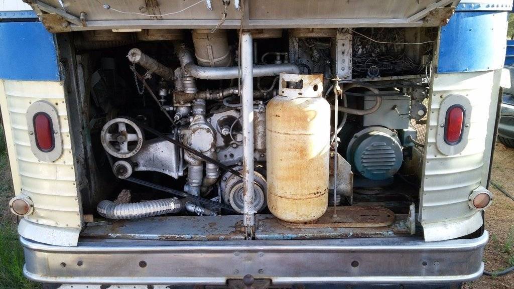

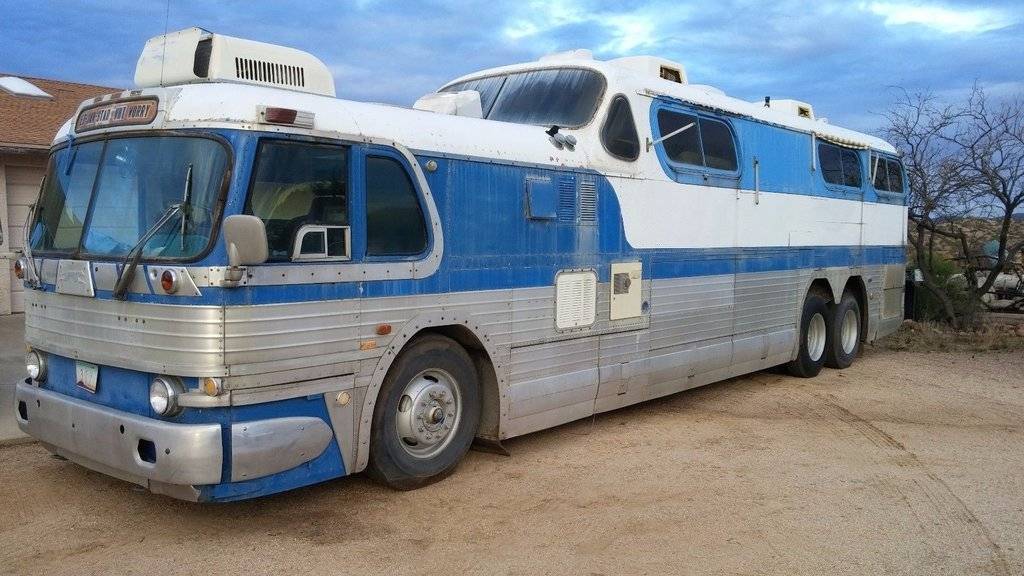

Since I have "recanted" and wanted a more original coach to start with. Whisperer also liked the equiipment choices .. except the propane tanks next to the engine of course. Too much retrofitting as well, and NO idea on whether the floor job was done "right".
1956 Greyhound Scenicruiser | eBay
SELLER DESCRIPTION (abbreviated)
Up for bids is my 1956 Greyhound Scencruiser. This bus was converted by my father who also built the three Echidna sports cars in the 50's. Google it to get an idea of his abilities.
He purchased the bus from Dickenson Lines Inc, Anoka Minnesota in 1977. He spent the next two years converting it. He elected to drop the upper floor to the depth of the center aisle instead of lifting the entire upper roof like some have done. He had looked at some done this way and did not like the overall look of the raised roof. This was at 80,068 miles after the conversion was completed.
The bus now has just over 97,000 miles on it. I purchased it from him in 1999 and full-timed with it until 2005. It has been parked since in Globe AZ and used for storage. This week I cleaned it out, checked fluid levels, fired it up, had six tires put on and took a 20 mile test drive. It runs and drives like the day I parked it.
Please understand that after sitting for 12 years anything could and might go wrong with it. It is being sold “As Is” for obvious reasons. I am not going to guarantee roadworthiness and I am not going to test everything in the bus before selling. Please do not ask me if I think it would make a 1000 mile trip.
I would recommend hauling it on a lowboy, but that choice is up to the purchaser. an it does in person. Included are parts and service manuals for the bus and engine and manuals for all equipment along with all research paperwork that my father had accumulated. Also included are some extra parts that he gave me when I bought the bus. Extra airbags for the suspension, various relays and other parts.
