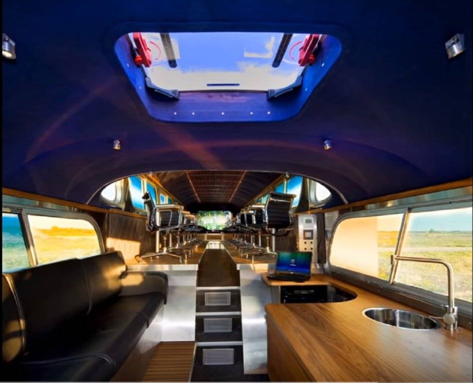

THis one ... more of a party bus than RV ... has design cues I am emulating in my plan. Video source of these pics is at the bottom.
1. They kept the original floor with aisle on upper deck. And if you look closely, as you move aft, there is another level above engine area. a step up. in my plan, that is the sleeping/lavatory area. They have a big screen TV, my plan is to preserve the original window and have a foldout/Murphy bed deal there.
2. they removed buikheads between lower and upper deck and cosmetically it looks very good. I am trying to find the builder to this coach/former or current owner to inquire about structural under skin there.
3. No obstructions hanging from roof, and small fridge/microwave/low sink .. but my "galley' would be on second level
4 pretty cool what they did with roof with design and with indirect and spot lighting - even the aisles on upper level. not quite me but there's ideas there. they also mechanized the original "skylights" so they could open. they also did a "stainless" thing on interior walls .. i am more wood/cloth in mind but it looks pretty good.
5. lower deck with sofa thing, opposite side with galley .. again I am looking at 4-5 swivel ABTS Captains chairs. The sofas tho are practical cuz you have the front wheel 'humps" to contend with in that area -- the Achilles heel of my chair plan.

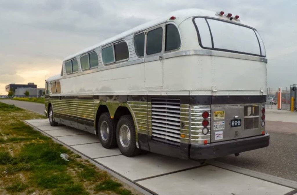

6. Exterior. Polished the stainless, painted the other areas (i wouldnt do black accents tho) and I am going with highly polished Alcoas. they kept a highly original look which i really like.
source:
I'd hate to be in one of those chairs if the driver has to slam on the brakes.
i think they are anchored tho (and they may swivel)..like the tables.
in the video some speaker looking thing pops up outta the floor between chair legs so i am speculating legs are fixed.
otherwise yes .. the design is in no way practical while coach is in motion. clearly dangerous.

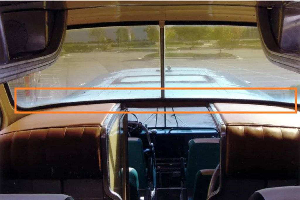

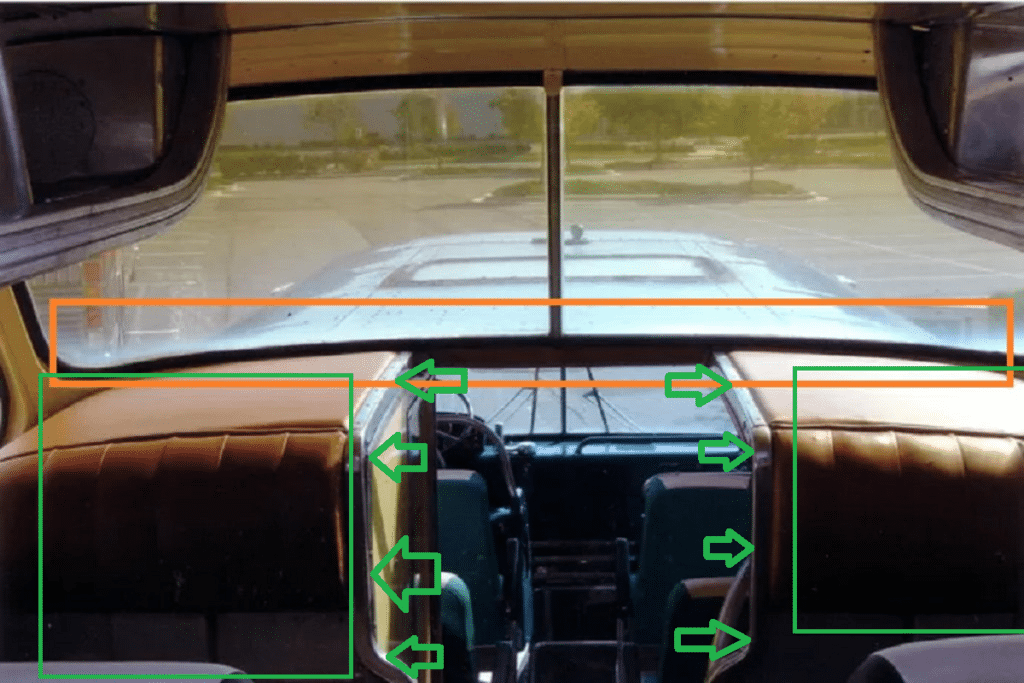

More looks at how people dealt with their upper/lower bulkhead issues .. one kinda "as-is" and the other with more thought (you can easily guess which is which).
my nostalgia plan ... to keep the padded original panoramic window seats .. uses about three feet of real estate AND blocks the view I want.
BUT, its structural contribution (orange box) has to be dealt with I think. Whisperer is sure of it has some body stiffness benefits, but a lotta redone coaches eliminated it.
more to come on that .. but iwould have to extend the upper deck floor forward and that's actually a much better plan then trying to flatten it.
After looking and thinking awhile, I think that's best. If it provides any structural advantage, and I'm sure it does, keep it. Heck maybe even keep the outhouse there too.
You could put a couple of nice potted plants up there when parked. :lol:
i leave the green arrows for structure AND railings for the stairs that are right there perhaps.
The green squares (part of the the bulkhead are removed and/or replaced down to the floor of the upper deck with like plexiglass (the thick, bulletproof kind).
My goal is the clean open look with them (the buikheads) gone. gotta be a way to do that without weakening, or by reinforcing that area under the panoramic window.
Ill report again when I have the answer ... in 2020. A crapload of mechanical work way before that. :)
