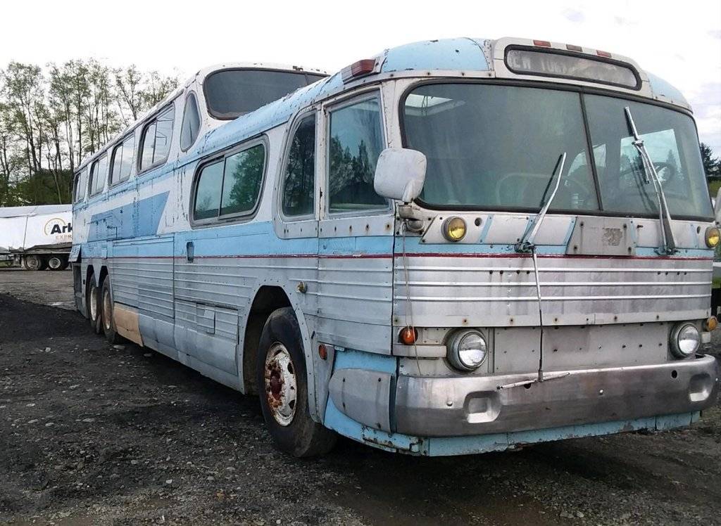

And now the transport is at hand ... more to come on that odyssey this coming week, but here's the dimensions of the 28,000 lb job. She's 11ft tall too .. only a low-boy will do.
update ... still working on the pickup. y'all with get a kick out of this story .. unless its pisses you off as much as it does me. :BangHead: :)

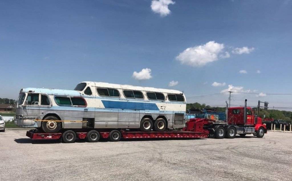

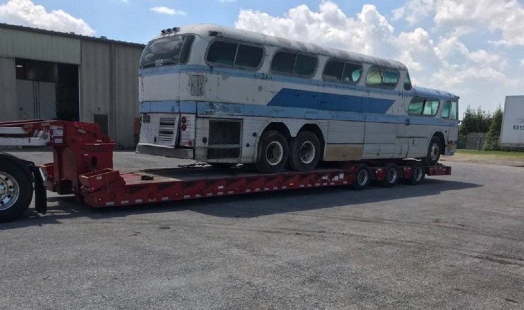

Dunno if any of you ever shipped a bus or similar (40 ft long, 11ft tall, 8 ft wide, 29,000lbs). If ya thought cars/light trucks was an ordeal? My one-time experience could be instructional. Anyway, will be at my place in two days. then the fun really starts.
Holy Motherlode!!!!! .

Delivered to the NY HD truck repair where the journey starts .. it was at night so this is next day. I was not there and one of the guys there got these shots

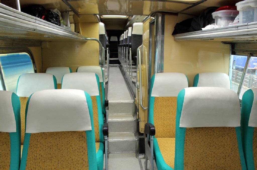

My coach .. couple interior shots of lower deck. on another site, a guy asked me IF I had a sink for the lower john. offered $500 for it. that 10% of what I paid for the whole bus. crazy.
In contrast, here's what this area looks like in an original configuration

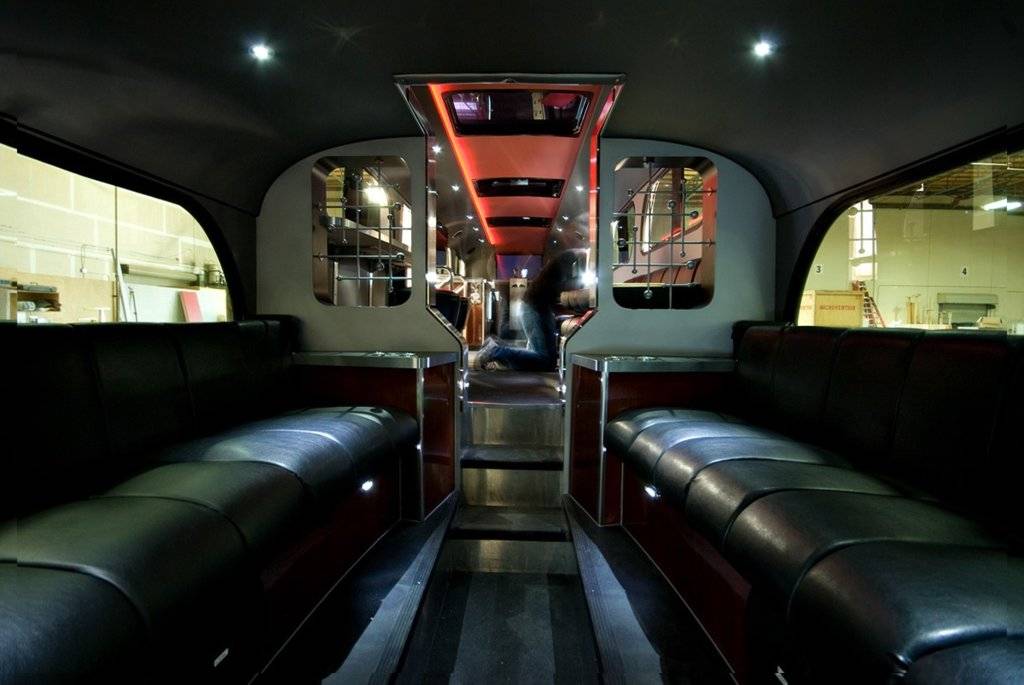

oh .. how the Red Bull Scenicruiser looks here on lower deck
