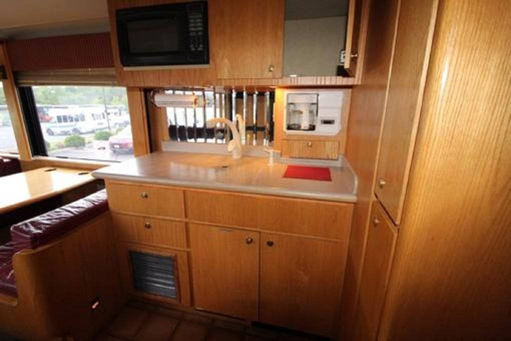

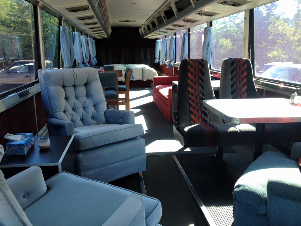

1998 MCI VIP CONVERSION BUS # 274
  • $64,995.00 - Ready to Roll.
  • MCI "I-MPV" VIP / Entertainer bus with 327,280 miles
  • Series 60 Detroit Diesel engine
  • Allison B500 automatic transmission
  • Aluminum Wheels
  • Retarder
  • Webasto
  • (2) 12V accessory outlets at driver
  • 110V electrical outlets throughout coach
  • Sony AM/FM/CD
  • Shore Power

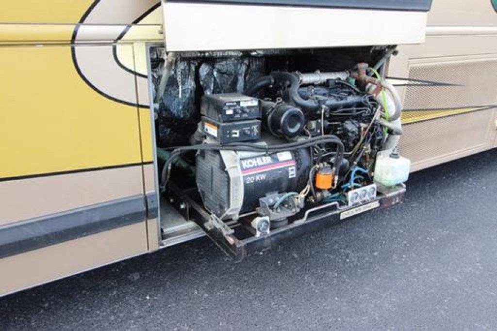

  • 20KW Kohler by Kubota generator w/ 7,357 hours
  • CruiseAir basement unit A/C 30 amps / 50/60hz / input 115/230 / SN L97C
  • Day/Night window shades
  • CB radio w/ mic
  • Sony Serius XM/Bluetooth/USB radio

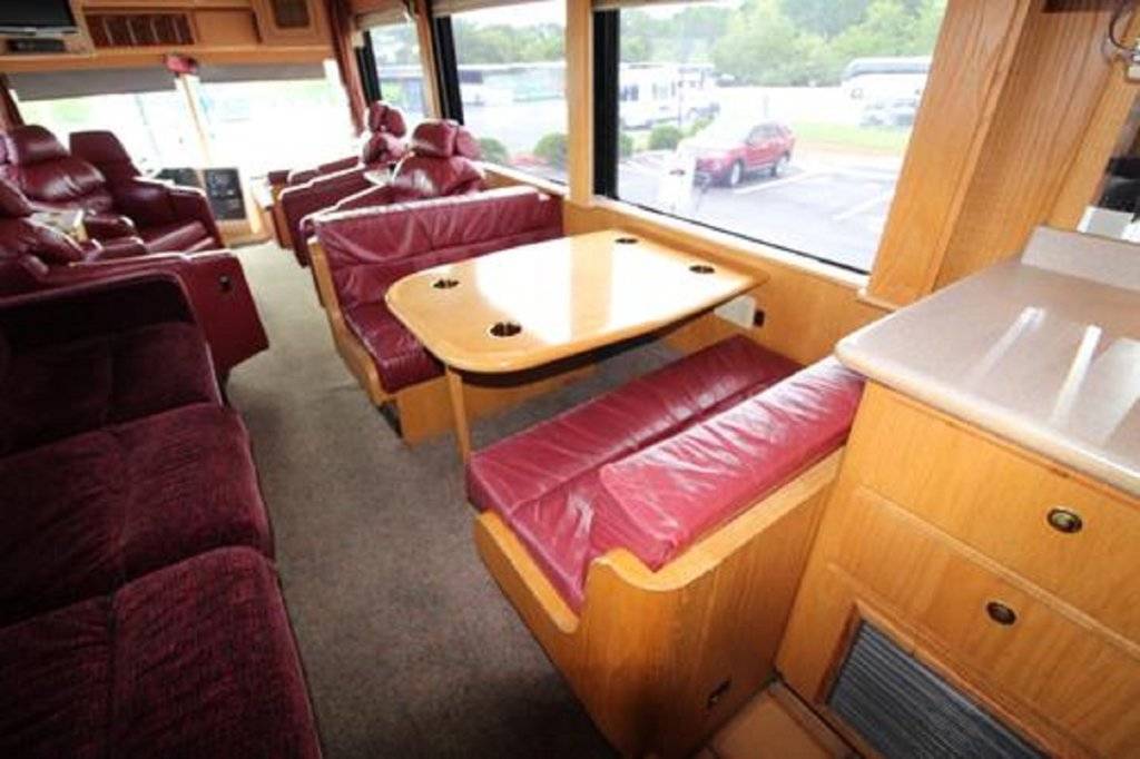

  • 4 Captains chairs in front lounge
  • Dinette table/chairs seat 4, it folds down to make a bed to sleep 1-2, and also has under-the-cushions storage areas.
  • Front-lounge couch sits 4 and is a sleeper sofa which sleeps 2.
  • Huge co-pilot seat with fold-down step (to avoid legs hanging over steps)
  • Front lounge TV is 15" w/ 10-CD changer & DVD/VHS players
  • Direct TV boxes available in front & rear of coach
  • Kitchenette has: Norcold refridgerator, Sink, Built-in soap dispenser, coffee pot, drinks/ice bin, Sharp microwave, & very ample cabinet & counter spaces and a pantry!
  • A garbage bin goes directly into the bay of the bus for easy, spacious & out-of-sight, dumping capability.

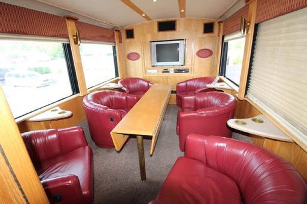

  • 6 swivel chairs in the rear of coach for VIP board-room meeting space with projector screen. Fold-down Table optional. Also a great party-bus layout.
  • 27" TV in rear boardroom w/ Sony H-Fi Stereo/VCR/DVD/10-CD changer & Bose surround-sound.
  • Wine-gard in-motion satellite.
  • Bathroom has a full shower, toilet, sink & very ample cabinet space.

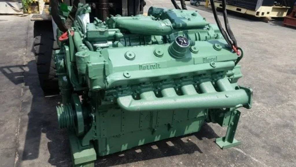

I also read some speculation somewhere that there may have been some 12-71 conversions... IDK if that would even fit, and imagine that if it happened it was exclusive to a very few crossing the Rockies where they may have wanted more power. Too many cylinder engines always get my attention for at least a minute. :D
I never heard anybody discuss a 12-71 conversion in one of these coaches. I dont doubt somebody's tried it tho.
Owners of 8V71's dont report issues with mountains .. guess it would depend of course on load and condition of the mill (at full reconditioned power or with 500,000 miles on it since rebuild), full of passengers and luggage or as an RV towing a trailer.
My 8V71 rebuild is gonna push the limits of what's possible out of it without sacrificing reliability/original look and not breaking the bank. I am discovering you can spend whatever amount your wallet can stand on these converted buses (or any vehicle project for that matter). Mine will be equivalent of a "good looking, well running driver you can be proud to take anywhere" ... not a "Taj Mahal" on wheels (e/.g some Newells and Prevosts)
I toyed with 8V92 (SC's and turbo'd) for #473. EOD, more likely to have cooling issues from the extra oomph than not --so its been reported by others on the bus forums. If my dialed-up vintage Detroit/Allison combo aint cutting it, i guess I can always save up for a stouter mill later.:)

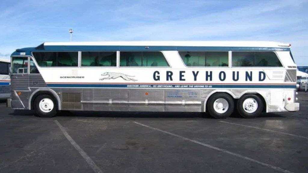

MCI built 100 model MC6 coaches for Greyhound starting in 69 with V12 Detroit Diesels.
Kevin
Well look at this big honkin' some-gun. MCI MC-6 'SuperCruiser" .. Shoot, now i gotta have one! :rolleyes: Six inches too-wide, and gone in two years. Never saw one in person .. wonder if any are left?
source: Bus Stop Classics: MCI MC-6 “Supercrusier” – Six Inches Too Far Ahead of Its Time
"Unless you’re a certified bus fan (and a certified old guy), it’s unlikely you’ll recognize this coach. Motor Coach Industries (MCI) built only 100 of them for Greyhound between 1969 and 1970, and they spent most of their time on roads in Canada and on the two US coasts. When introduced, it was probably the most unique intercity bus in service. It’s an MCI MC-6 Supercrusier.
First some history – by the mid-1960’s, Greyhound’s General Motors PD 4501 “Scenicrusiers” were getting tired – they had been in front-line service for a good 10 years and needed to be replaced. You may remember that Greyhound purchased MCI in 1959 to serve as its sole source provider, largely based on its disappointment with the 4501, which had initial powertrain reliability problems and later developed cracked frames.
Size: The MC-6 was the first 102 inch wide 40 foot long intercity coach. At the time, Canada and several US states on both coasts had increased their interstate highway maximum vehicle width dimensions from 96 to 102 inches. Greyhound had assumed, incorrectly, that other states would follow suit and adopt these wider limits also.
But many states kept their 96 inch rule until the Federal government enacted the Surface Transportation Highway Act in 1982 which standardized the 102 inch width on the entire national highway network. As such, these buses were confined to routes in Canada and along the two US coasts. Initially, the MC-6s operated only on the East Coast, but later were all sent to work on the West Coast.
Power: The MC-6 was one of few coaches to use the GM/DD 12V-71 engine, a 14 liter, 852 cu in V-12 monster than twisted out over 400 hp and 1200 ft lbs of torque (other versions would go up to 600 hp). With its unique two stroke exhaust note, this engine was nicknamed the “Buzzin’ Dozen” and was paired with a Spicer or Fuller manual transmission. It gave these buses superb performance, albeit with a penalty in fuel consumption.
The eighty-five MC-6’s in the US (fifteen remained in Canada) were subsequently re-engined with the 8V-71T and Allison automatics in 1977 when they were sent to the West Coast. The US fleet was retired in 1980, and sold off to other operators. The Canadian MC-6s retained their DD 12V-71 engines and manual transmission.
Multi-stepped Seating Area and Roof: Most models in the late ‘60‘s-early 70’s had stepped seating areas and notched roofs; the GM Buffalo, Eagle Model 05, etc. The MC-6 had two stepped areas (not including the entrance); three steps up to the first seating area behind the driver, then one additional step up to more elevated seating from the middle to the rear of the bus.
In turn, the roof had two notches instead of one. This made it 12 ft tall at its highest point, so it was not only the widest but also the tallest intercity bus then in operation.
The more mainstream MCI MC-7 (shown below, @ 96 in wide, 40 ft length) developed in conjunction with the MC-6, achieved much greater success, with over 2500 being built, and soon became the mainstay of the Greyhound fleet.

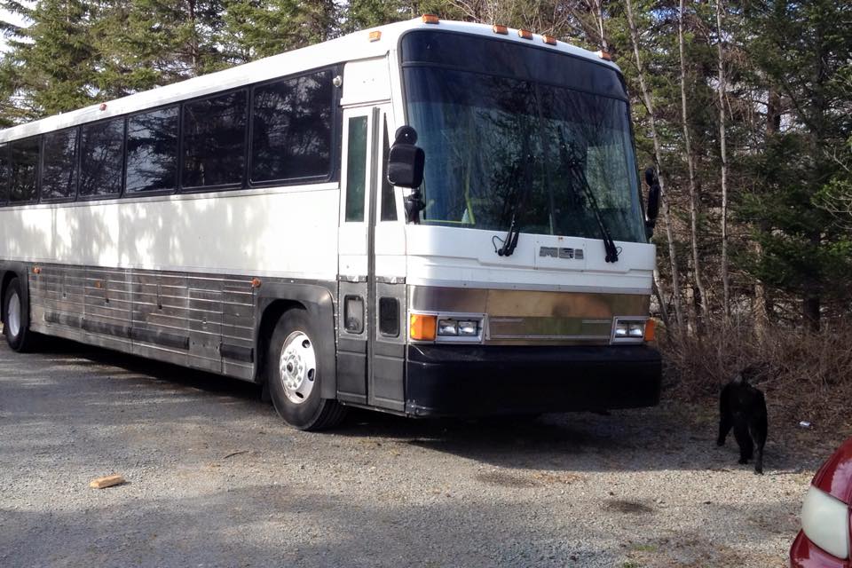

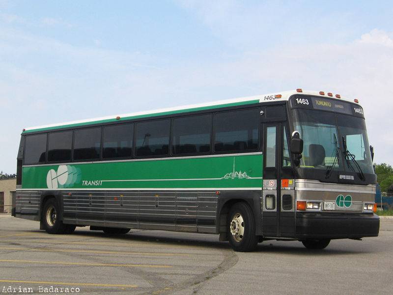

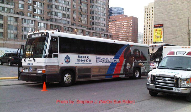

I have a 90 MCI 102 A2, 6V92TA 300HP with a ZF Auto trans, started out as a GO transit commuter coach in Ontario, then belonged to the Metro Toronto Police as a mobile command post/ recruitment center/ troop transporter. I drove it home from Ontario, got it as far as a rough camper converted and have been taking it to some music festivals etc....
Got side tracked yet again when a friend of mine in Prince Edward Island developed a brain tumor and had to sell 2 Motorhomes that he was working on...I bought them well.... because....squirrel....... sold one and kept and renovated a 92 35' Gulfstream with a 12V Cummins and an Allison 4spd
cool rigs 340Dave. diggin' the open look! thanks.
Lots of room for people to come over and socialize :), we haul everything we need with us, generator, BBQ, porta pottie, water, appliances , lawn furniture, etc.....not sure if I'm going to go to the next level or not....I sold a 30' 5th wheel last summer that was going to be the donor unit for the bus....
