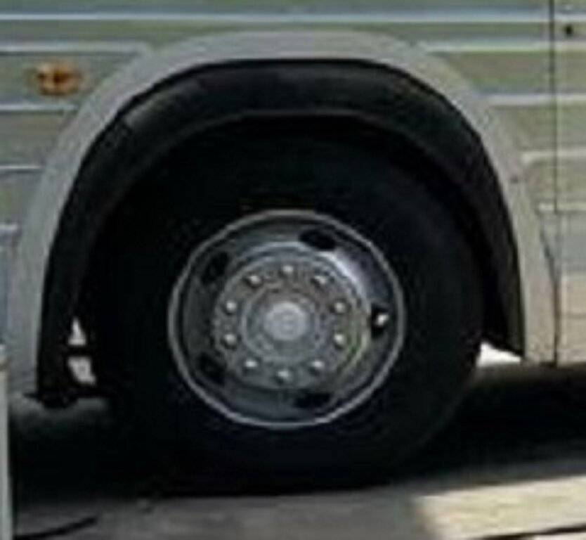

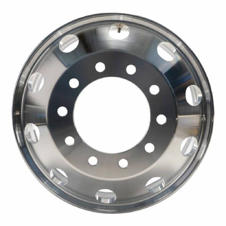

Old 60's Greyhound wheel at 22.5 x 8.25 same as this modern Alcoa knockoff (i have a good price on some blems i am looking at - but gotta act fast).
10 bolt same for sure, but hub center center same across all this years? (Whisperer is MIA this mother's day weekend :))
Eyeballin' it seems yes, same in every dimension.
View attachment 374487 View attachment 374485

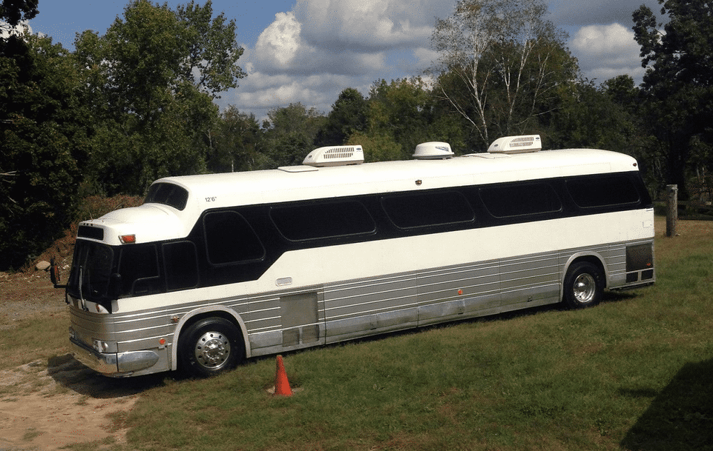

yeah, gotta have something to drag a C to Carlisle with lnext summer. PD 4501 may not be done till fall 2021 given COVID delays -- everything is backed up in front of my work.
1968 PD 4903. The "Buffalo" bus. 40 ft (three luggage bays, no tag axle). 8V71, 4 speed Spicer (yes, i wanted to shift). only 403 made. One of my top 5 choices in the search documented in this thread. Runs like a champ
Next time "Buffalo Bill" is viewed here, it'll look a bit different. Paint scheme, shine up the unpainted skin areas, replace the four missing windows (originals came with it), wheels/tires spiffing, and minor changes on interior decor.
Husband and wife prior owners, both were skilled at stuff you see inside, and their handiwork was really good, but it'll have more of "bachelor pad, man cave" vibe. Keepin' the wood work though .. its solid and very well done (no particle board) custom work.
That work will finish by September 2020 and I'll gt 2-3 months of good driving out of it.
That is a stud piloted wheel. Wheels in common use today are hub piloted and will not interchange.
The stud pilot wheels are still available but will probably be special order and priced accordingly. I can buy polished aluminum hub pilot wheels here for around $250 CDN.
I would inquire about whether there are hub piloted hubs that will interchange with what you have. They will be a better choice in the long run.

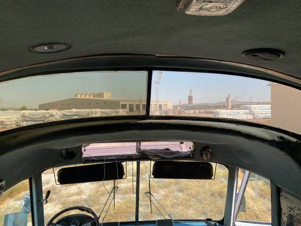

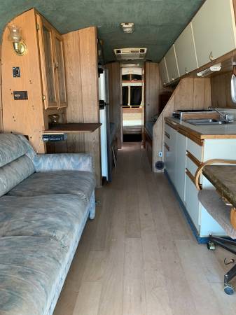

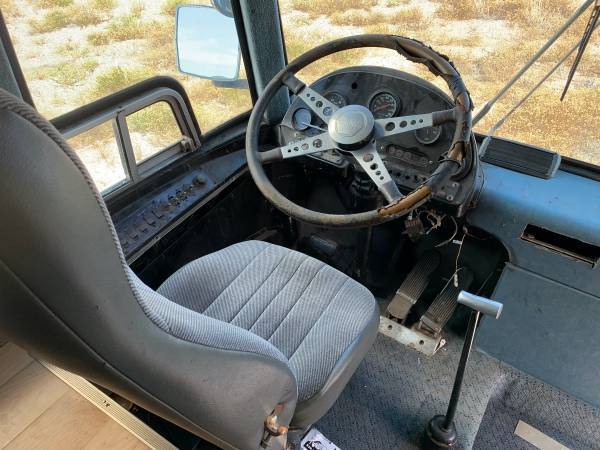

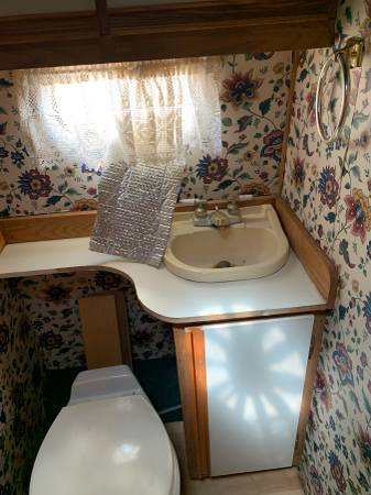

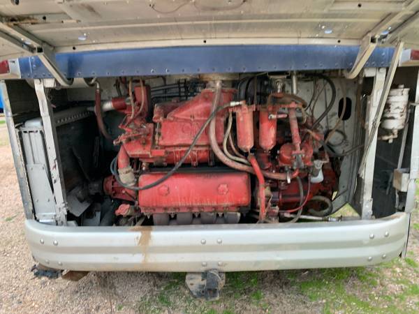

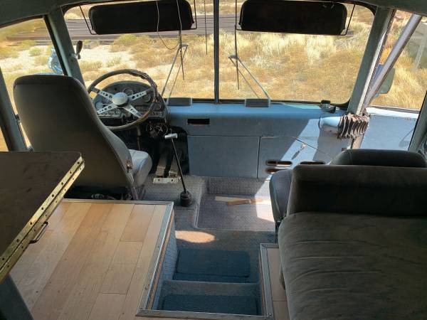

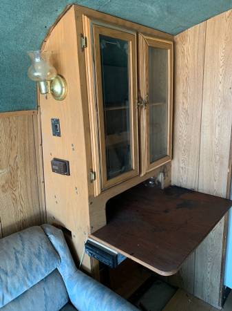

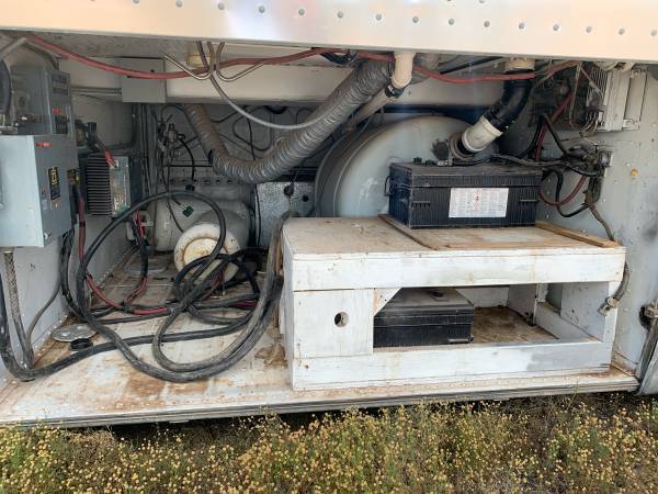

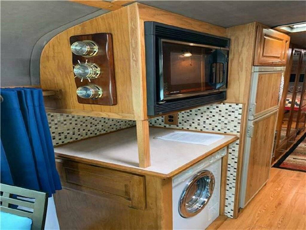

1967 GMC 4107 - rvs - by owner - vehicle automotive sale
© craigslist - Map data © OpenStreetMap
(google map)
1967 GMC 4107
condition: good
cylinders: 8 cylinders
drive: rwd
fuel: diesel
odometer: 36955
paint color: black
rv type: class A
size / dimensions: 35'x 8'x 12'
title status: clean
transmission: manual
GMC 4107 owned since 1991. Was purchased from Maxwell's Private Coach in Tucson, AZ. They did a overhaul on it and engine rebuild. Has not been used much for the last 12 years. Odometer shows 36,995 but it did not always work. Runs and drives good. New tires, new batteries, Sleeps 6.
Onan 4000 propane generator
Detroit diesel 8V71
GMC/Dana 4 speed manual trasmission Mdl. 7145VJ
Fridge
Microwave
Bicycle rack
A/C
Heat
1 full size bed
2 twin beds
Fold out couch sleeps 2
Shower
Gas cooktop

btw ... GM T&B bus manual says hub pilot or stud pilot wheels are ok for 4903/5's
