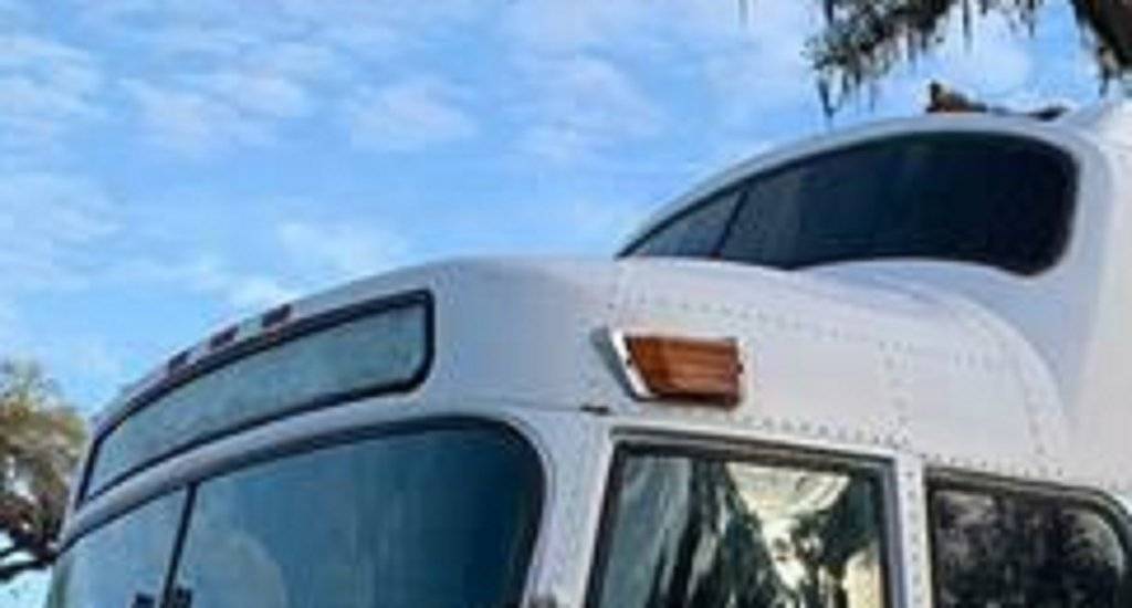

its appears this bus was never experiencing "cracks" while in service. OR did but were unrepaired. No evidence of repairs when i bought it.
I cannot untangle this .. conflicting stories out there .. when the powertrain retrofits were done in early 60's, some buses also had cracking. word is while ALL got inspected, only some were "remediated" for cracks at that time. No records available, it seems, by serial number, of what bus got what, when, during or after the powertrain deal.
Greyhound used them after powertrain retrofit for another decade. over that time some did crack. the fix was welding metal plates, behind the monocoque skin and on the "frame rails (wrong term, but monocoque guys know the right term for the innards) above the rear wheels and around the last two banks of upper deck windows.
Fifty+ year old mystery aside, its easy to do during a refurb like mine, relatively speaking, cuz you gotta do it from the inside. The insides are torn out anyway. still takes a bit of skill but Whisperer says be calm ... unless those frame rail thingies have issues (rare, but a giant pain if so cuz then your into messin' with the skin of the coach)
Onward undaunted... :) for now.
All things considered... It would probably have been wise to plate in those areas anyhow. Since the common locations are so well known, I do like that your bus was apparently able to last so long without the work. I wonder if that might be an indicator of better stress relieving during assembly of the frame and skin? I would tend to agree with not messing with the skin if possible, that would likely undo any advantage of starting crack free.
