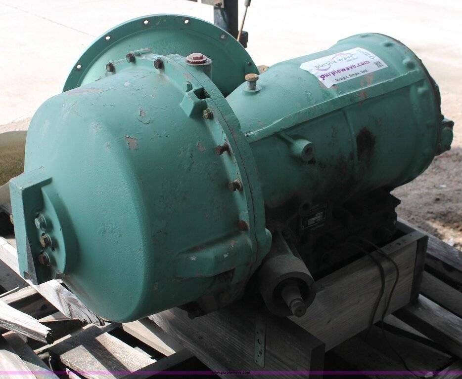

guess its this big honkin' thing (the V730) .. but i really dont wanna do an automatic
