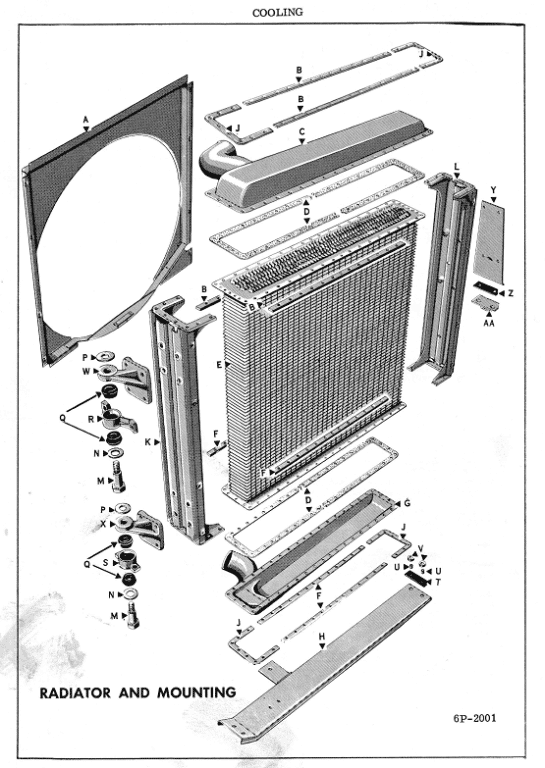

FYI .. this is a 4903/4905 (Buffalo bus) radiator from the parts book.
Similar to a 4501 design (tank inlet/outlet positions different tho) due to engine orientation (transverse with "V" drive, vs longitudinal with "T" drive), its a substantial assembly.
In both coaches, the assembly is "modular" in that it can be "unlatched" and moved outta the way to give clearer access to the engine bay. I have the whole module out for service/refurb

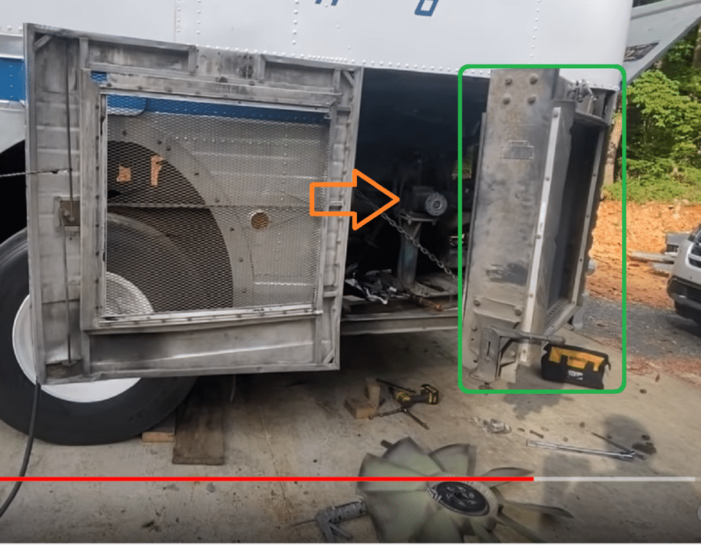

In 4501 (shown below in another 4501, not my bus), if you are facing the radiator on LH side of coach, the access door opens flush against the body to your left, the rad module (green box) is unlatched swivels out to the right so you can get at the fan gear box (orange arrow) or the heads, etc.
The mod is big/heavy a you might imagine. We drove it 400 miles roundtrip the first time .. local guys have it this time.

I do NOT wanna try to horse around trying to get a class 8 rad to work, but rather would like a properly dimensioned custom core built (it will have to aluminum vs copper/brass in the OEM design).
On a custom core job, getting the dimensions right (to fit the OEM "module", face area, thickness, New tanks and/or custom headers to allow the new, thinner core to fit OEM tanks, maybe?, etc) to deliver the heat exchange performance needs to be professionally calculated (core builder can do it probably).
