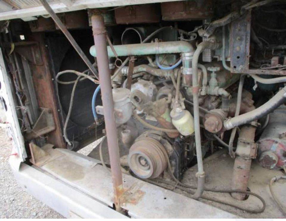

There's a "green" engine and a "blue engine. Plus the "blue" engine (8V71TA Turbo charged with After-cooling) has a "Jake Brake" system (didn't know that's on the heads!).

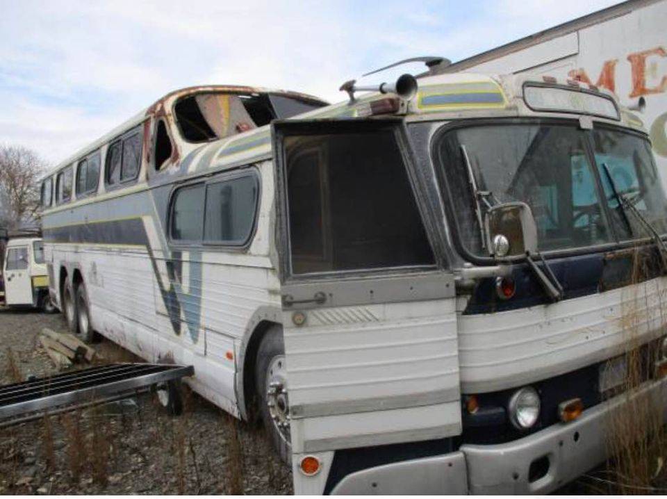

Looks like it could be a good deal.
Neat old coach. Price is "right" too (subject to condition/equipment).
source: GM Buffalo bus - Wikipedia
Looks to be in the "Buffalo" family like mine (the 4107-08/4903-05 PD series) .. but I thought they were gone by 1980 at the latest - I gotta check that. Maybe seller means it was converted on 1984?

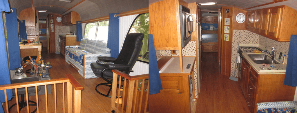

I say 41 series because it looks like it may be 35 footer, judging by the 2 full "basement doors" pass. side between the wheels. that would make it a 4107 or 4108 -- the 49 series were 40 ft -- three "3" full basement doors pass. side will tell ya at a glance (my 4903 below).
wish he described more of the RV amenities (gen-set, plumbing, HVAC, communications, etc.). STill, its "old school, pedestrian, clean .. my cup of tea vs. "Taj Ma Vosts" and similar rolling palaces.

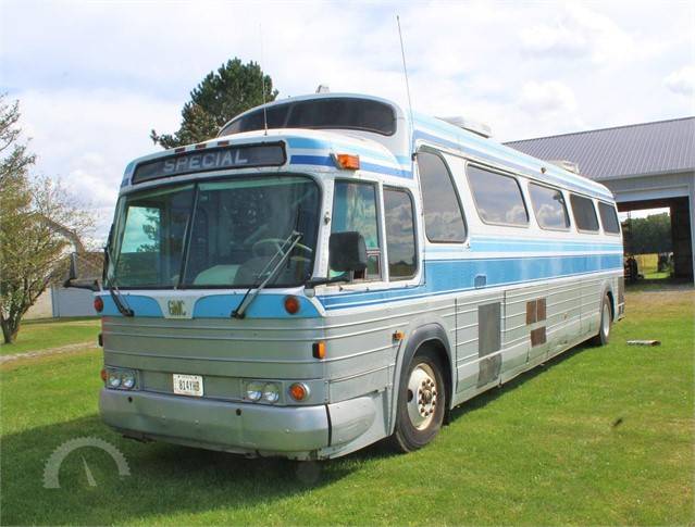

The last "Buffalo" buses. the 1980 H8H 649. Couple years ago at auction. sold for $15+K
soruce: https://www.auctiontime.com/listings/trucks/auctions/online/208735519/1980-gmc-h8h649
Description
1980 GMC Model H8H-649 Highway coach converted to a Motorhome.
This bus is 40' in length and is known as a "Buffalo" due to it's humpback style of roofline. 1980 was the last year for the GMC highway bus. this couch has a 8v71 Detroit diesel with an Alison automatic transmission. Both work as they should. The tires have good tread but are older. Always housed inside when not in use.

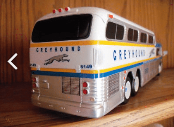

The smaller ones (matchbox sized, 1/64 scale?) come up a lot tho it seems, the bigger ones (like the die-cast one below - 16 inches long, 1/32 scale, few hundred dollars) not as much.
The small ones are plentiful, so don't tend to be back breaking in price (< $20) but I honestly don't know the full range.
source: Rare, Large, 16" Greyhound Bus, Diecast Scenicruiser | #152800563

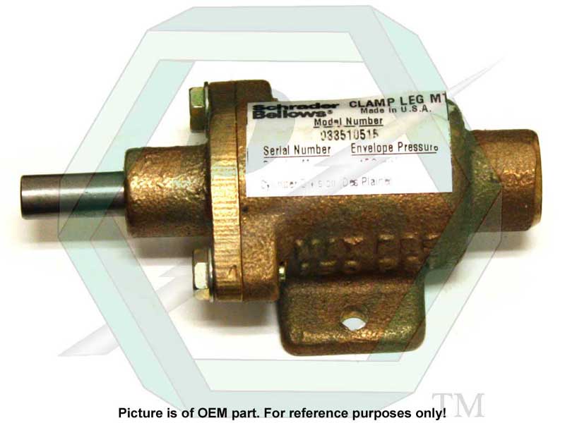

I think we can wrap up #1,439 - the repair we (a local, mobile diesel guy, recommended by the HD shop he used to work at, is coming to the bus to try this weekend or next).
I did NOT buy the whole engine stop cylinder, but the "kit" on ebay for $25.00. The kit has the piston cup, new lock washers, and the return spring in it. If successful, the whole job is $200, parts and mobile labor.
I also discovered that my parts manual (came with the bus) was incomplete. The full manual is available online .. free. I studied the diagrams too .. but the text was very instructive of course.
I feel better prepared (some nerdy pics below for anyone interested).
we'll see if ole 4903 holds up on me. I wont report any more on this unless it goes bad/lessons learned from failure or something more needs attention IN a shop.
source:
#4 is the whole assembly. #6 is the lever I actuated by hand to shut-off my bus. #5 is the "box" cover (governor assembly is under this cover).
stop-cylinder cutaway and R&R instructions.
Makes more sense there is a "return spring" in there (maybe .. unless the same part [WITH spring] is being used as "fast idle limiting air cylinder") when to "retract" (unless the stop lever has ONLY enough "left" tension to push stop cylinder piston [WITH-out spring] back in after shut-off?) to pull the piston rod back AFTER it pneumatically extends to push the stop lever to the "right" at shut-off.

A complete unit arriived as shown on the left, box (about two inches by four inches) it came in on the right
I was incorrrect on the EBay part I ordered, the $25 part (was told it was only cup, screws, and springs vs. the $402 part.)
This is what showed up and what we successfully installed. sorry about photo quality - my mobile mechanics took these pics.
A complete stop cylinder was in the DD box, same one that is malfunctioning on my bus. The instructions are dated January 1977, indicated part is designed to be maintaince-free for life, the new part looks pristine but has no date on it. We did not open the new part, but it seemed to operate is if it had a spring in it..
The piston-cup in my old part was split .. that would mean the cylinder could NOT hold spec'd air pressure. IT HAD a spring in it also, other than that that it was a direct fit with my old part. We did not paint the new part/
The piston could be pulled out (extended) by hand, and if the air fitting opening was then covered with a thumb, the piston would STAY extended -- meaning the cylinder holds air, thereby maintaining RIGHTWARD pressure on cut-off lever, until engine stops.
When engine stops, the cylinder DE-pressurizes and the piston retracts via we presume an internal spring just like the old one (to be ready for the next shutoff cycle).
Long story short, NEW, airtight, shut-off cylinder solved my shut-off problem. 4903 is set for now.

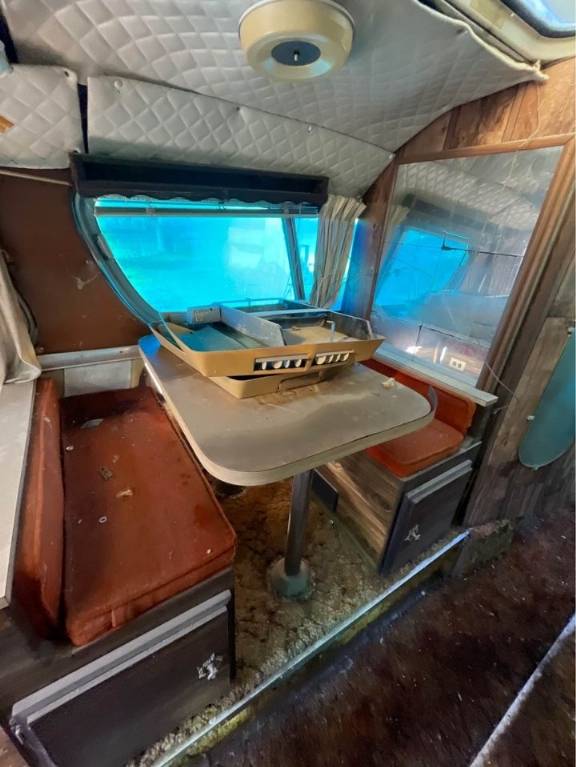

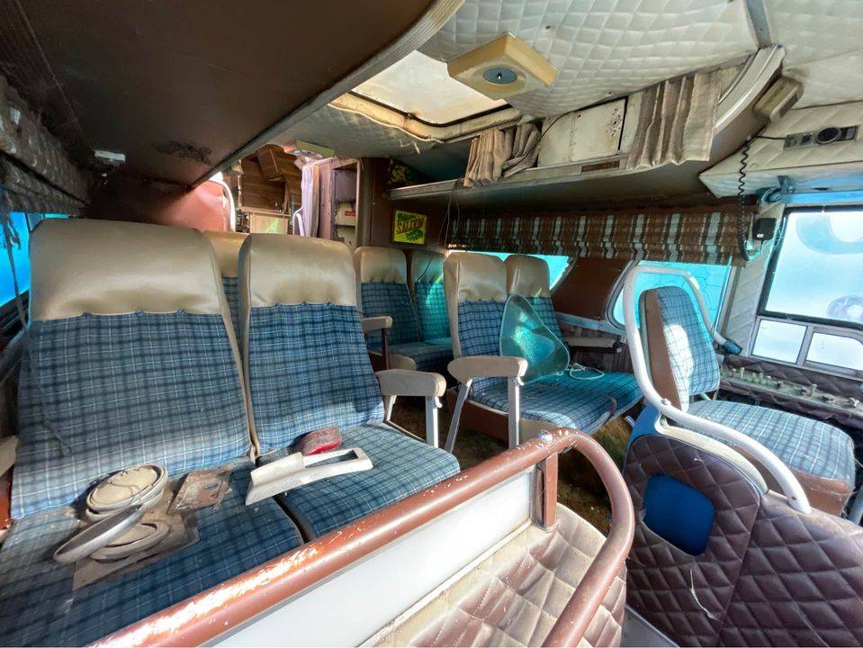

This popped up today.
Thx Chris.

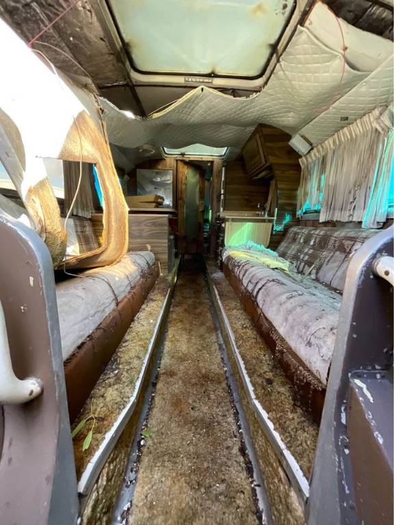

Price is right, x 20 and he gets to me for all the stuff this baby looks like it will need.
Not to mention, she's open to the elements (water-related damage) it appears as upper level panoramic windows are out (means its gotta be gutted down to its monocoque innards) which is what I had to do because of "cracks" aft near engine compartment bulkhead.
If it was one or two states away, I'd grab it for parts. For an inop, that's low five digit haul to get it east to Lake Erie so that rules it out.
I aint happy though till I have another "soul-draining, labor of love":poke:. Still looking to cop a Sultana.
Thx Chris.
Not to mention, she's open to the elements it appears as upper level panoramc windows are out (means its gotta be gutted to its moncoque innards (which is what I had to do for "cracks" aft near engine comparment builkhead.
View attachment 603806View attachment 603807View attachment 603808View attachment 603809View attachment 603810View attachment 603811
I can smell the inside of that bus from here.
