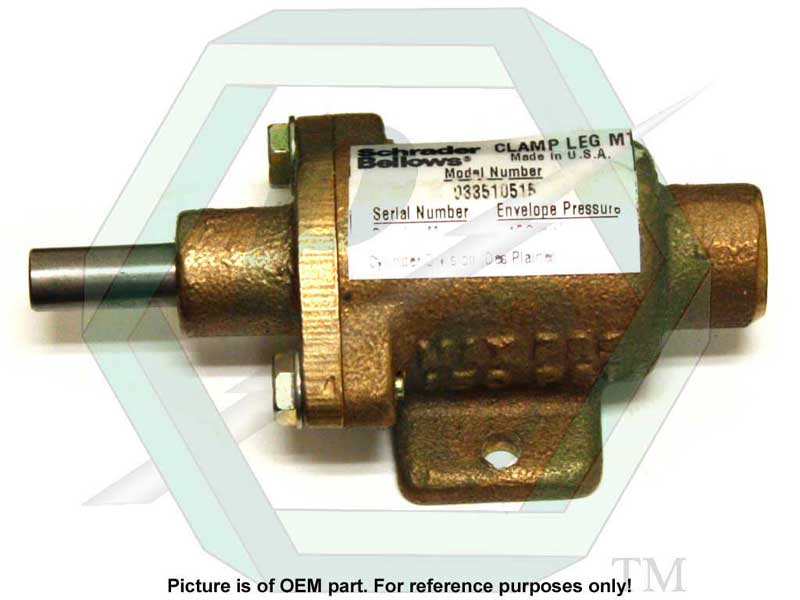

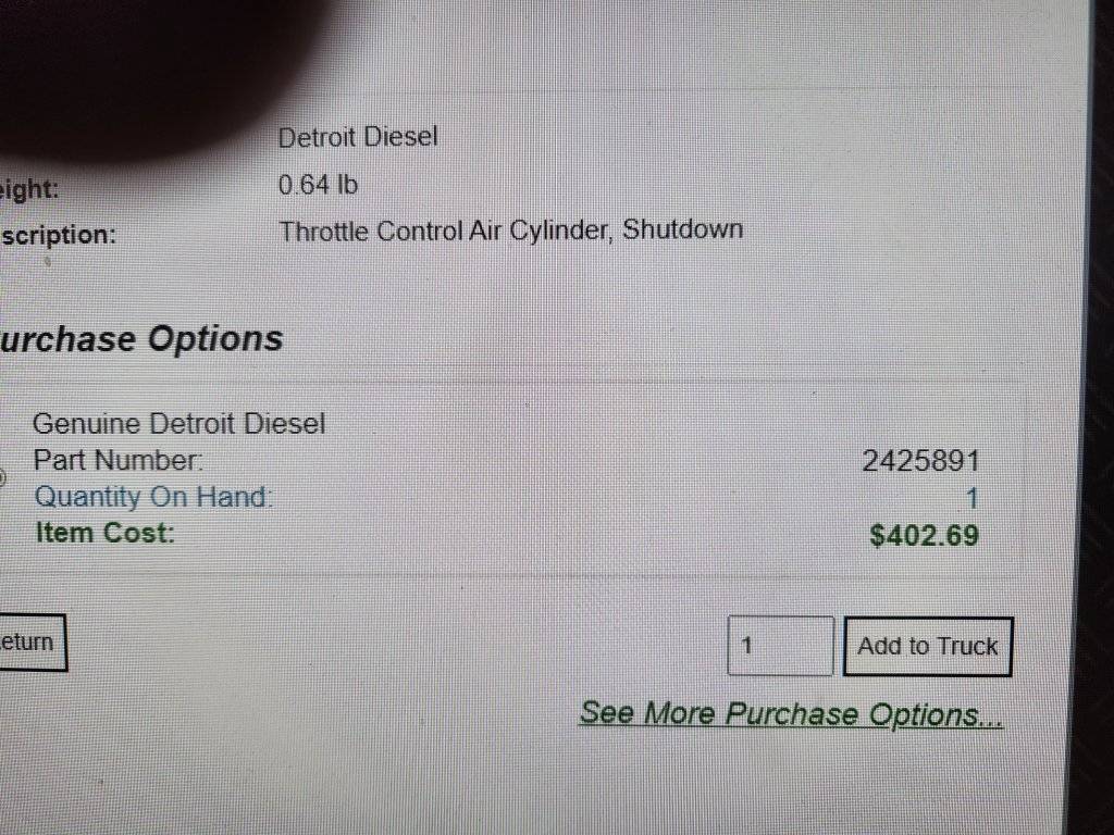

another source .. price doesnt break the budget either. maybe tho, this is just the "innards"?
Chris, I didn't get a price quote .. the ebay part number was $25.00. What did you find out?
