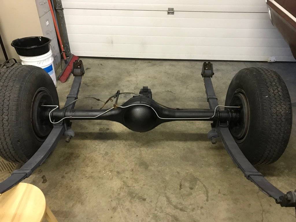

If you can, post a pic of the diff plug. If I can see its current condition I know I can help you get it out.
Thanks for the tips, I am going to give AFs suggestion with the bees wax a shot. I have not heard of this idea before today. Could I damage the axle seals by cooking the plug up red. David the plug looks very clean as its been wire brushed and had a month of oil thrown at it.

I just serviced mine and ready to go back under the wagon. Contrary to yours being low I sucked out 7 pints so someone must have added along the way. It only calls for 4.
