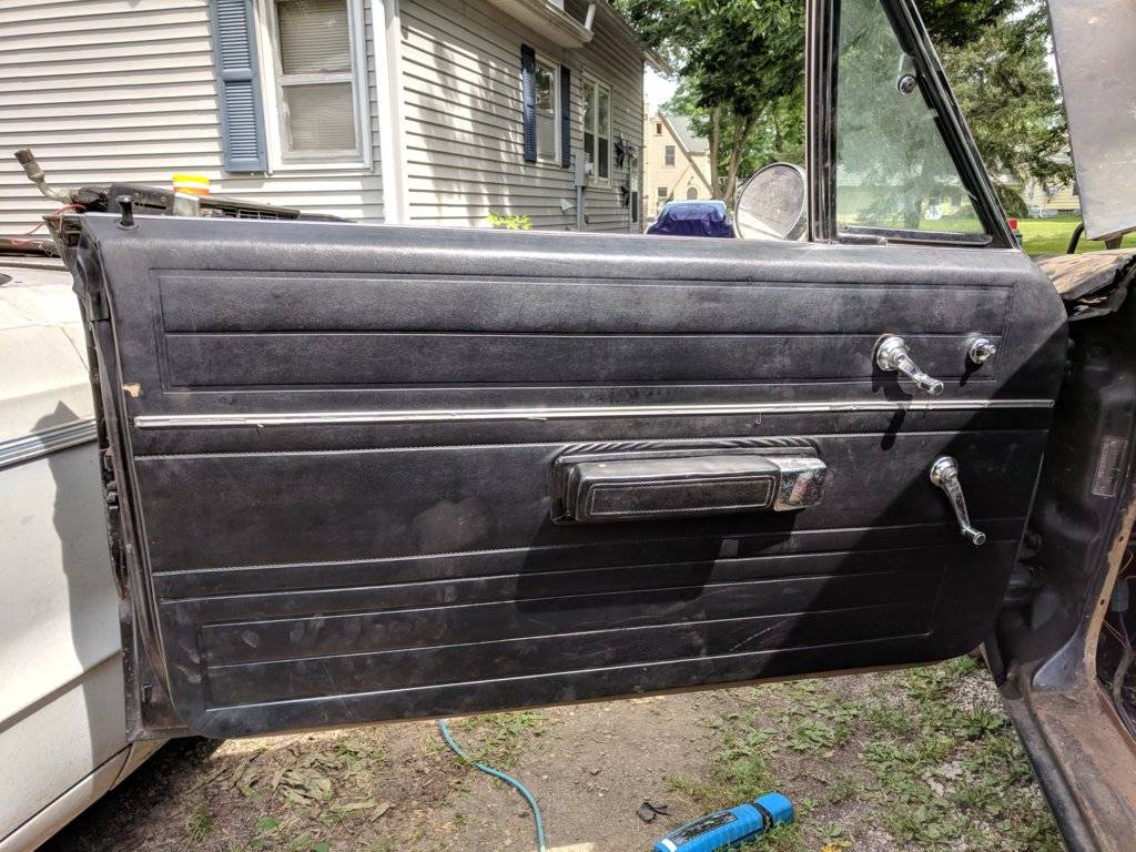

I didn't do much as I found other under dash wiring that needs correcting, so I replaced a door panel with a better one.
I was just making room for myself, speaker wires were hanging in my way, so I decided to take out the speakers as well as the wire. Didn't look right having a big hole in the panel, so I grabbed the old ones off the gray car and put the driver's on, passengers side ready to go for morning, then back to wiring. But yeah, squirrel.
