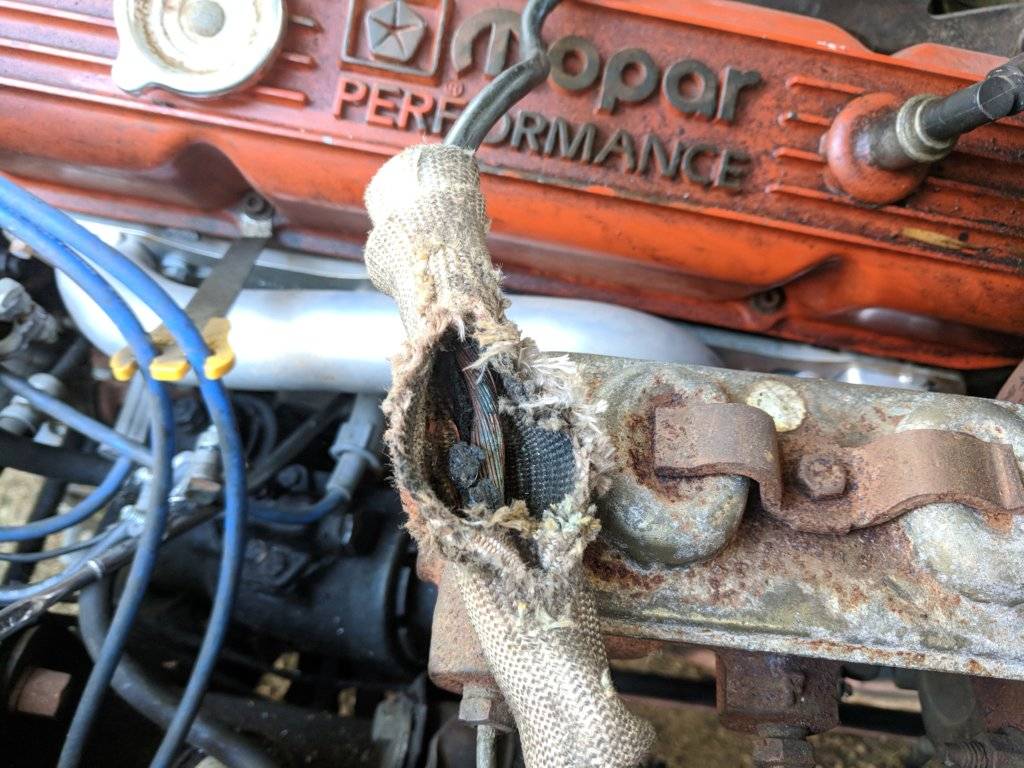

Stupidty update:
Problem found.
Wires were good shortly before, I had moved them away from the header and they must have fell back against it. New cables routed completely out of heats way, new starter also, cranks at key now. Always something simple.
