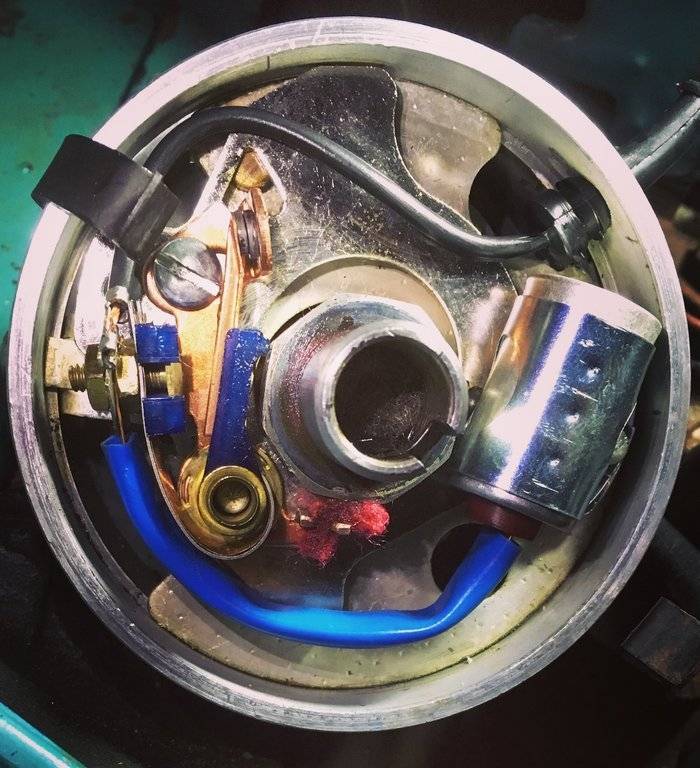

Point gap doesn't look right. Should be open about twice as much.
It's right.. if you look closely in this pic it hasn't yet traveled up on the lobe.. still sitting flat.. it opens to .017. I set it when it was up on the lobe and open at its widest.
