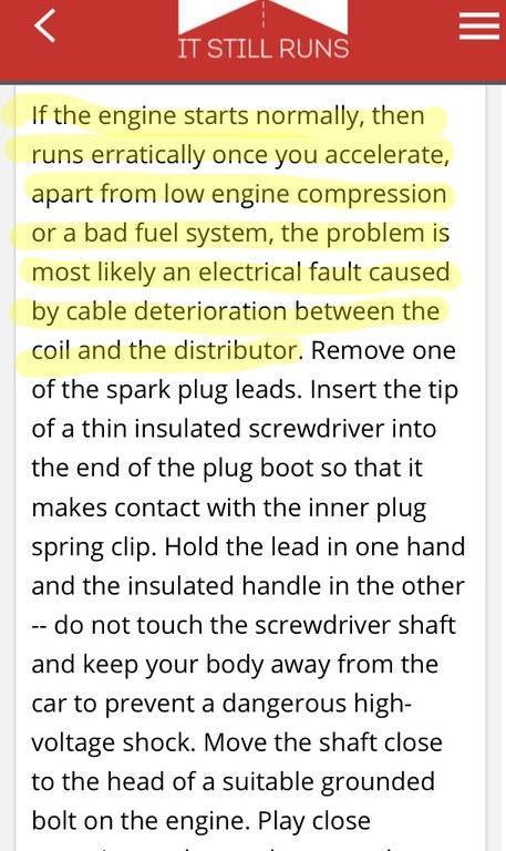

Here's where I'm at right this second. Impatient & frustrated yes. Stupid and willing to make hasty decisions? No. Willing and able, determined, motivated and proactive? YES.
Save an internal problem of low compression, or some little electrical wiring bugger at the coil.. we've essentially eliminated everything but the carburetor. I can do one of three things to troubleshoot that.
