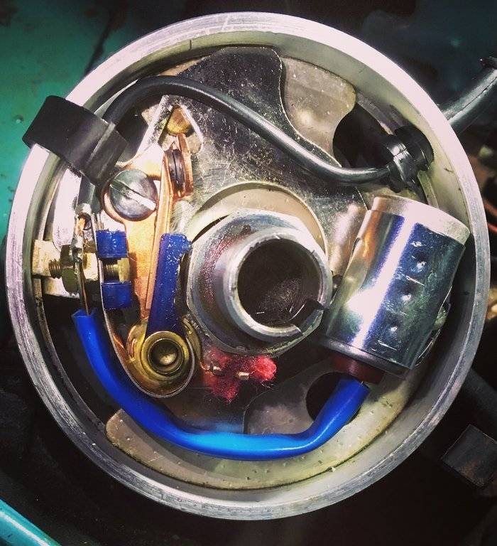

Thank you. I had done all that after I uncrossed wires 6 & 7, and this little action revealed it was perfect as it came from the factory, even timing, remarkable. When I found TDC, the rotor automatically pointed to number one on the tower, points gap good, dwell good, put timing light on her and rpms were at 600.. so without touching the distributor yet, I raised rpms to 2000 by moving the throttle arm linkage for a couple of seconds.. and the gun display came to life.. degrees went up to over 30 on the gun at 2000 rpms, then when I let off the throttle the display showed 12.8 degrees at idle at around 675-700 rpms, which is what I was looking for. I don't know how that happened without touching/turning the distributor.. It seemed to be all to spec without any adjustments.. then I played with distributor/timing just a little bit to slightly affect idle speed and it dropped down to 450rpms and I got lost from there, trying to raise rpms solely through turning the distributor.. to no effect.. Sorry to repeat myself, I just want to go over what I did so I prevent it from happening again when I get everything "lined up". The car starts right up now, but rpms are so low at about 450 to the point of stalling out.. so my question is why go to TDC, How will that help?
Thank you. I had done all that after I uncrossed wires 6 & 7, and this little action revealed it was perfect as it came from the factory, even timing, remarkable. Found TDC, rotor to number one, point gap, dwell, timing and rpms.. It was all to spec without any adjustments.. then I played with distributor timing just a little bit to slightly affect idle speed. Sorry to repeat myself, I just want to go over what I did so I prevent it from happening again when I get everything "lined up". The car starts right up now, but rpms are so low at about 450 to the point of stalling out.. so my question is why go to TDC, How will that help?
Sounds like you just need to adjust the idle speed by turning the idle adjusting screw on the carburetor. Advancing the timing (turning the distributor clockwise) will also tend to increase idle speed, but since you say the timing is spot on, I would just adjust the idle as described above.
The timing WAS spot on(sorry, I just edited my last reply while you were writing this one).. until I played with it.. perhaps reread to see if you can make sense of it.. i surely can't!
I was also told that turning the distributor CCW is what advances the timing... either way it does nothing now. It was also strongly suggested by Bill/traintech and others that I do not touch the carburetor screws until I have timing dead on perfect.. I am very confused by all of this.
Just try and move the distributor back to approximately where it was, fire it up, and adjust the idle speed (if necessary) at the carburetor. Then you can further adjust the timing (if necessary). If the resultant idle speed increases too much from the timing adjustment, back it off at the carburetor.
I do agree that I am not far from getting back on track.. I just need to understand how⚡⚡⚡
Please note that when I talk about adjusting the idle speed at the carburetor, I am NOT talking about the two little idle mixture screws. I'm talking about the big idle adjustment screw in the carburetor linkage. Also, note that the distributor rotor rotates in a counter-clockwise direction; therefore to advance timing, you must move the distributor in a clockwise direction.
Yer getting there. . . Just be patient with yourself, and don't give up.
