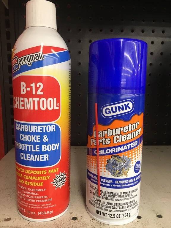

Wait, is this carb cleaner any good?

Any experience with either of these products for getting all the parts moving again on a 30 year old carb thats been sitting?
Or should I just soak it in milk overnight, with my chicken livers in the fridge?
never used either one. i'm strictly a cyclo guy. bottom line is if it says "extremely flammable" on the can, you're probably good. the more harmful the chemicals, the better. if you're not going to open the carb. up first, be aware that the needles could be stuck open which would allow raw gas to pump out through the vents. this is how an engine fire can happen. be prepared to shut it down quick if it should start. again, please be careful.
