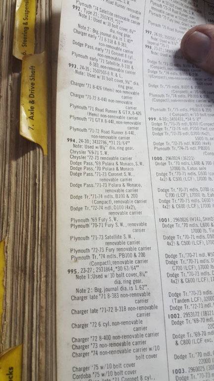

So i wanna thank everyone for there help with my sure grip issue. I took my axles out and measured them and yup someone switched them out. I got lucky and went to a yard the guy had a parts book looked everything up and found out what wagons and trucks and vans i could use. A buddy had just got a 73 van for parts and it had my axles so i put them in tonight and everything works like it should now and i did check for metal before putting it back together.

I got lucky with the guy that runs the junk yard he pulled out his book and let me take a picture of what i needed to look for.
